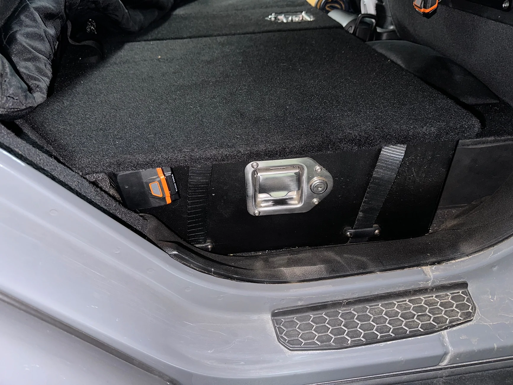

Is keeping the rear seat a priority?
If not Cargo Dog Secuity boxes are my first choice
i have U.S. Cargo Control straps running under these boxes so I can strap more stuff over the top if it was ever needed

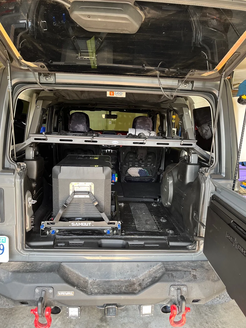

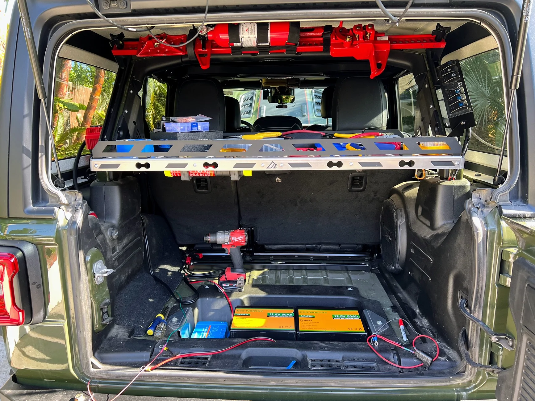

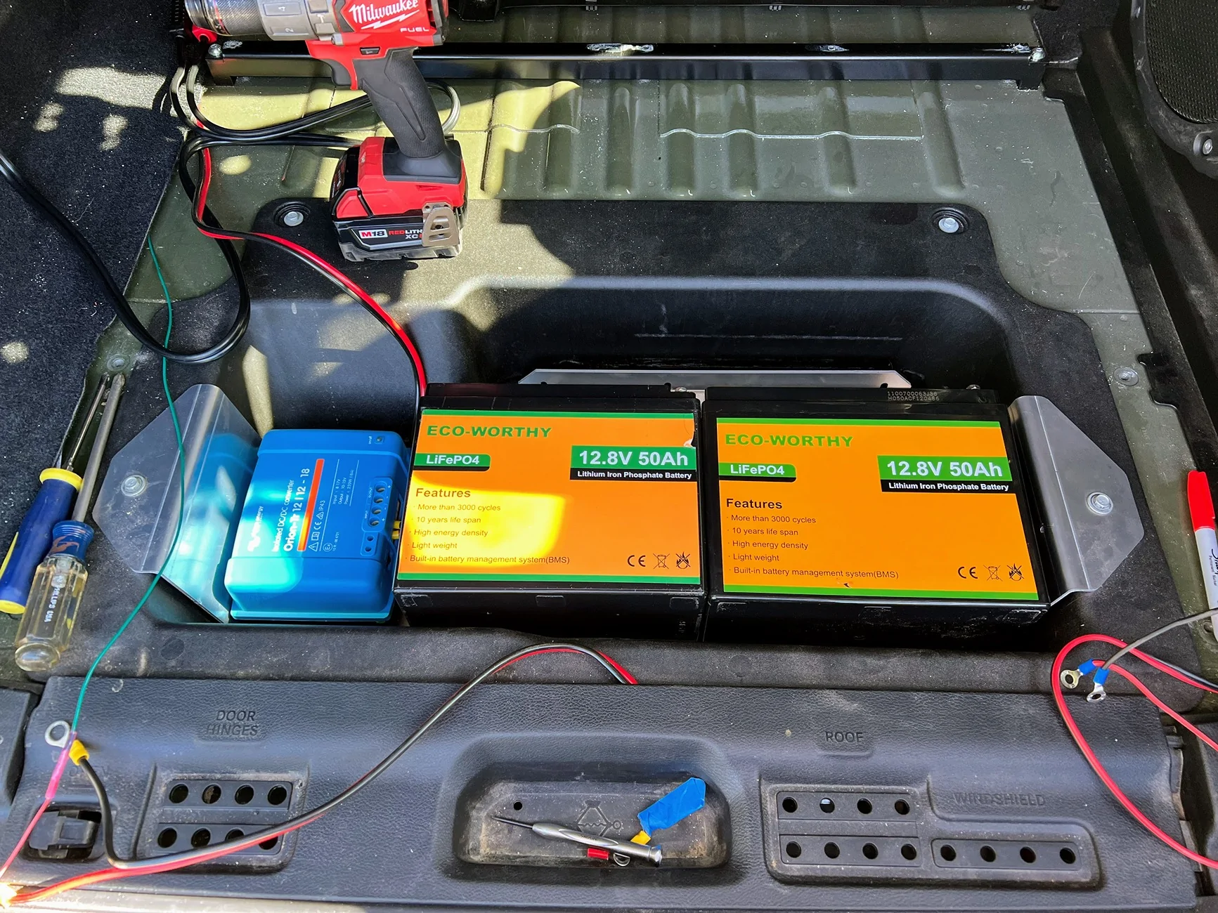

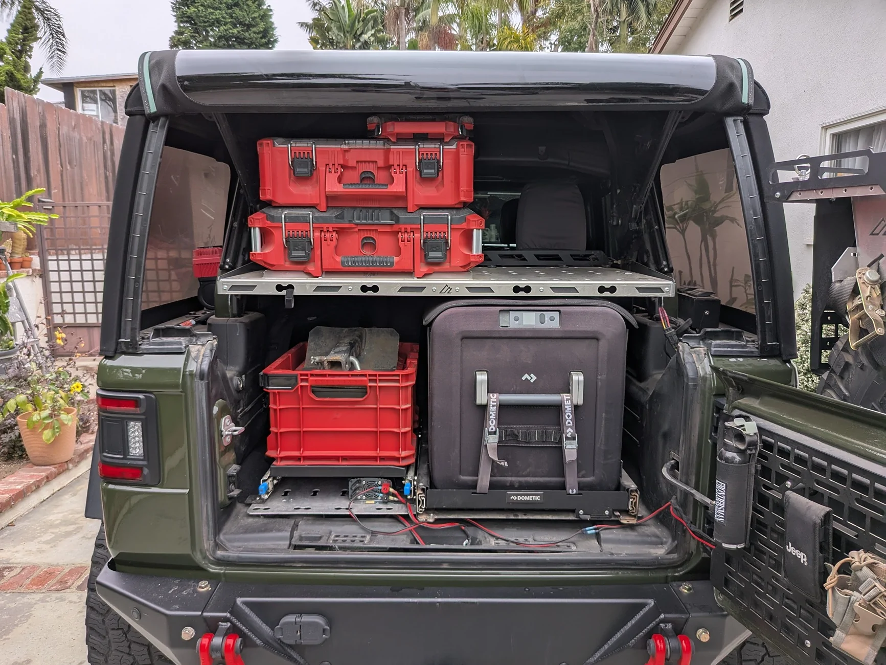

Thanks @SadRobot. I have the AAL shelf and platform. I put 100Ah of LiFePO4 batteries under the platform and use that to run my fridge and accessories. It gets charged by a DC-DC charger and a small solar panel on the hood.

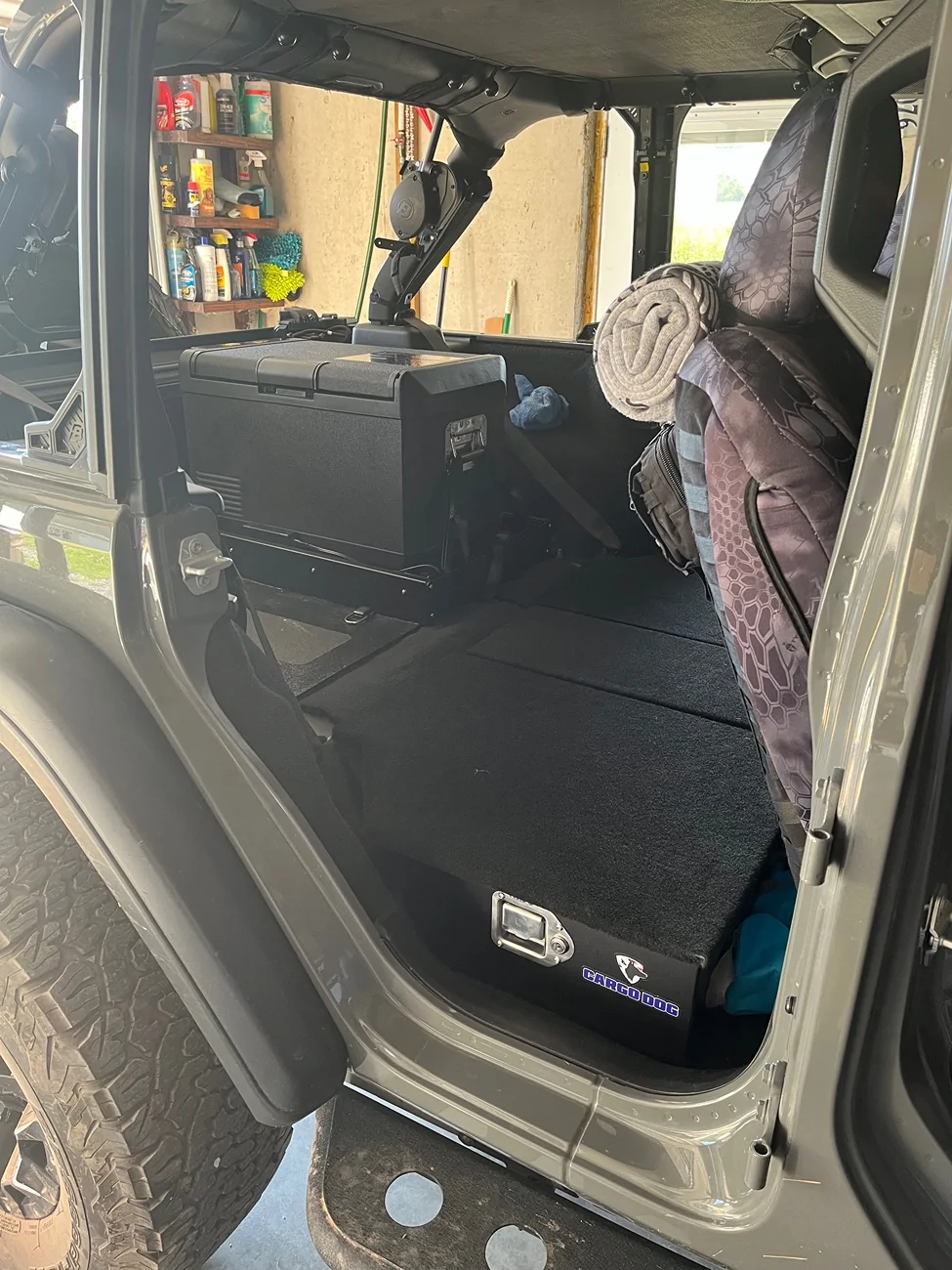

I agree,if back seat is out of the equation,Cargo Dog is an excellent choice quality and lockable storage

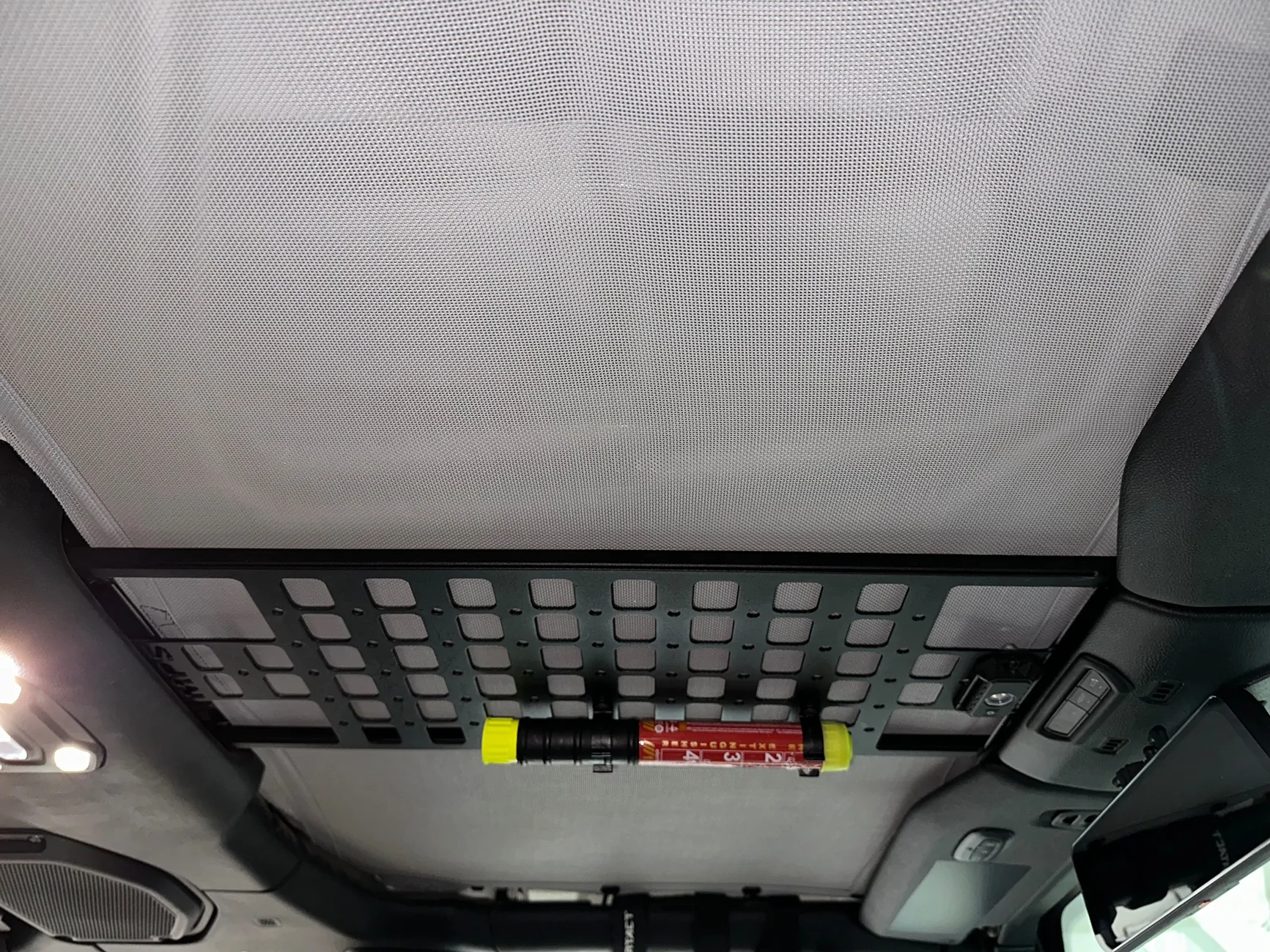

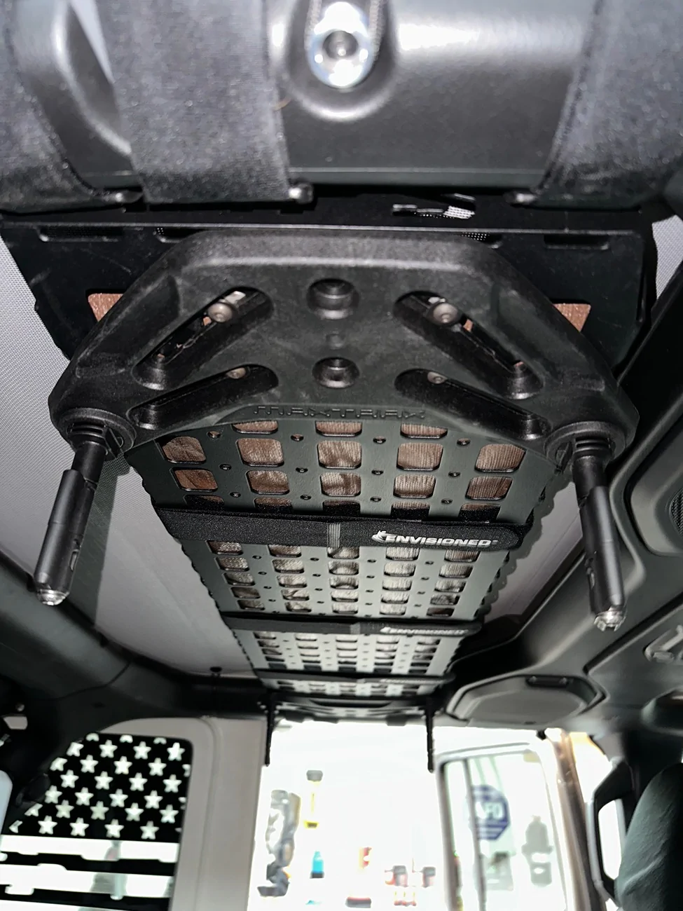

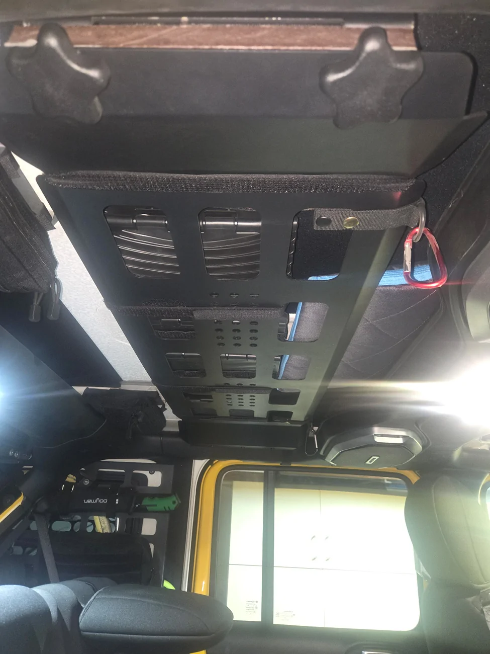

Forgot about this one.
Molle panel with hinges at one end and knobs to release and drop down.
All gear is on top of panel.
Can you provide more info on this ceiling molle panel, as well the the storage box mounted on the rear diagonal roll bars, that sits next to the the ceiling?
Manufacturer? Purchase source?

https://morryde.com/products/overhead-storage-lock-box/
https://www.ebay.com/itm/385270809313
https://www.ebay.com/itm/2658763534...8nA6LsLD_ACXXFDqpIK7a93E8l0dPQLzFUdTCfmV6cNcU
https://www.amazon.com/Installation...1757960502&sprefix=1/4+ri,aps,199&sr=8-3&th=1
Both where modified to meet my needs.
On the Morryde I had to weld reinforcements in the upper hinges as one broke about a year after installation
I removed the jeep top so I could put expanding riv nuts.
