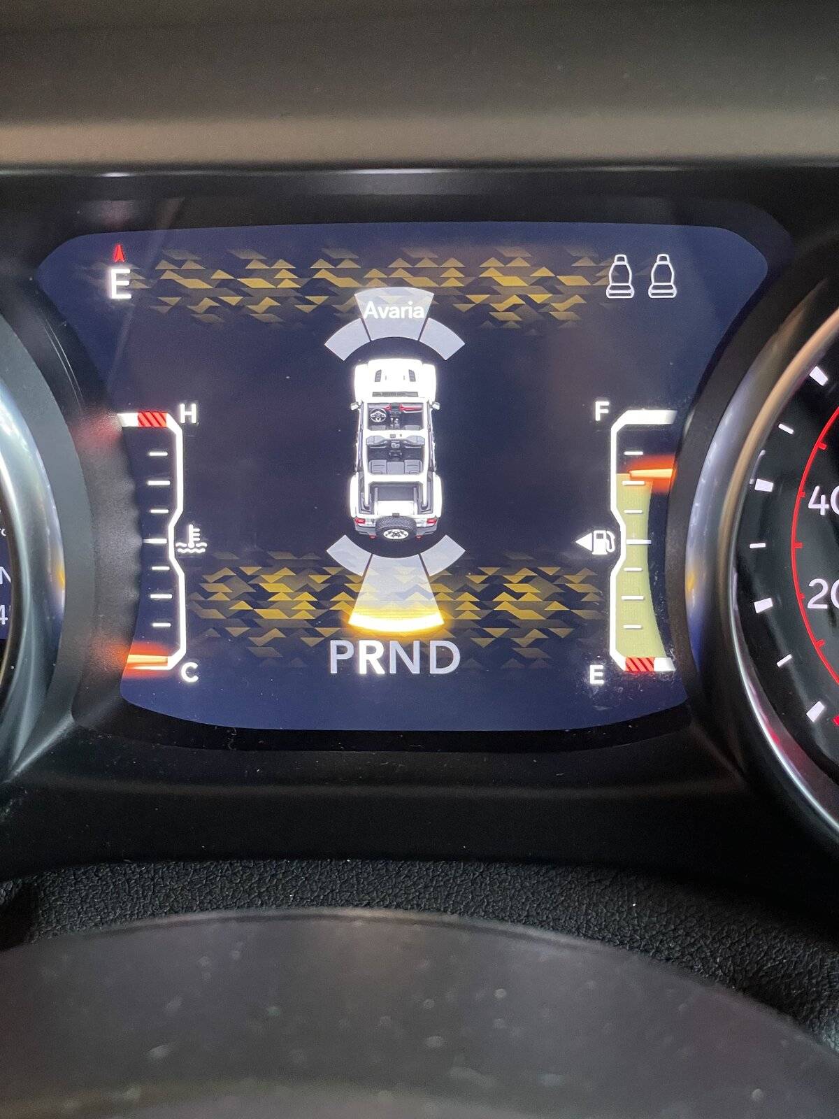

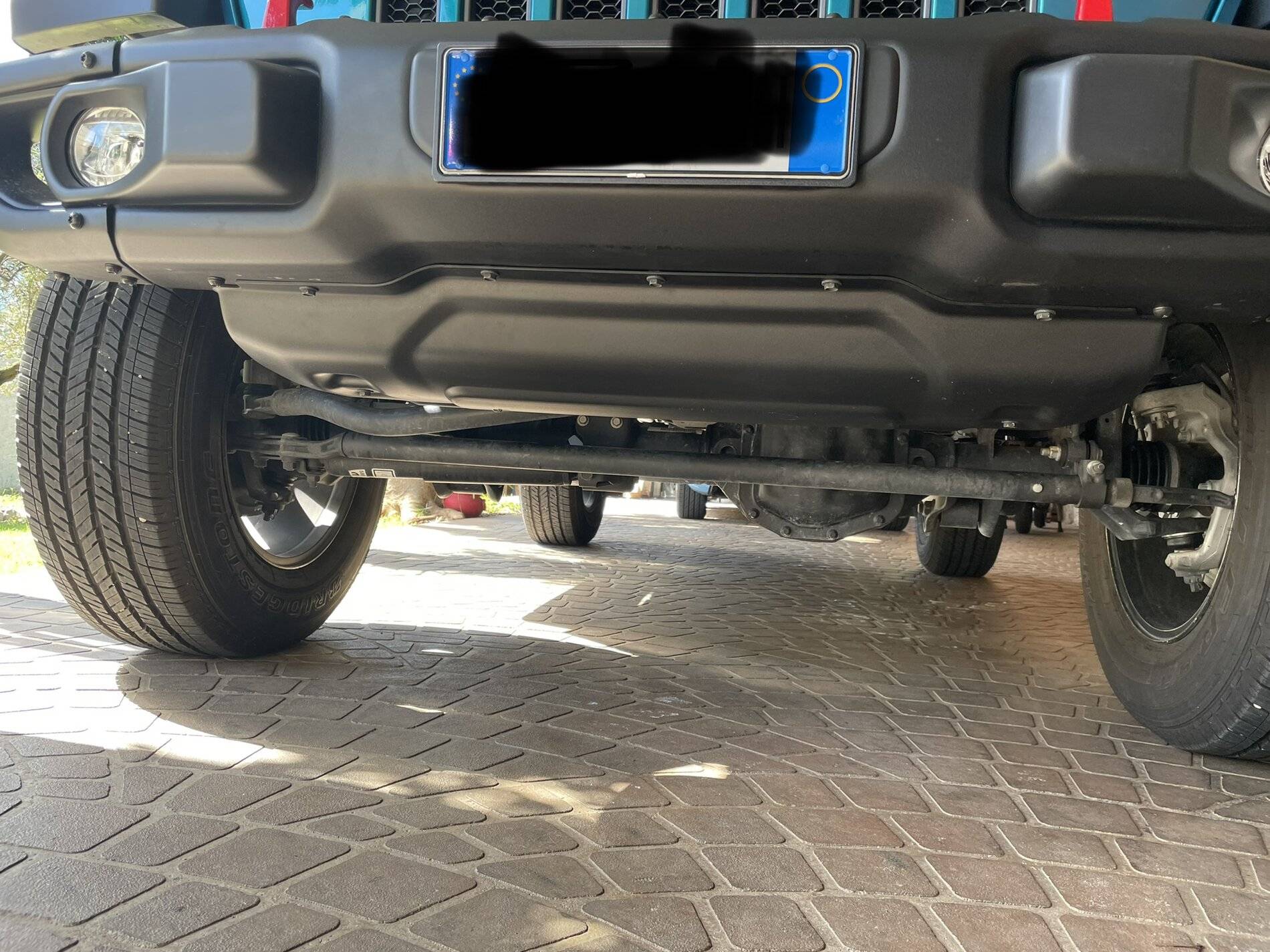

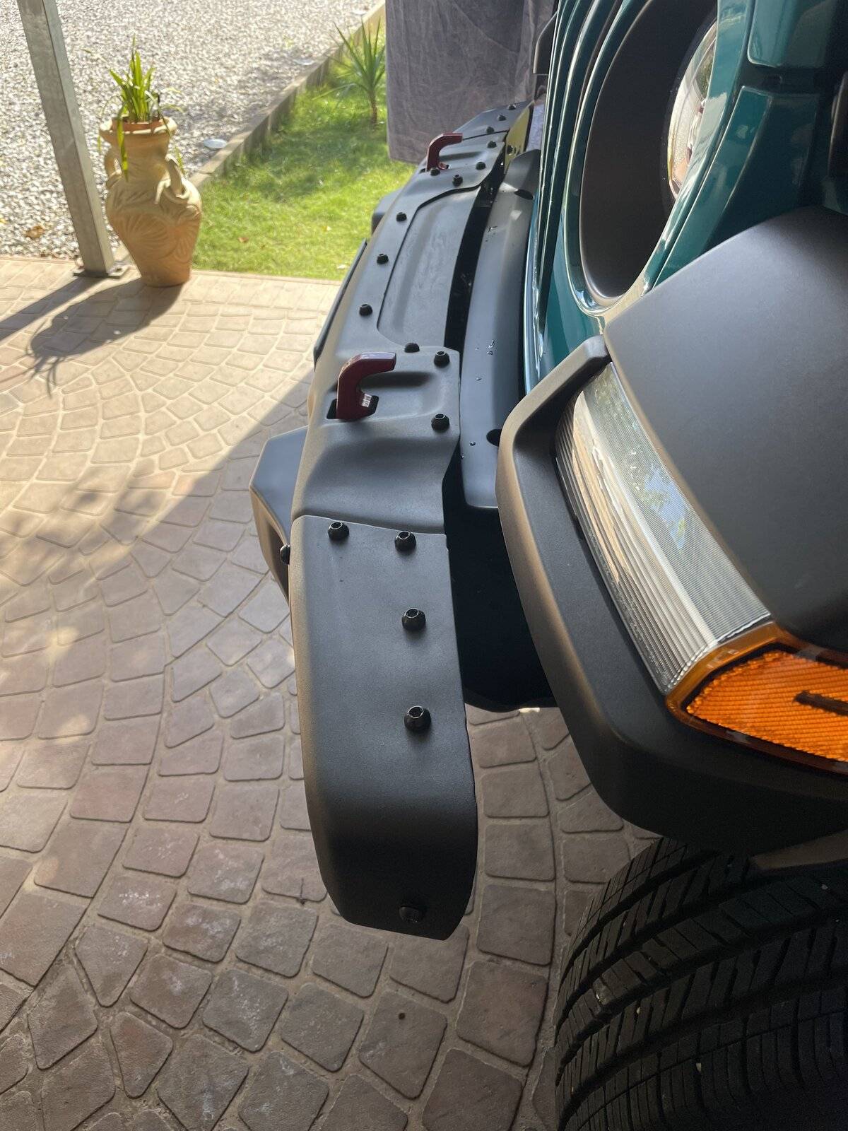

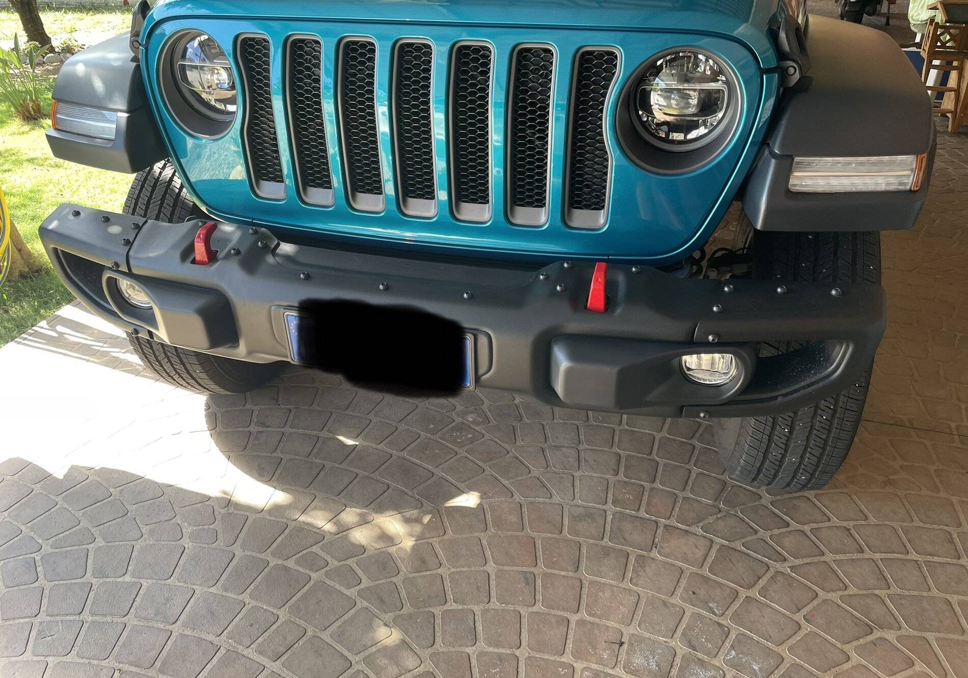

I do an update for those interested, I mounted the bumper without the sensors, the result is excellent, also at the expense of what I could think, the only "light" on, is the small "failure" written on the range of action of the front sensors of the image of the car on the small screen on the steering wheel when reversing, therefore nothing invasive, sorry for the English

Hi nicoleroi, what did you do with the wiring loom? I’m installing a steel rubicon bumper but the connector with the new bumper does not marry up to the existing connector on the body? Obviously because it has extra provision for parking sensors.
nicoleroi
Nico
Sep 11, 2021
Italy
Jeep Wrangler jl Rubi 1941 Edition bikini blue
Hi, We had to transfer the entire wiring of the previous bumper to the new one, because it is not compatible
