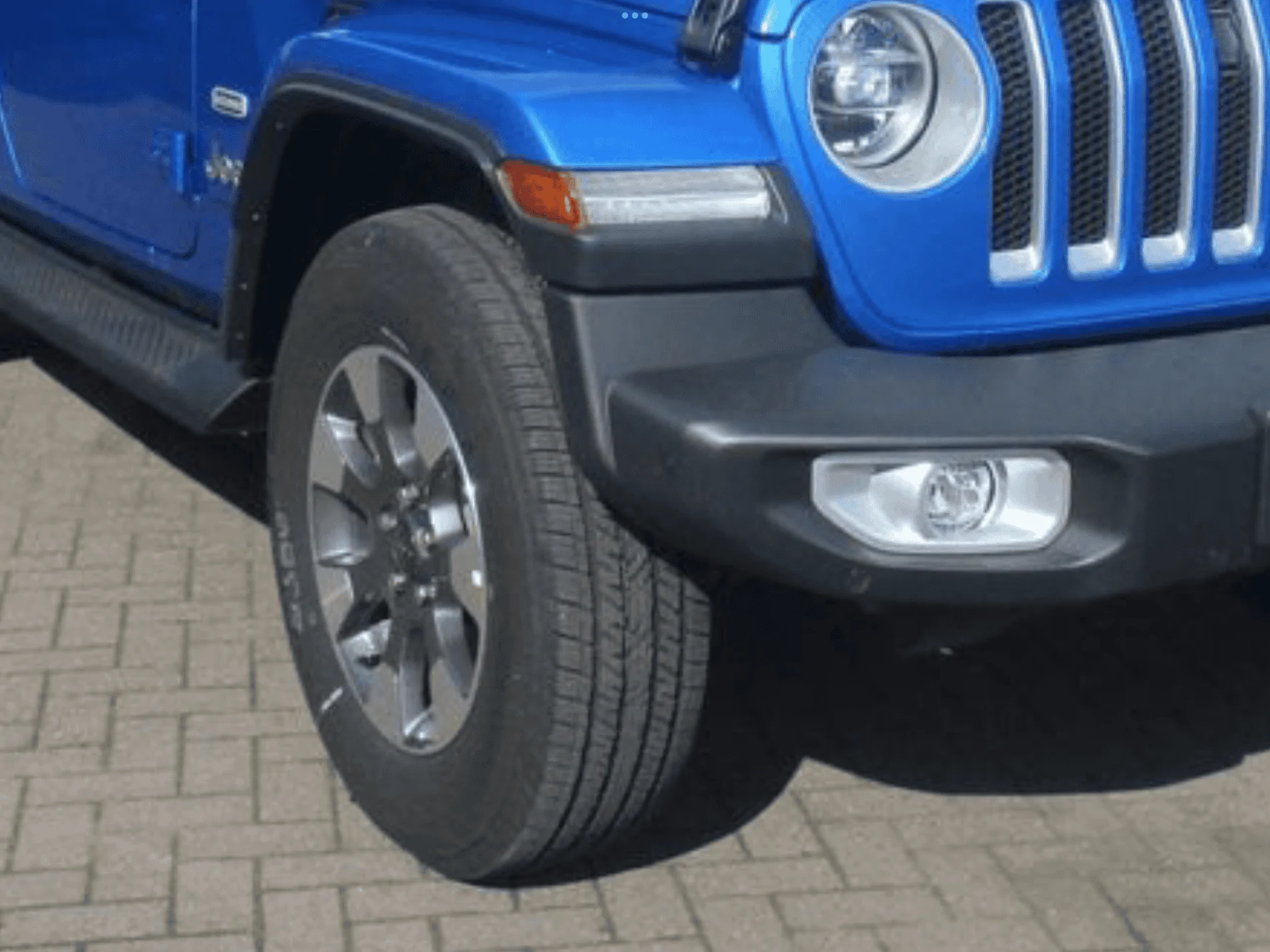

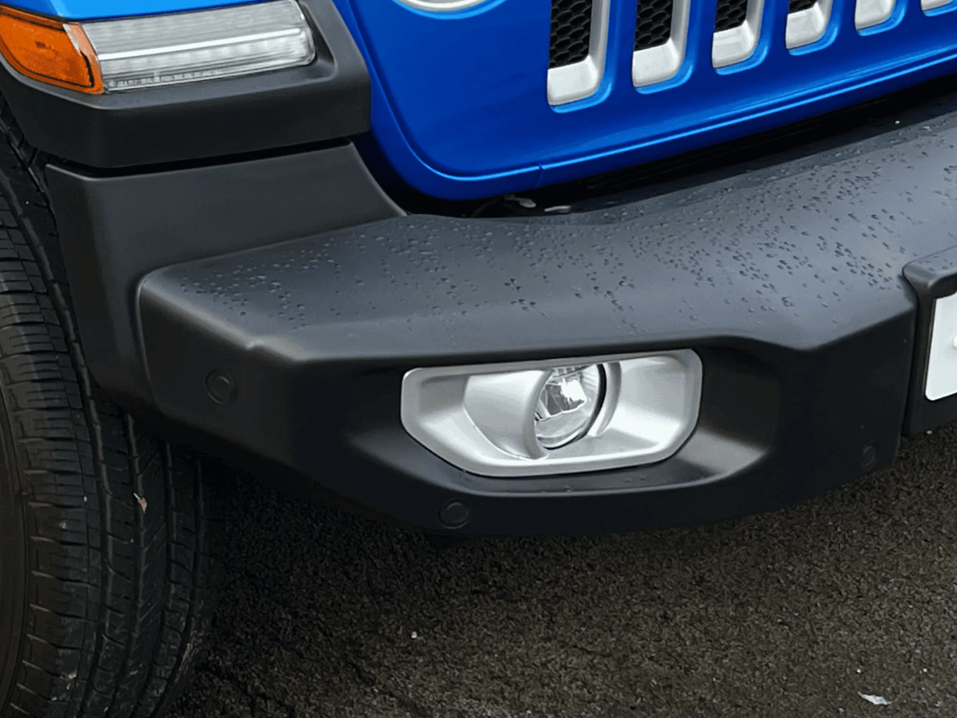

Hi everyone,
Has anyone removed the fog light bezel before?
Any idea how it's attached?
I've watched a few YouTube videos but the front bumpers and bezels on the American models look quite different from mine ?

I'm not 100% sure as I've replaced my stock plastic bumpers with US steel bumpers from the very beginning, but if I'm not mistaken you have to remove the side caps first, and then you'll get access to the bezel mounts from inside of the bumper.

I removed the splash guard and various plastic trims from the back of the bumper and even went as far as removing the actual fog lamp itself, but even then I didn't seem to have enough room to see what was holding it in.
With the lamp out I was able to put my fingers in hole from the front and pull hard. Really hard. It's only clipped, not bolted.
It came out eventually, but the clip on one side broke ?

Too bad, sorry to hear that . But I think you can find these bezels from other people in the UK as many have replaced stock bumpers - try asking here - there are a lot of British people in Europe section.
