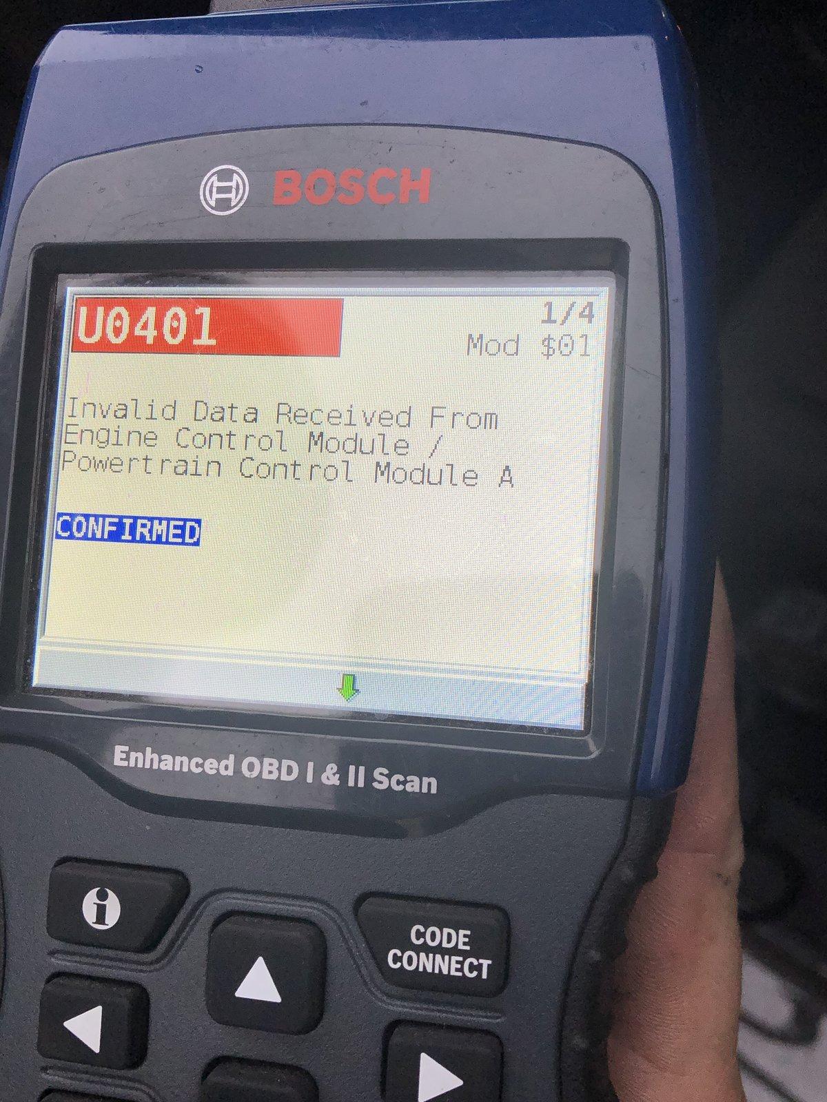

Called out an ESC Warning. That could or not be due to lift. Not, 100 percent sure. I am at 5k on mile and had the lift install around 500 miles.

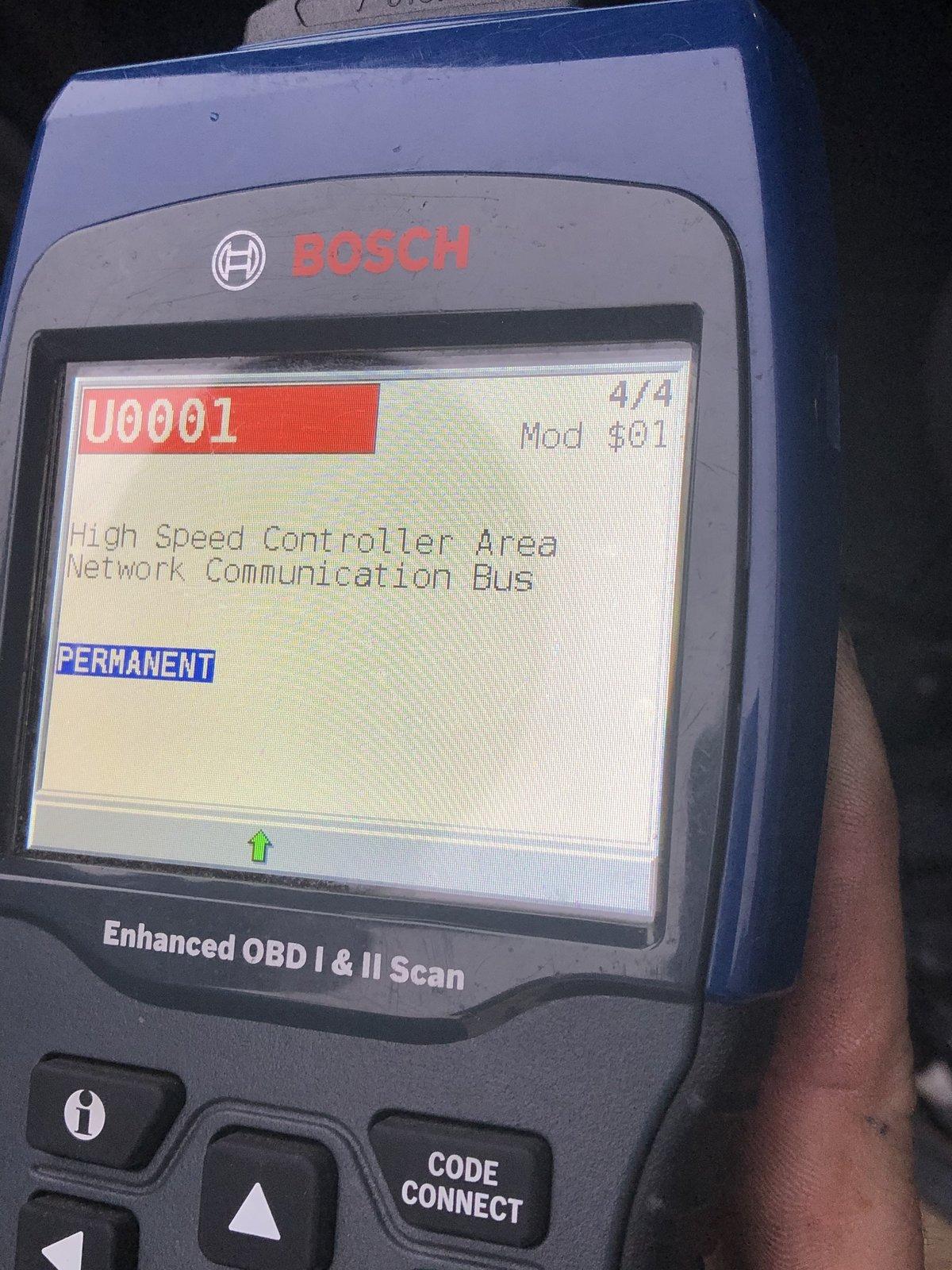

This is what is being called out.
Sounds like the wiring harness issues we've had on our modified Rubis. Full extension and articulation cause the harnesses to short. When you installed the lift, you needed to clip the harnesses to allow more droop. If you installed the Mopar lift (sounds like you went aftermarket), it would be warrantied. If not, then it won't be covered. A good 50% of our fleet has had this issue.
