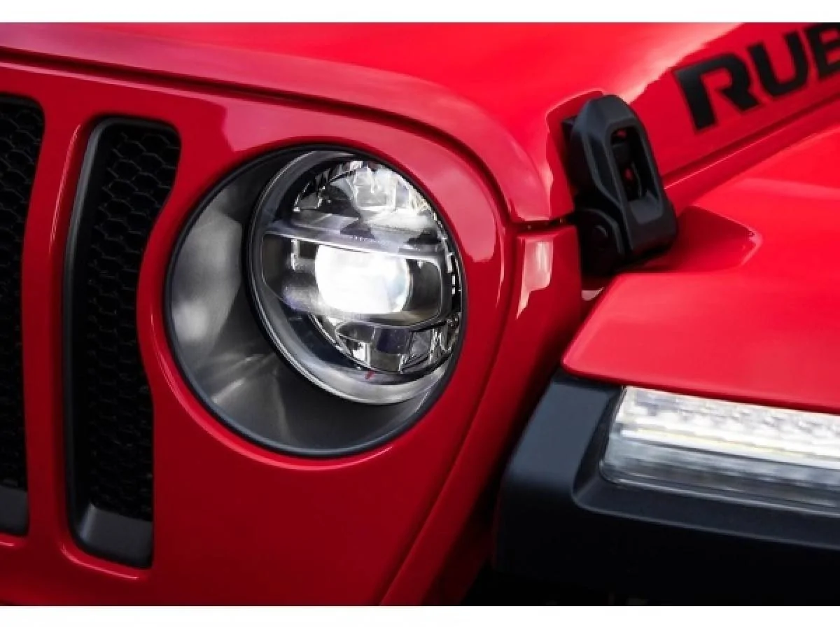

So I have a 22 sport s coming next week. I want to put the factory led headlights on.
I heard the 18-20s needed to run a wire though the firewall for halos to work. Someone said the 21-22 wranglers dont need to run the wires for the halos and are strictly plug and play. Is that true? Thank you guys!!!!

Hey Mike, believe that is correct however you will need a programmer or have dealer add the code to allow LEDs and activate the halos.

Ok, i knew about the dealer adding the code for halos to work. Thanks man
No problem. If you are going to do other things you may want to investigate a JScan or Tazer Mini. Will save you time and dealing with the dealer

I can attest that 2018-20 JLs need a separate wiring for the halos. I’ve read that 2021+ JLs don’t need the extra wiring.
