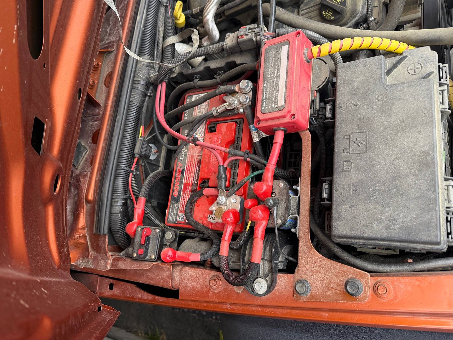

My JLs don’t have many accessories but my jk got crowded with two winches, air compressor and other accessories. I added a bus bar for the winches and compressor leads because those items I wanted disconnected by a shut off solenoid. I have had no problems with the bus bar during a few high load pulls with the winches. Another option that might work for you are multi port battery terminals. I added moroso terminals to my jk as well and they give you more options to make connections.
The bus bar I used says it’s rated for 300 amps but the bus bar itself is a pretty stout piece of metal, much thicker than the stock battery terminal connections. If the thin stamped metal factory terminals can stand up to a winch this bus bar should not be an issue.
Jeep Wrangler JL Electrical bus bar IMG_0076
This was the best option I could come up with for disconnecting three high amp draw accessories with one shut off solenoid. It’s been three years since I did this and so far no issues or regrets. Good luck with your project.

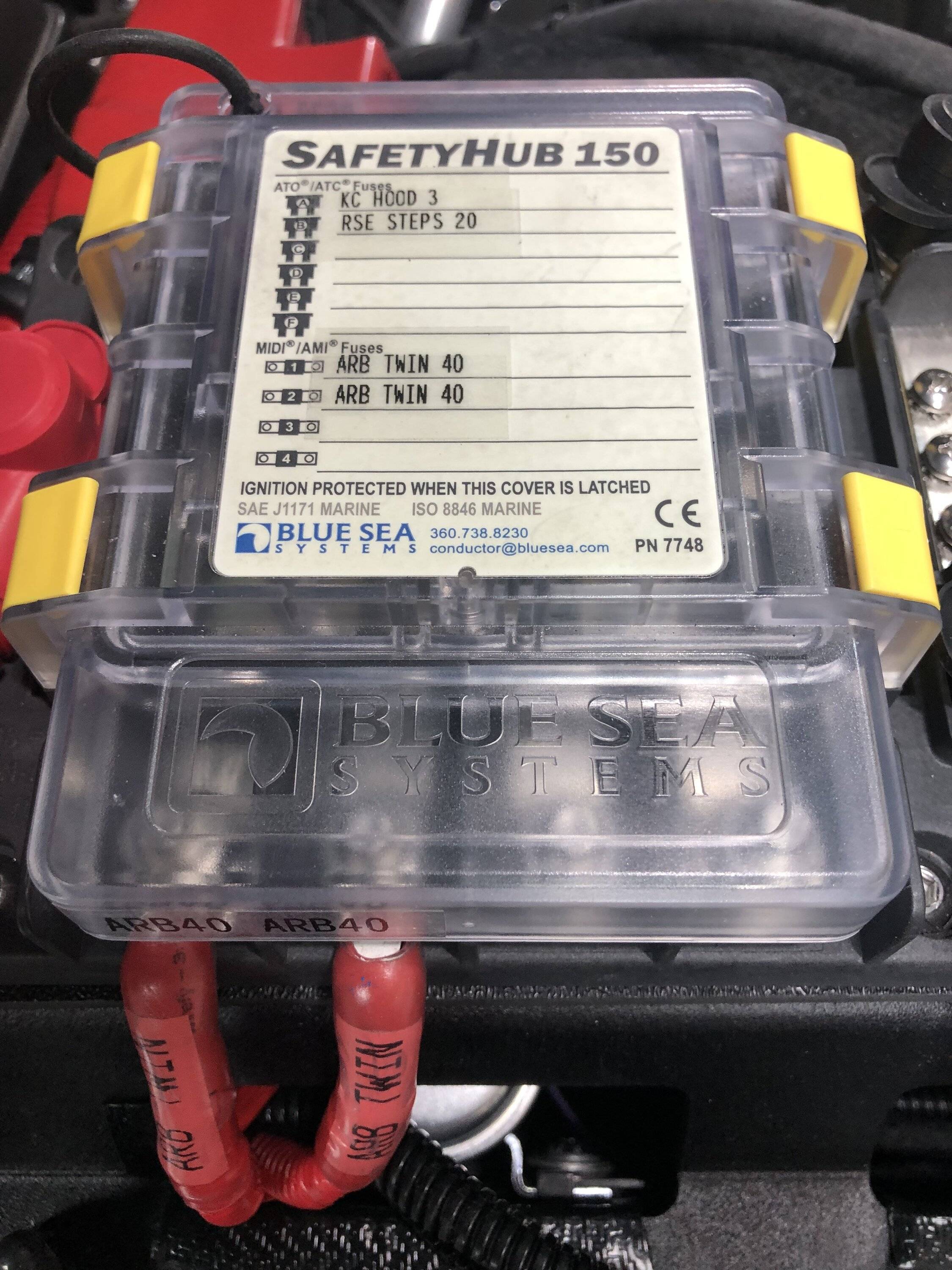

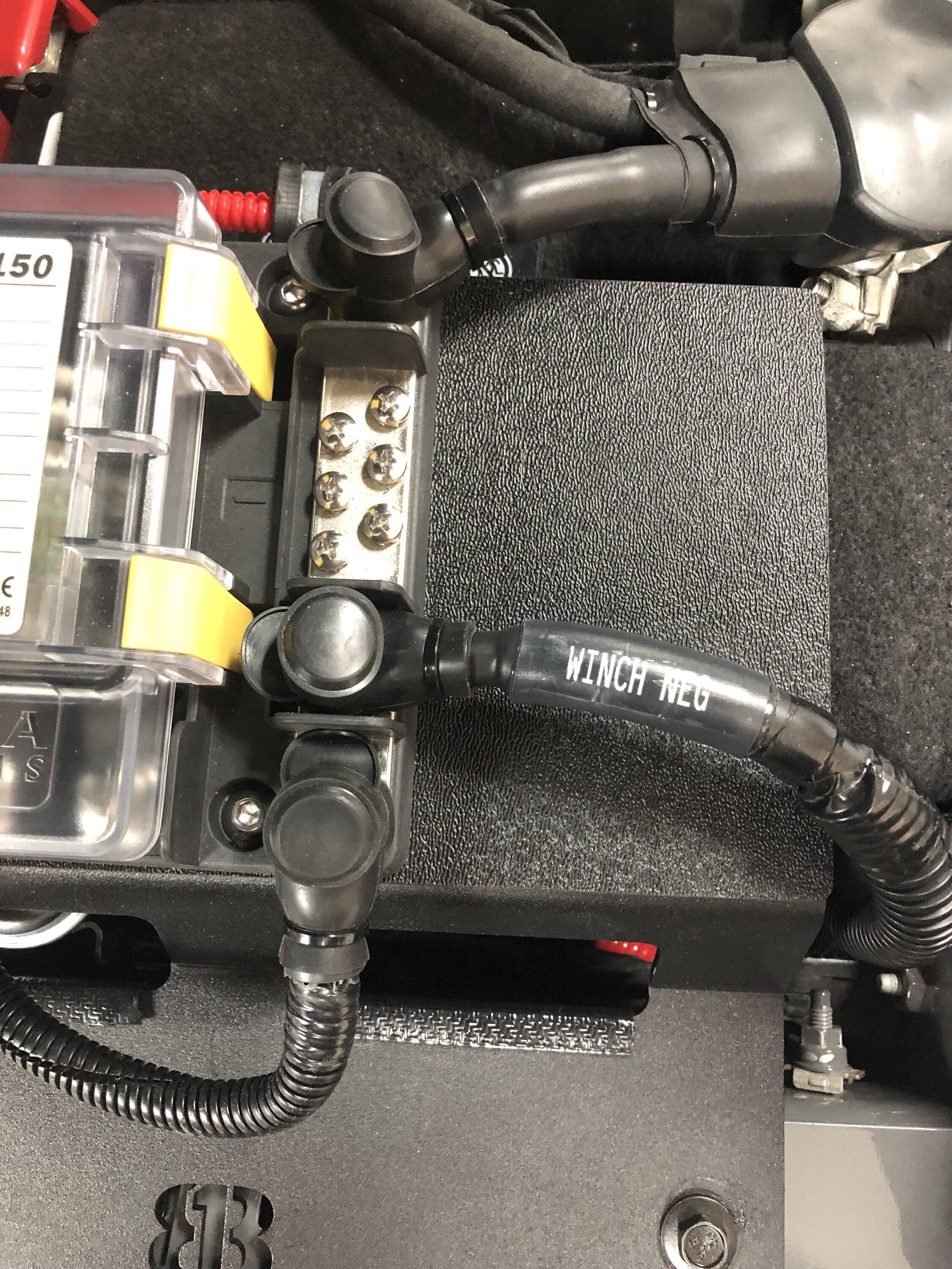

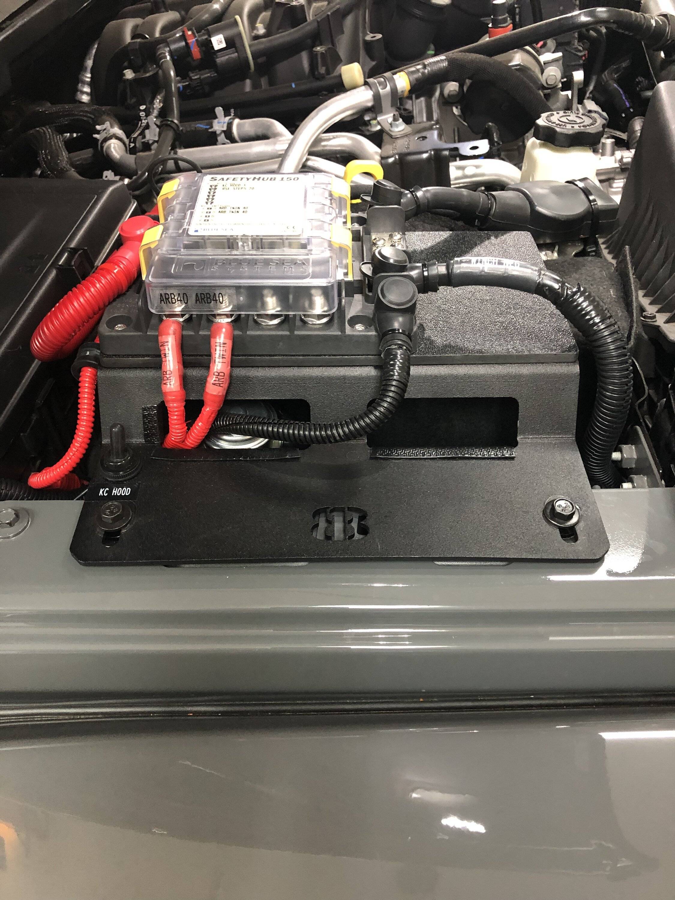

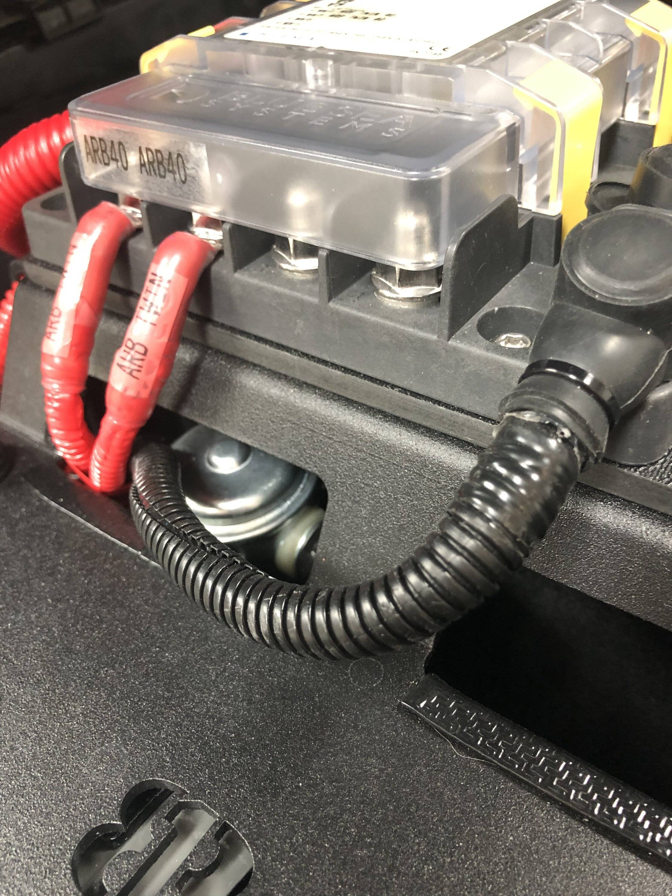

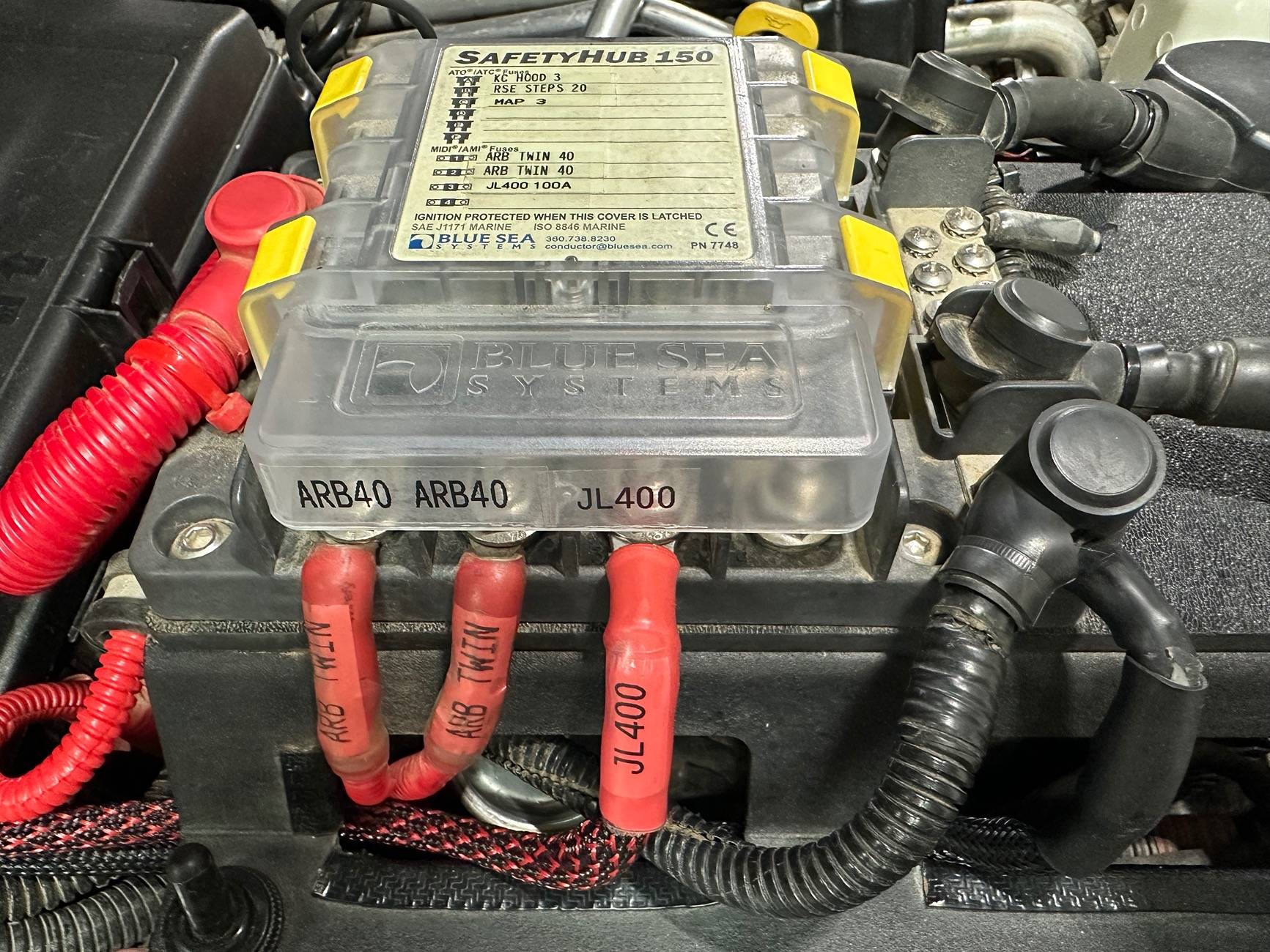

Total overkill but I already had this Blue Sea safety hub from another project
I used this bracket from 813 Fabrication https://www.813fabrication.com/product-page/underhood-electrical-accessory-plate
and modified the footprint slightly with some 1/4” ABS sheet to accept a Blue Sea Safety Hub 150
https://www.bluesea.com/products/7748/SafetyHub_150_Fuse_Block
I mounted a Warn solenoid under the 813 bracket for my Warn winch. It’s connected to Aux switch 4

Very nice. Just what i was looking for.

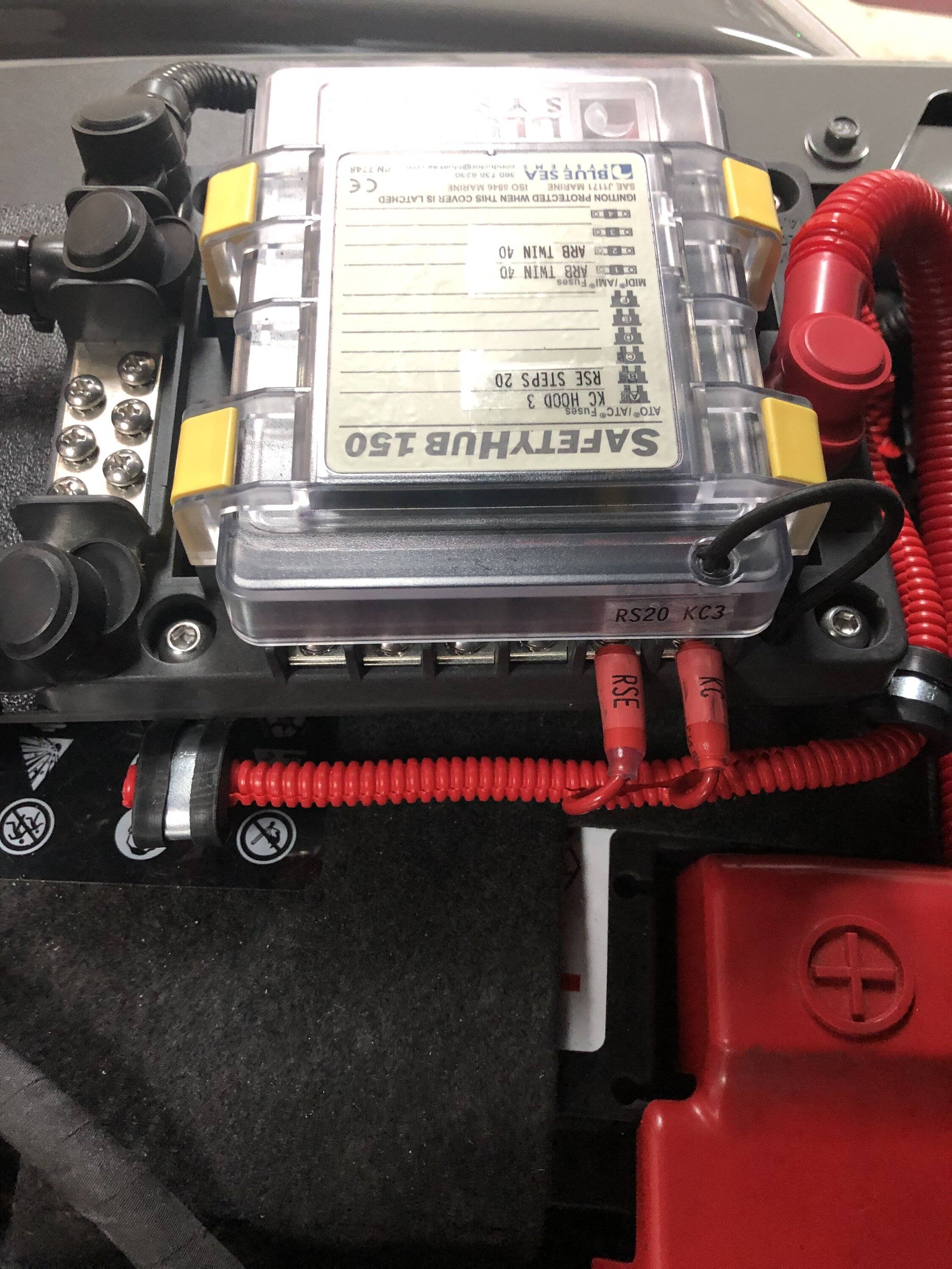

Mine is similar to Terry's with Blue Sea stuff and the 813 mount. I used a breaker for the compressor instead of fusing.
EDIT: I bussed the grounds on the bottom of the panel with a bolt setup. Chassis ground has a single run to that bolt and the other items attach there.
