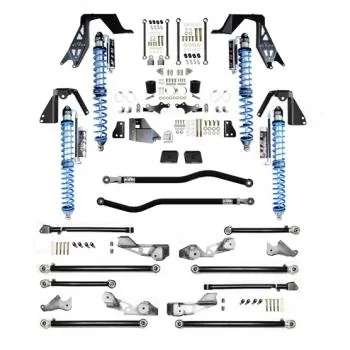

38" tires for now, after some power upgrades and gear change might go to 40"
probably going with this lift
http://evomfg.com/EVO-MFG-Products/Wrangler-JL-JLU/EVO-JL-JLU-Suspension-Kits/EVO MFG- PRO -JL-JLU -Suspension Systems?product_id=563
That’s a nice CO setup, you can get the step down without the adjustable pressure, you won’t need that. Other than that once you have that installed and all your accessories then you can look at driveshafts. However I would run the stock until they break.
