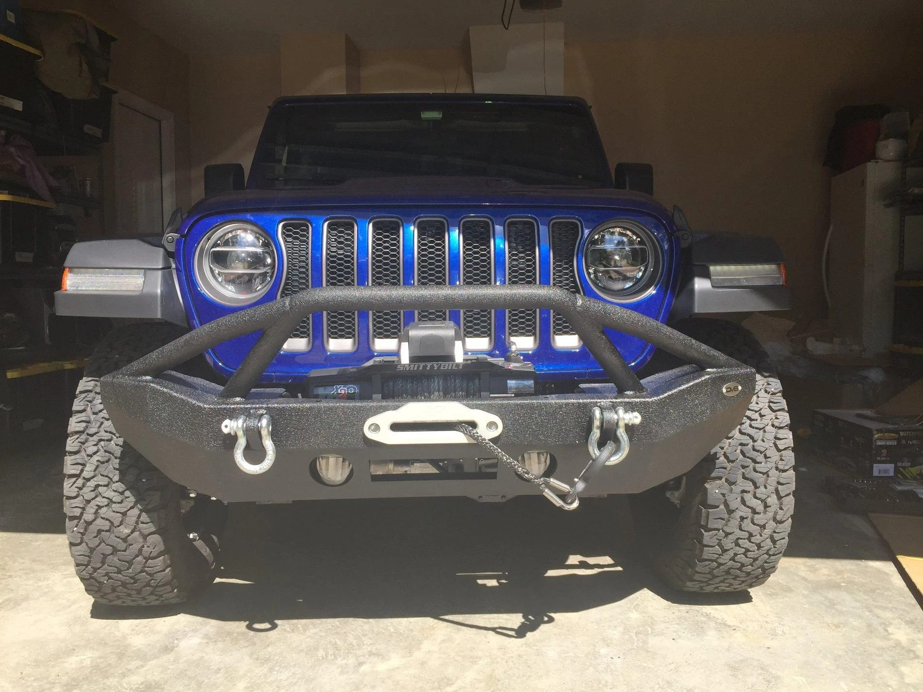

so I finally got my bumper purchased. I had decided on a DV8 FS-14; it's a JK (not JL-specific bumper) but it installed just fine.

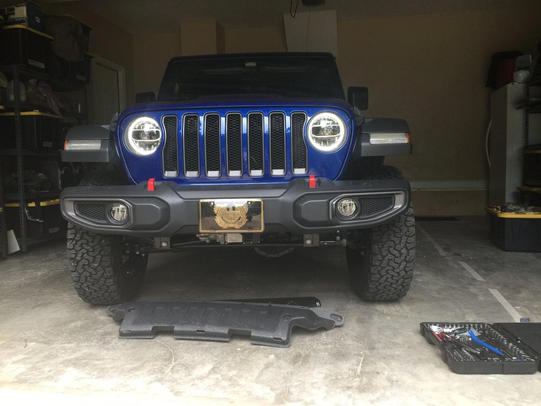

Anyway - Jeep before install. I had started taking off the bottom plastic skid plates, and the metal protector plate down there before I thought about taking a picture. Also - there is an EXCELLENT youtube video on how to remove the bumper from quadratec . I'm a computer security guy by trade, definitely not overly familiar with wrench turning - but the video explained everything and it was pretty easy.
After watching the video a couple times, the bumper came off and I opened up the boxes to begin install. The DV8 bumper came with all of the hardware needed - didn't use a single bolt I took off (comes with the nuts for re-attaching the bumper, etc).
I had mounted the winch before putting the bumper on, but for me that was a bad idea. I am a learn-as-you-go guy, and I had not wired up the controller on top of the winch - just mounted the winch. well, when it came to working the rest of the winch I wound up taking it off to attach the control box and wiring anyway. In any case - with the FS-14 there is that light bar gap (I didn't install the mesh) and that made it super-simple to get to the bolts for the winch.
Two items of note;
1. Definitely loosen the outer / inner brackets that the bumper goes through. so there are the frame holes that you can't move, and then there are these brackets with two holes (a bracket on each side of the frame bar, total of 4) that are held on by a bolt. loosening that will make it a lot easier to get the bumper to line up.
2. I DID have to "oval out" the holes in the frame mount, but not by much. I used a cordless drill and the largest bit I had, and worked inwards on each of the 8 holes on the frame mounts where the bumper studs go through. It really didn't take much - I contemplated other methods (such as hitting the frame mount with a mallet type stuff) but in the end enlarging the hole a little worked fine. the studs are just a tad closer inward than the holes (didn't measure, didn't care that much). when you hold the bumper up you can see the bolts, just off-center a little.
after widening the holes, the bumper went on pretty well. I could get to all of the bolts with standard tools, I didn't need crazy bendable ratchets or anything.

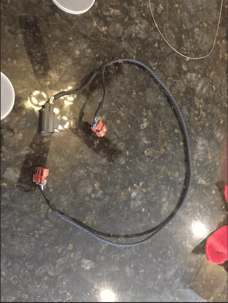

I still need to wire up the LED foglights - but I'm going to just cut the connectors off the old harness and use new wire. So need to find my soldering iron. re-using the old harness is a bad idea in my opinion - you would basically have to disassemble the entire old bumper to get it out. The LED foglights out of the pastic bumper fit almost perfectly - 3 of the 4 screws worked, which was solid enough for me
