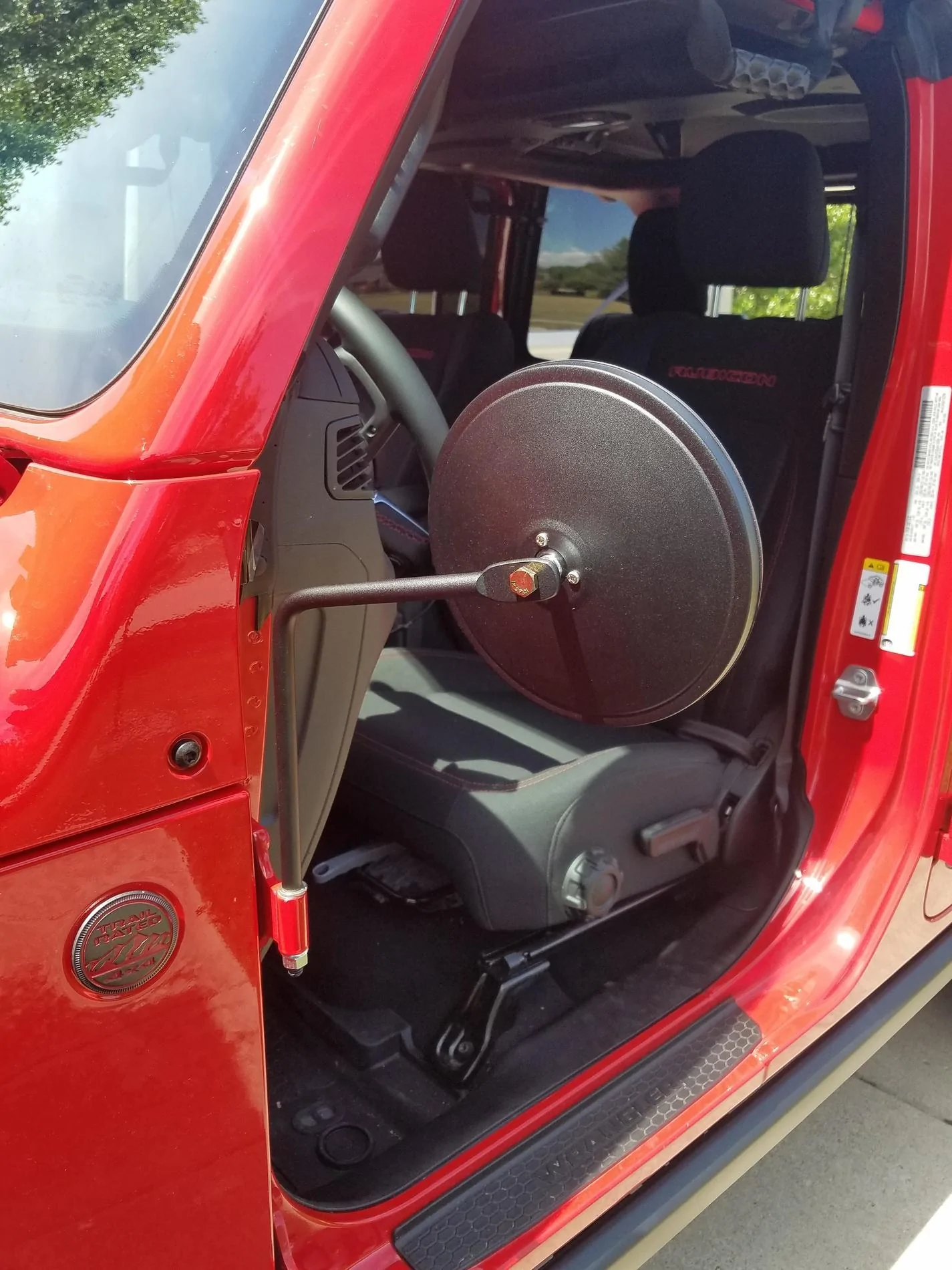

I'm getting ready to install Lange Originals L-shaped door hangers with the thick padding. I have one set and ordered three more (two 4 door Jeeps). I'll let you know how they do when I get them up later in the week. I also have Barricade mirrors from Extreme Terrain that are really nice. I went with the round mirrors and they are nice and large and don't vibrate as badly as the several sets of mirrors I've used over the years on my JK. You will want to put a washer at the top, though. It comes with a lock washer for the bottom. The top will dig into the plastic hinge liner, if you don't. Also, with a top washer, you'll be able to tighten it more and it will stay in place, even with the wind. I'd imagine the square mirrors would be huge. They work really well, though, and have a nice, high quality feel and finish.
@XTJake will fix you up with a forum member coupon code, I believe. Here is a pic...You can see the washer on the top. It is also a lock washer, which I think again, lets you lock it down tight and keep it from moving due to wind.

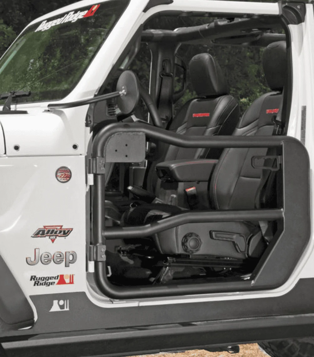

has anyone found this mirror? it was the photo for quadratec's tube doors

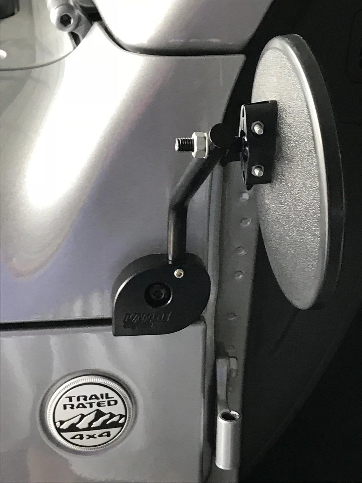

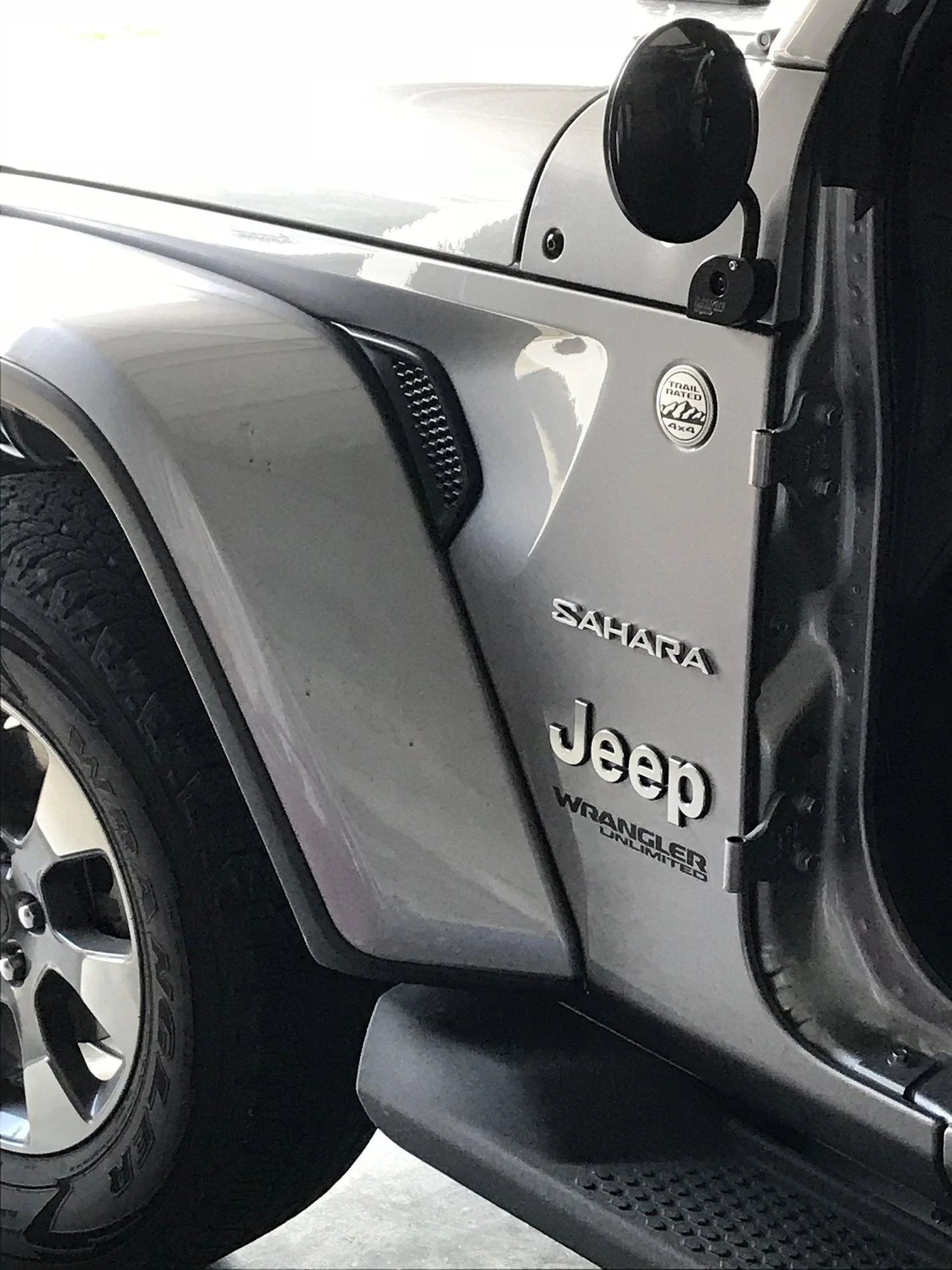

Installed the Lange Coyote Mirrors today. Worked great just driving around town. Will get out on the highway tomorrow and see how they perform

Those look really nice. Where did you find them? Most places I've looked show an option for pre order or they are listed as out of stock.

I snoozed and lost. Sold out. Does the plastic piece have any backing to protect the paint?

Where is the quick disconnect pin? Looks like it is missing.

Looking forward to more feedback, Thanks
