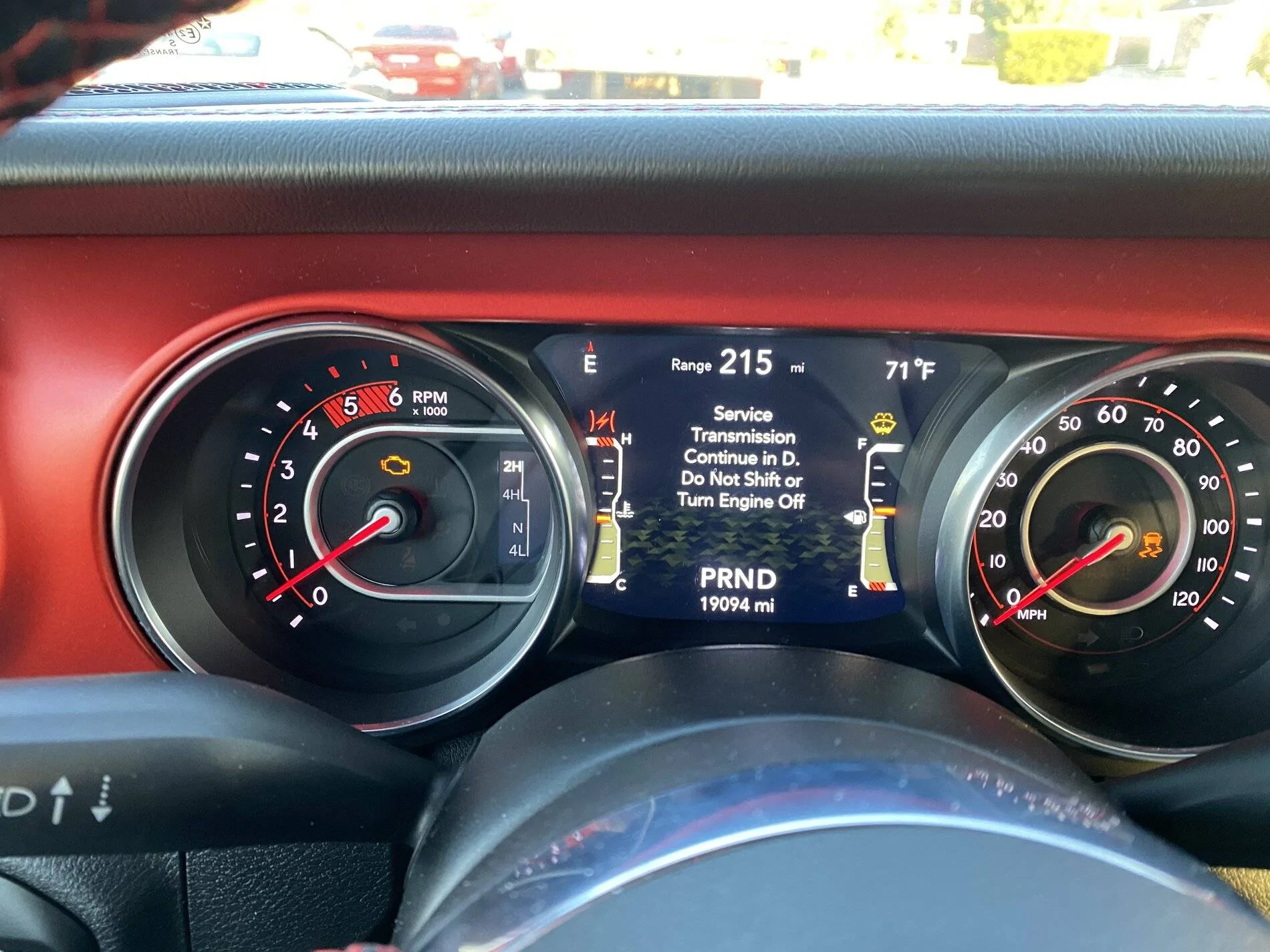

Jeep Wrangler JL Diesel/Transmission Stutter 20AE9341-5DE5-45B4-8029-7AC550CE410E
With the Engine warmed app 25miles, stopped at a light went to accelerate, 1st gear slipped pretty hard then this came up. Went into limp mode. No faster than 35mph. 19k miles trouble free???

Turned out to be a failed wiring harness near the exhaust of the engine. The fatal 3.0 diesel flaw.
