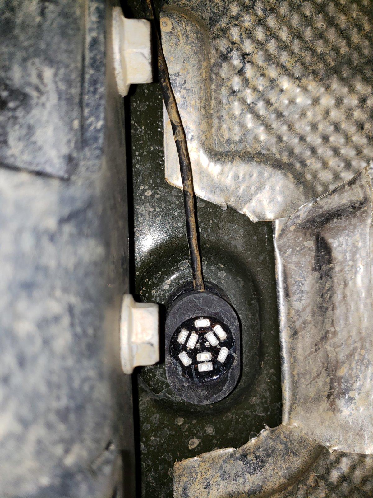

I have installed two sets of these exact lights. One set on my wifes 2019 JLU Rubicon and one set on my 2020 JLU Rubicon.
I had no problem connecting the wiring harness to the rear drain plug connection. There was plenty of harness to make the connection.
On the heat shield issue. The 2019 heat shield is different than the 2020 heat shield. The 2019 heat shield was made AROUND the drain plug, while the 2020 was made OVER the drain plug. Strange. The heat shield over the drain hole on the 2020 did not set against the drain plug, but instead was raised. I simply cut the area that covered the heat shield and installed the light.
I notified DCS about this change and sent him pictures. He indicated that he would make a change in the instructions; I guess that didn't happen.
2020 heat shield cut away.

The connecting wire from the drain plug light is very long, and there should be plenty of wire.
The harness exits the frame on the BOTTOM.
I ran the wire from the cargo drain plug light between the heat shield and the cargo tub, then over the rear axle vent tube, then over the upper spring mount, then down the side of the spring down to the bottom hole of the frame and connected the light to the harness. I zip tied the wire all along the way.
