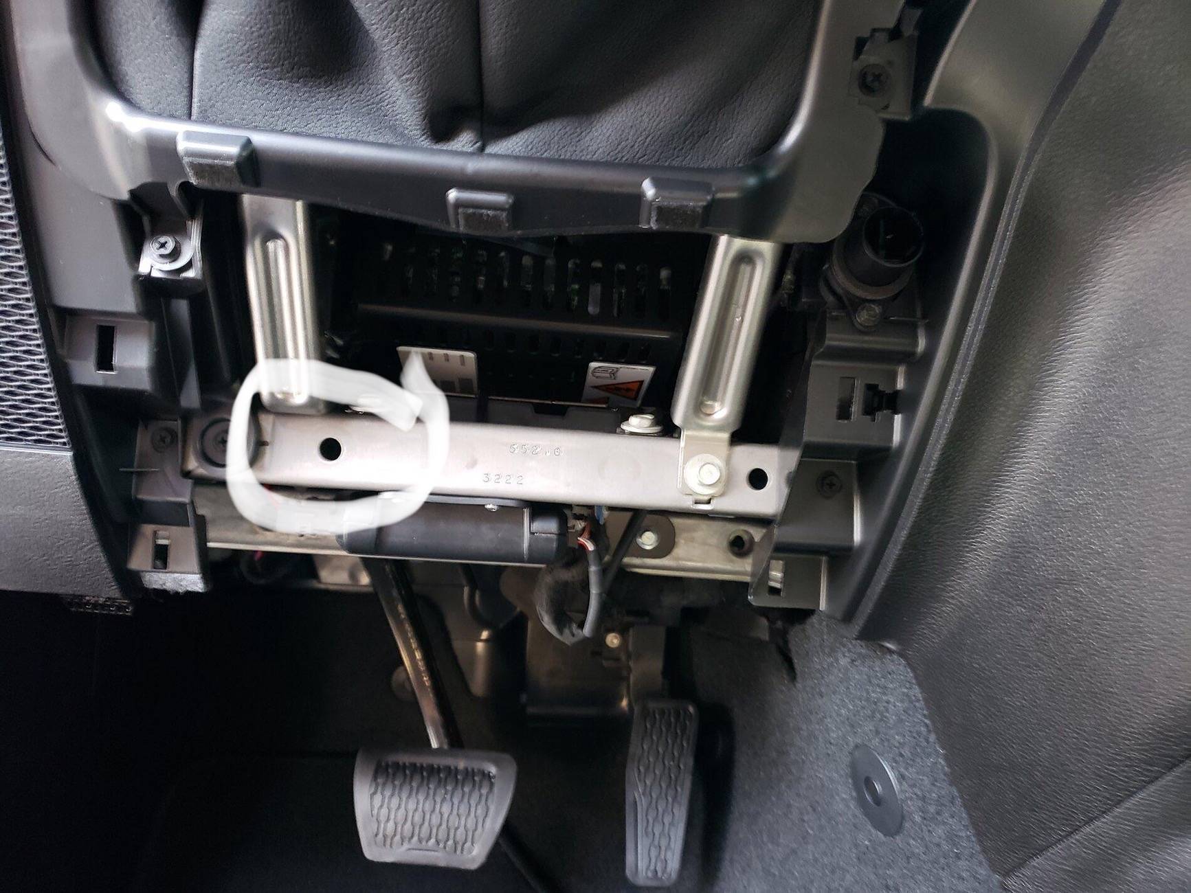

Hello, I need hand controls to drive and the push rod for the brake pedal is rubbing on a bracket under the steering wheel. Can I modify the bracket? Grind a half circle from the bottom the size of a quarter? It’s keeping the steering wheel from being able to go higher so I can see the gauges.
Here’s a pic of the piece I’d like to modify. Thanks!
Jeep Wrangler JL Can I modify this piece? IMG_1614
Need to grind it where I have circled.
Absolutely. Shouldn't be an issue at all.

Used to work in a shop that did those modifications all the time and yea grind away a bit that you need there. Nothing majorly structural or important in a crash.
