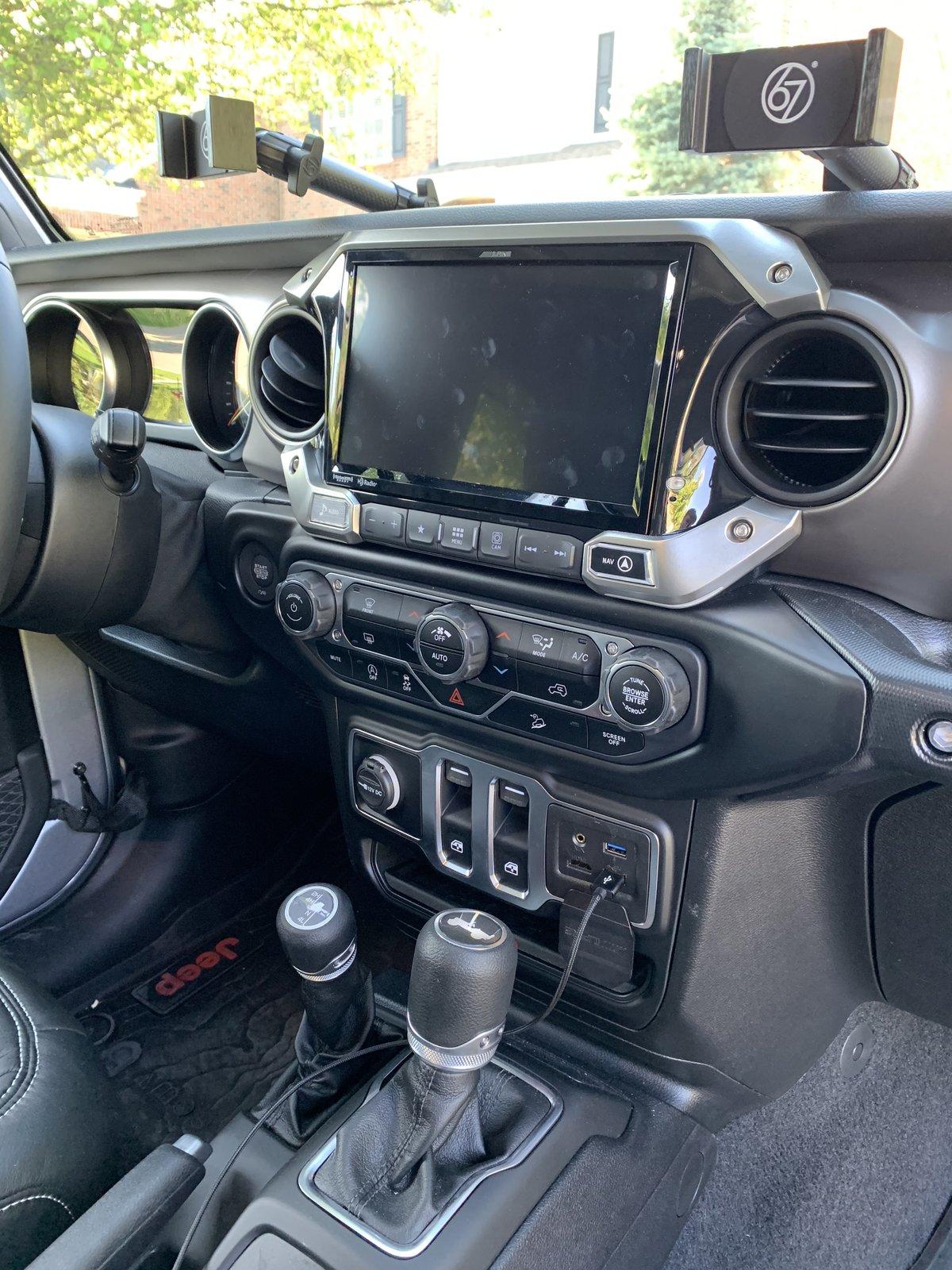

Headunit - I was able to secure the Alpine X409-WRA-JL head unit from a guy in Cali for an awesome price! I am still stoked about this system. I installed the system as directed, however, prepare for a full day... this thing is not an hour to install. It's pretty awesome though and I plan to add the extra modules to control lights/etc. I might also add the. module for additional cameras, we'll see.

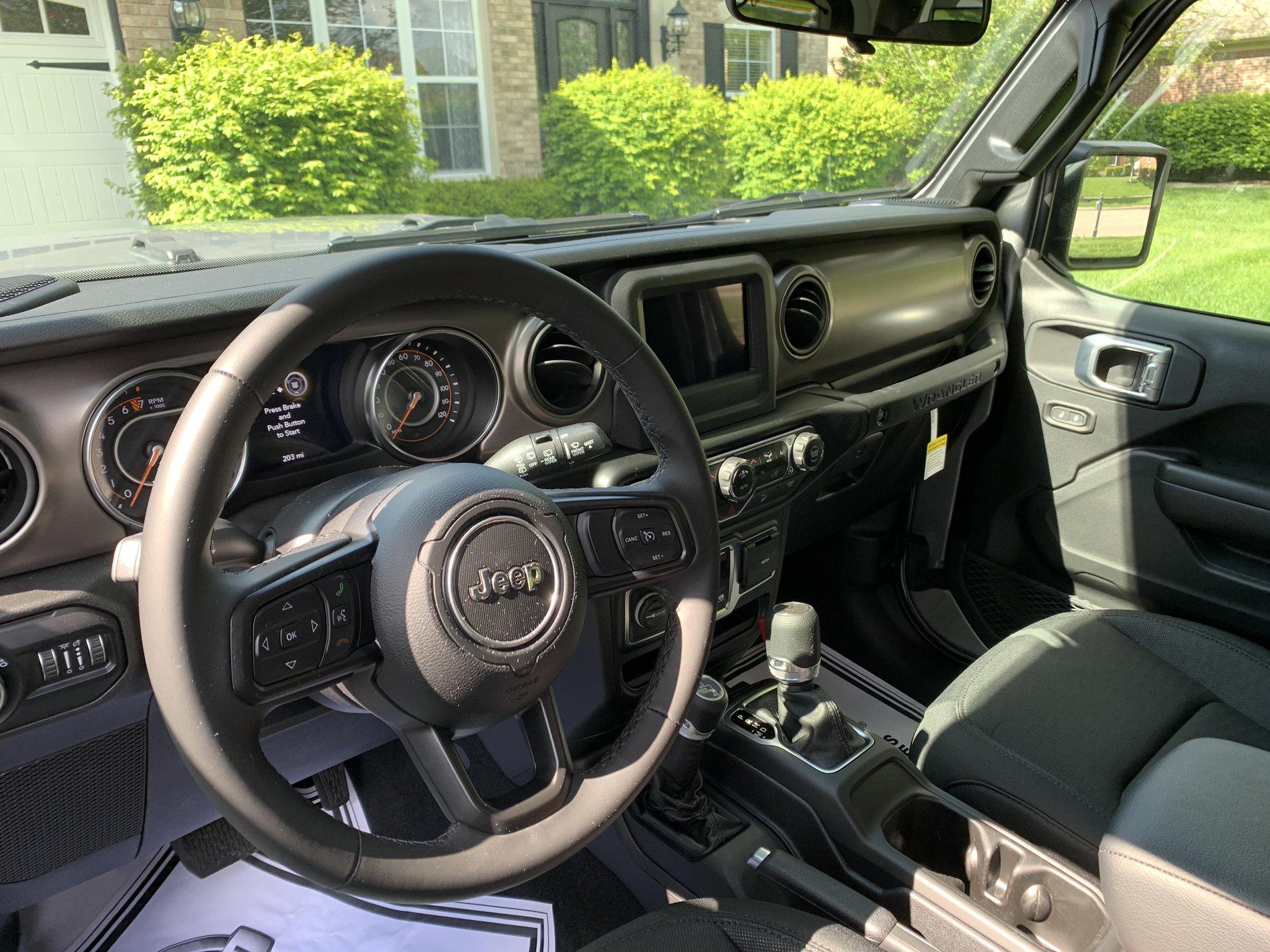

Before: (standard 7")

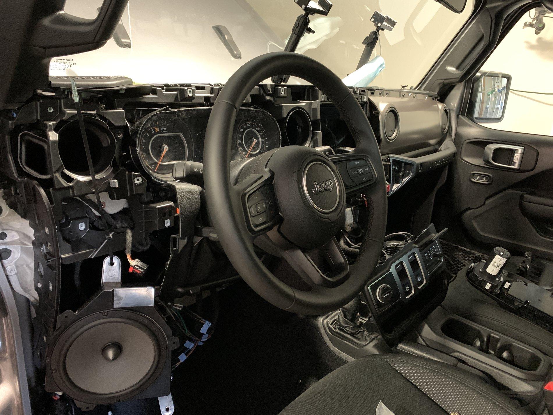

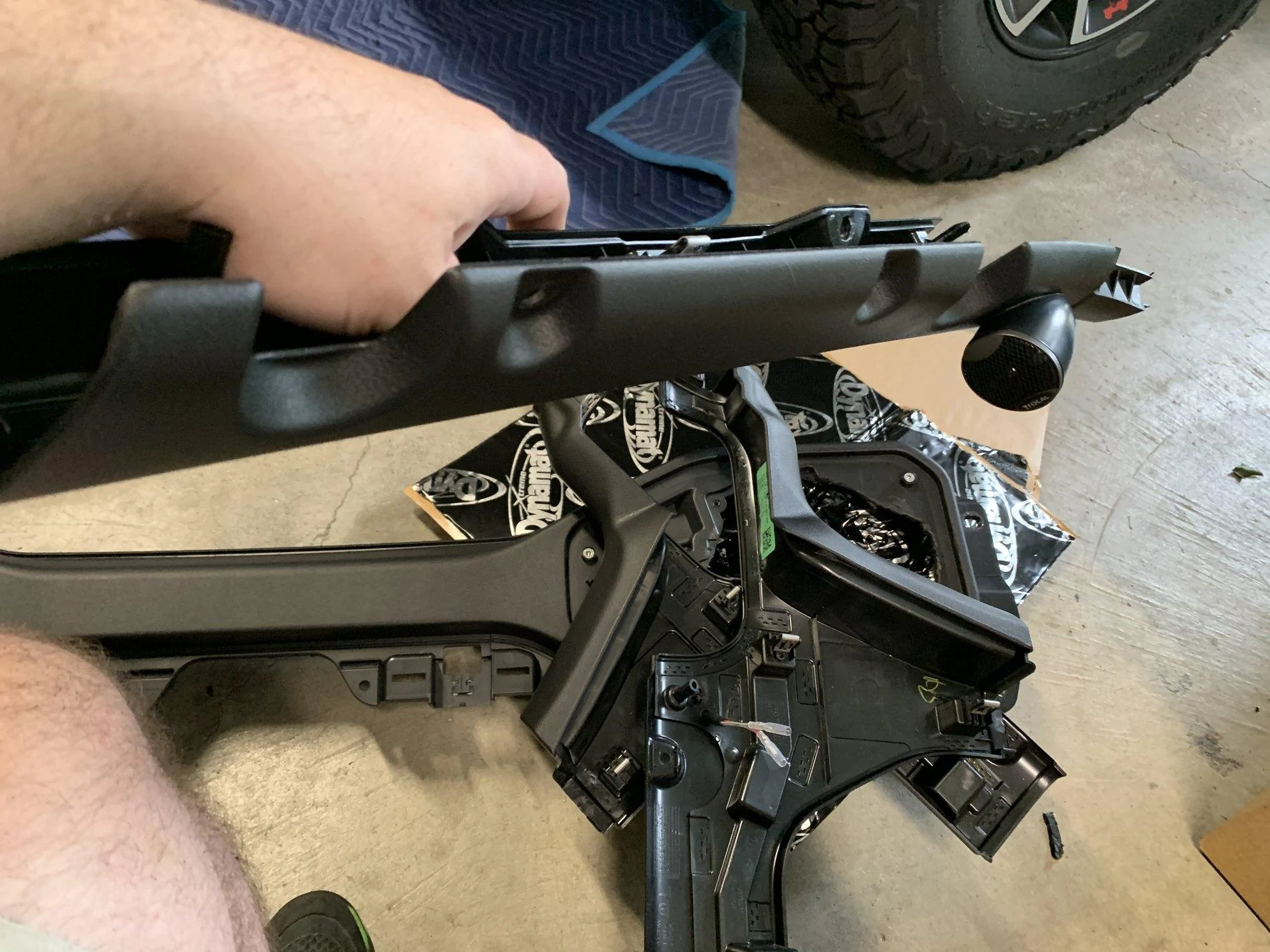

During: (yes, you have to totally take apart the dash)

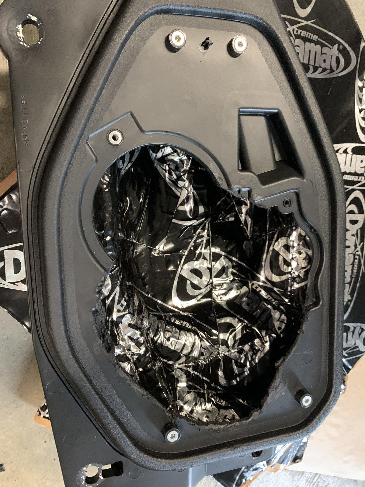

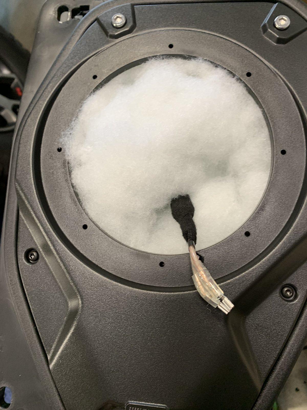

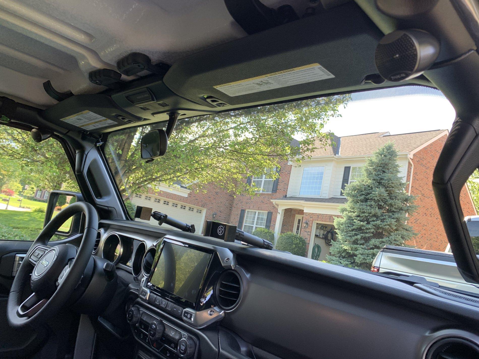

The Front Speakers: For the dash tweeters, I went with 3.5" Kenwood Excelon KFC-X3C. There weren't many options but these seemed ok. I went with Focal Integration 6.5" speakers from Crutchfield for the front speakers. They are great speakers, were 1/2 price on sale, and I really liked the tweeters as I felt they would mount well in the Jeep. I switched out the speaker pods with the Metra pods (see in pic above), they worked really well. I lined them with Dynamat and filled them with filling. I mounted the tweeters just above the A pillar on the trim. Sound positing is good and they are out of the way. The black / gray trim looks OEM and matches everything else.

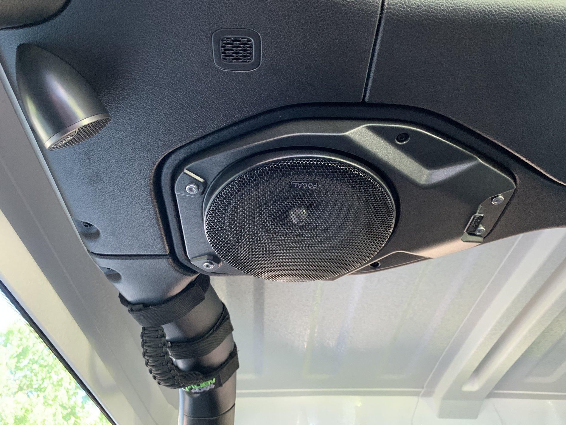

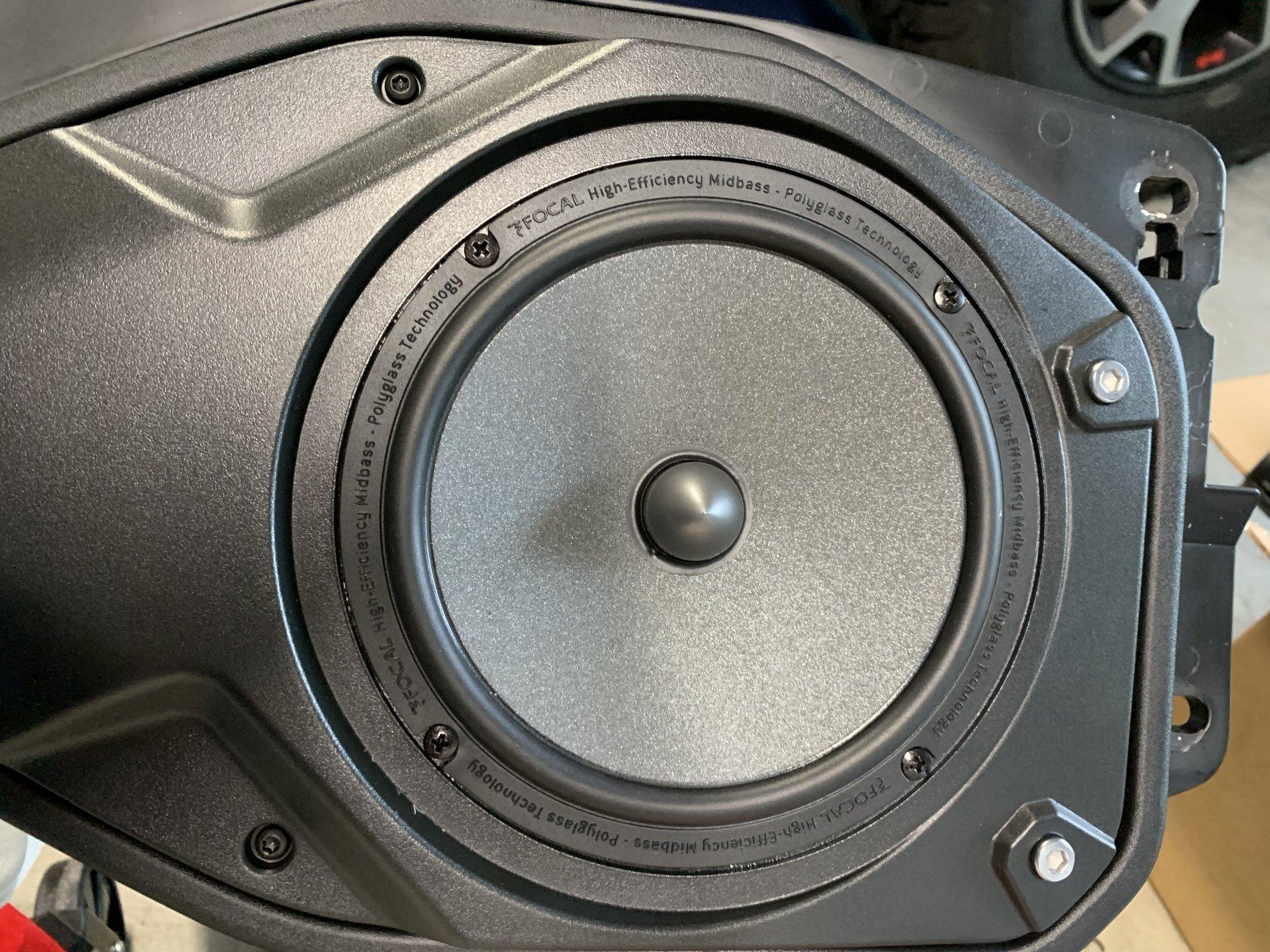

Speaker Bar: I again went with the Focal Integration 6.5" speakers and used the SSV kit to adjust the opening to fit. I lined the housing with Dynamat and added filler. I didn't use the factory wiring, instead I ran new wires for the tweeters and speakers. I did have to purchase the grills separately, but thanks to Ebay that was an easy feat.

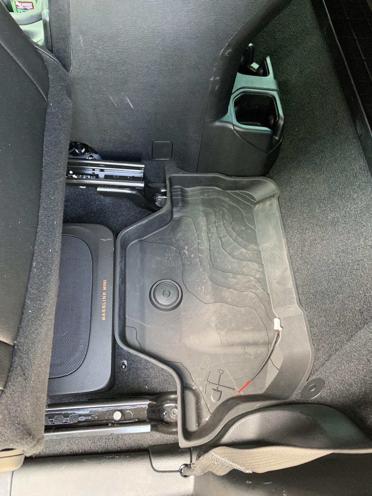

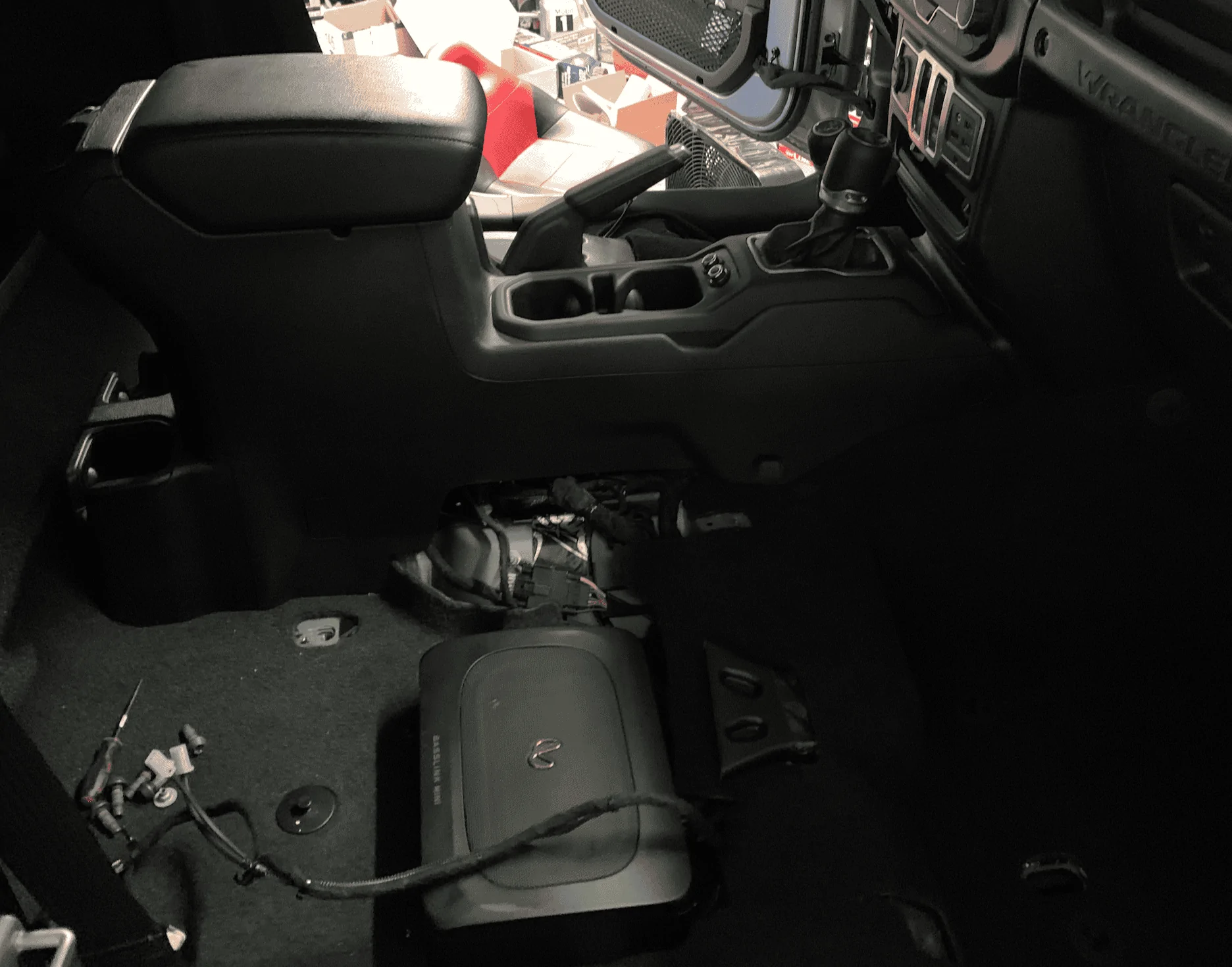

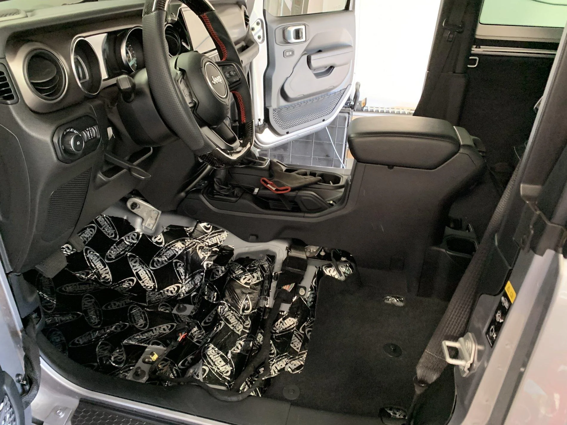

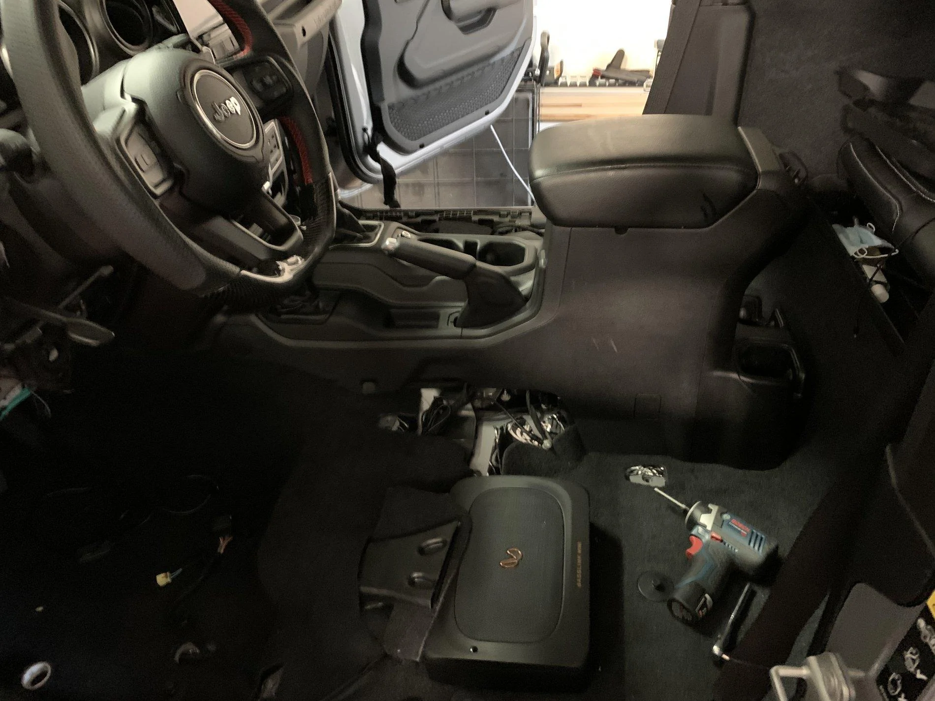

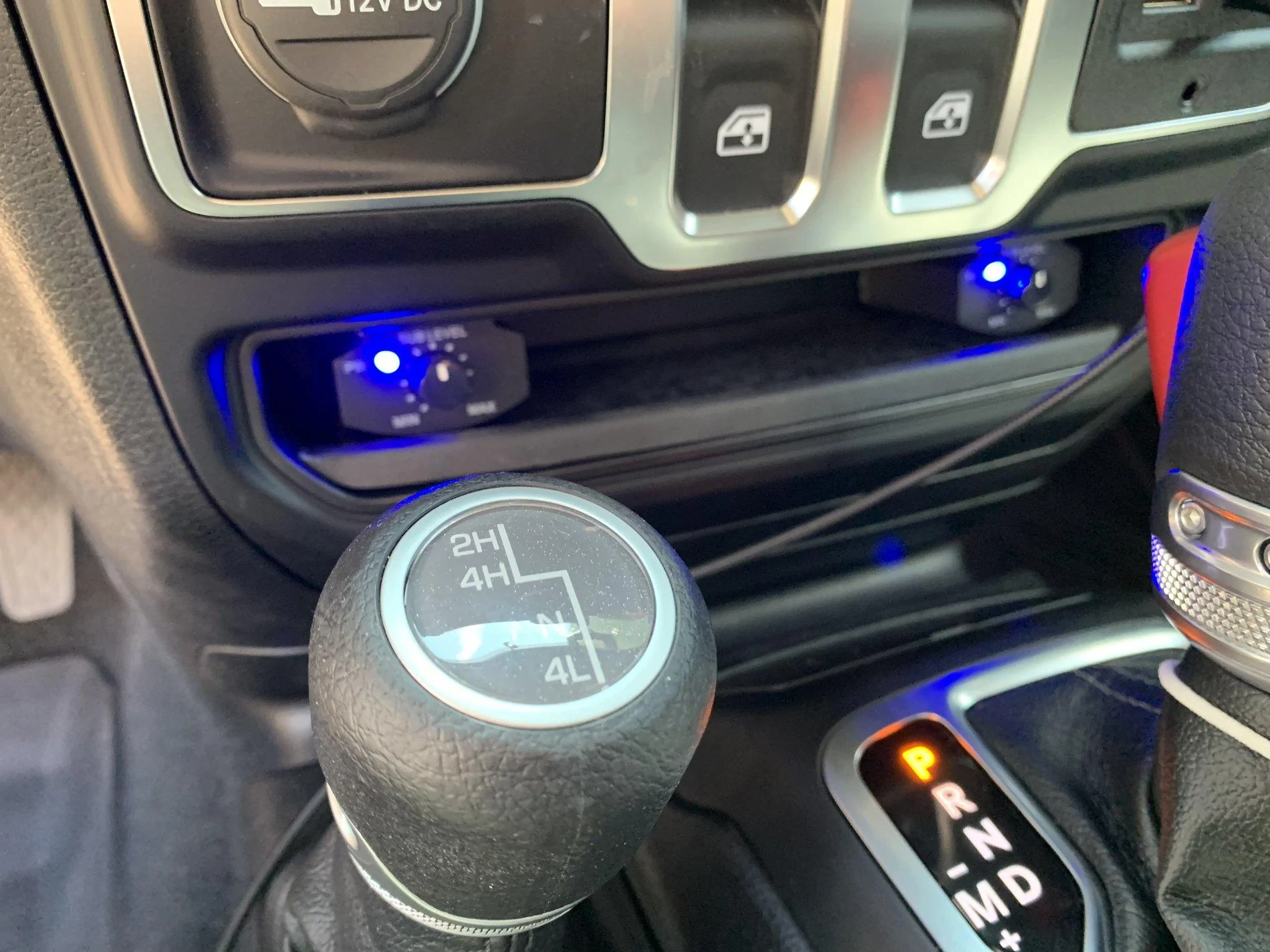

Subs: This was one of the trickiest parts... there is so little space in the 2 door and options are very limited. The Alpine system you see in videos and online is good, but it eats up the space in the back seat. Since I have kids I wouldn't accept eating the space and not being able to put your feet down, so the sub had to fit under the seat without impacting the floor mat AT ALL. But - I found a fit after searching and searching. I ended up going with two Infinity Basslink Mini's, again on sale from Crutchfield, and put one on each side of the Jeep. I had to modify the heater duct a little, also had to really tuck the sub tight against the center brace, but they fit. I ran the remotes for the subs to the cubby hole in the dash where Rubicon owners have their Aux switches. With a little trimming, they fit well. First though, I lined the entire floor of the Jeep in front and the rear with Dynamat.
