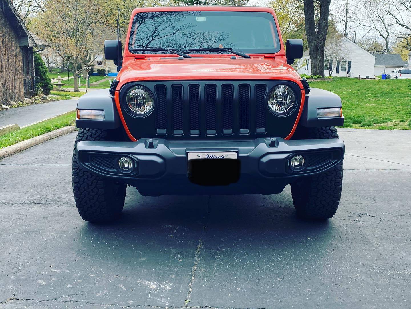

I upgraded my front bumper to a Sahara bumper and painted the bezels black and all I needed was these to fit my halogen fog lights.
Jeep Wrangler JL Bumper fit 534FA7D9-A48B-4849-8150-155C6FDC31BF
