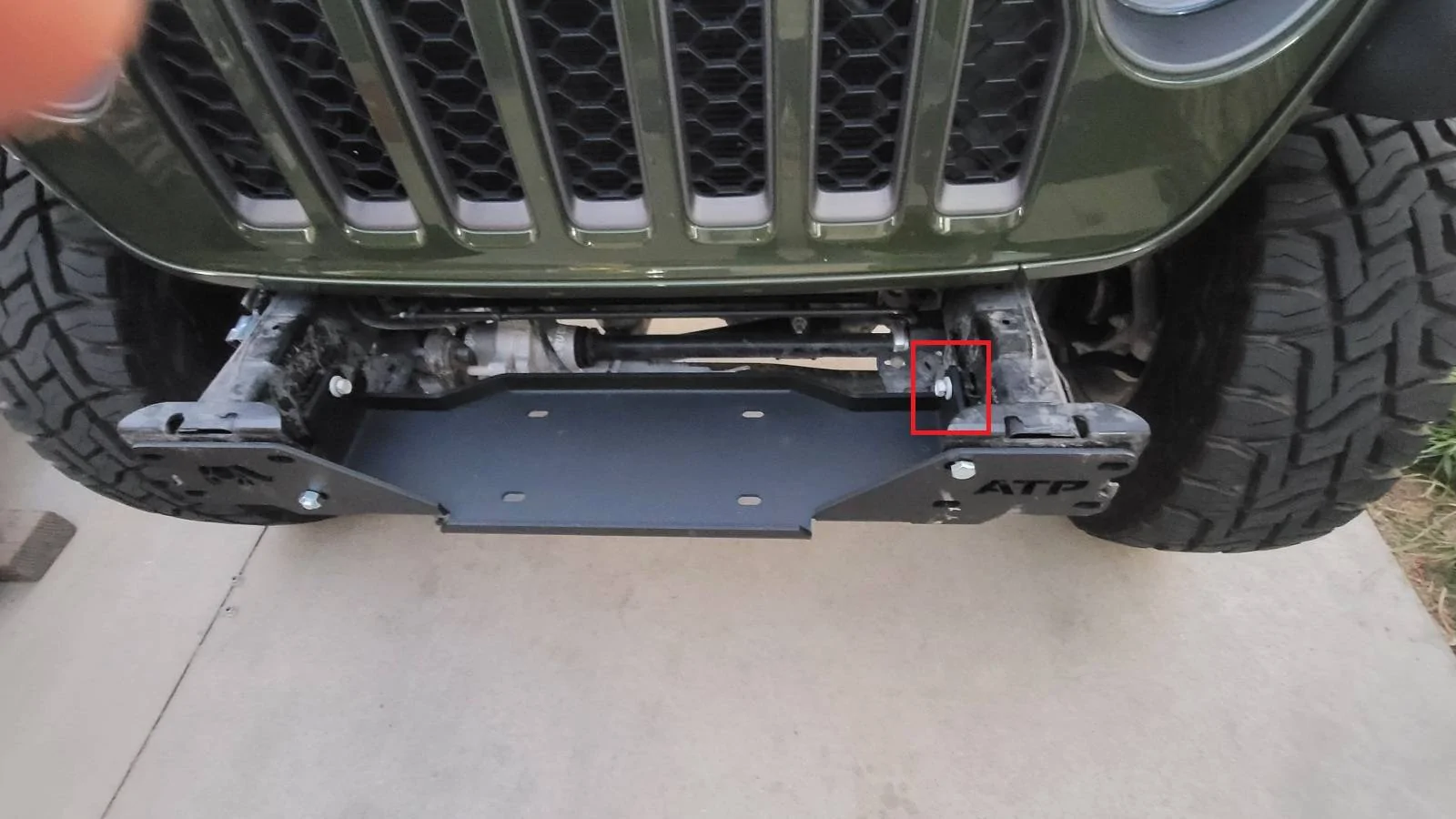

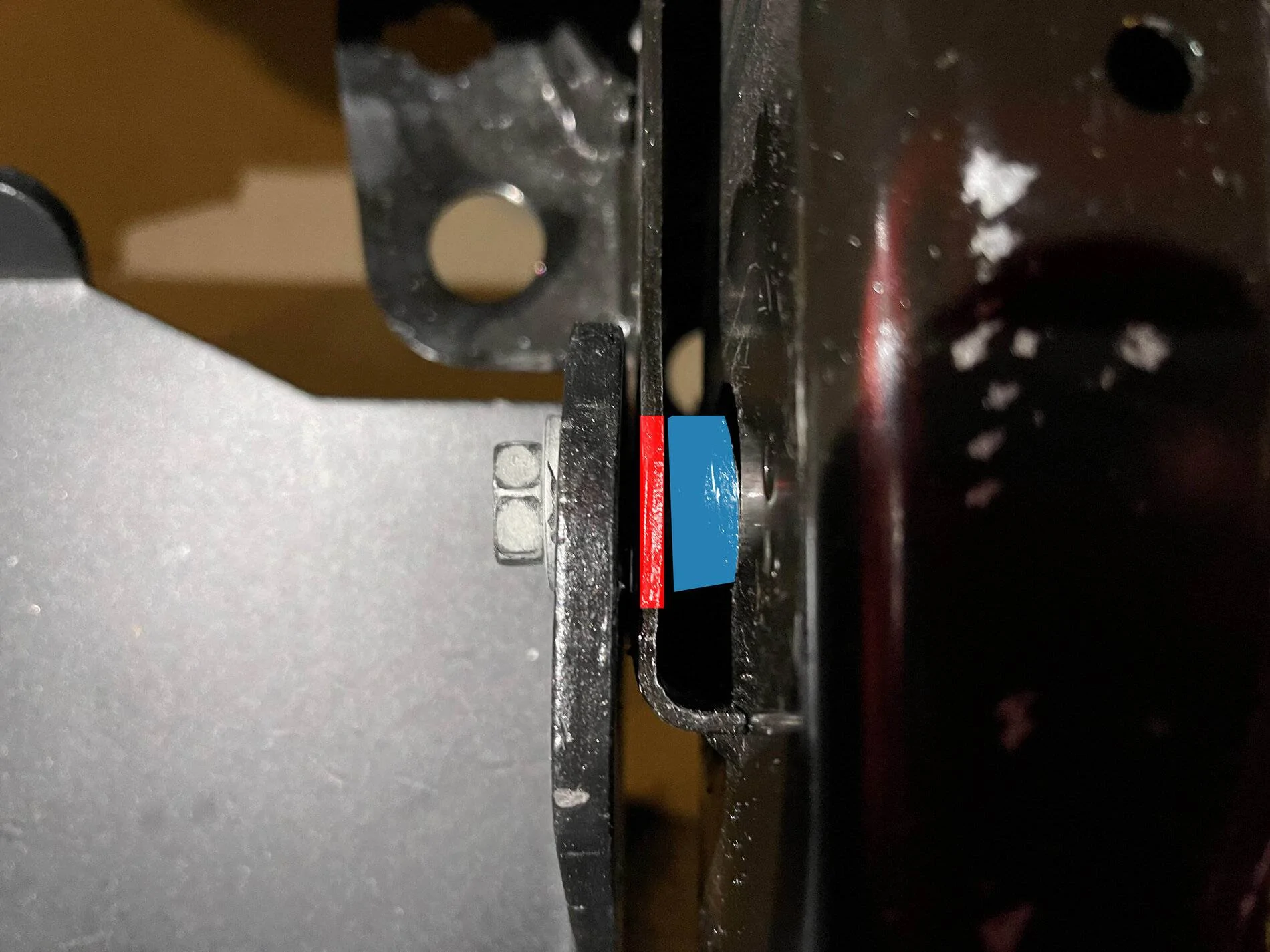

Issue 2. When we got to my install there was an issue with one of the bolts on the inside of the frame. As you can see from the pictures (the green jeep is for reference of location and the closeup is actually mine) the frame welded nut (blue) broke away from the plate (red) because the bolt must have threaded wrong and became too tight. The nut is round on the outside, I've tried to hold it with vicegrips but all it does is spin and not is stripped of all paint. I have to find a way to get the bolt out and not let the nut fall into the frame as it seems the frame has no way out up there in the front. I think if I can get the bolt out and not let the nut fall into the frame then I can use a new bolt, washer, and nut to save the job. Any ideas how to get this to the point where I can keep moving forward with the install?

Have you tried vice grips on the nut and pressure (pry bar) out on the bolt head while you hit it with an impact?

I haven't tried that. I can tomorrow morning. Maybe an impact will break it enough and with vice grips on the nut I can just pull it out from the top. It's worth a try for sure. Thank you.

Can you get a nut cracker on it, that would release the cross thread binding?

Unfortunately not. There is a plate on one side and the frame on the other.

UPDATE: I was able to get the bolt and nut out. It took some doing but I was able to pull the nut that was welded to the plate completely out. I can replace the bolt and the nut now so that issue is done.
