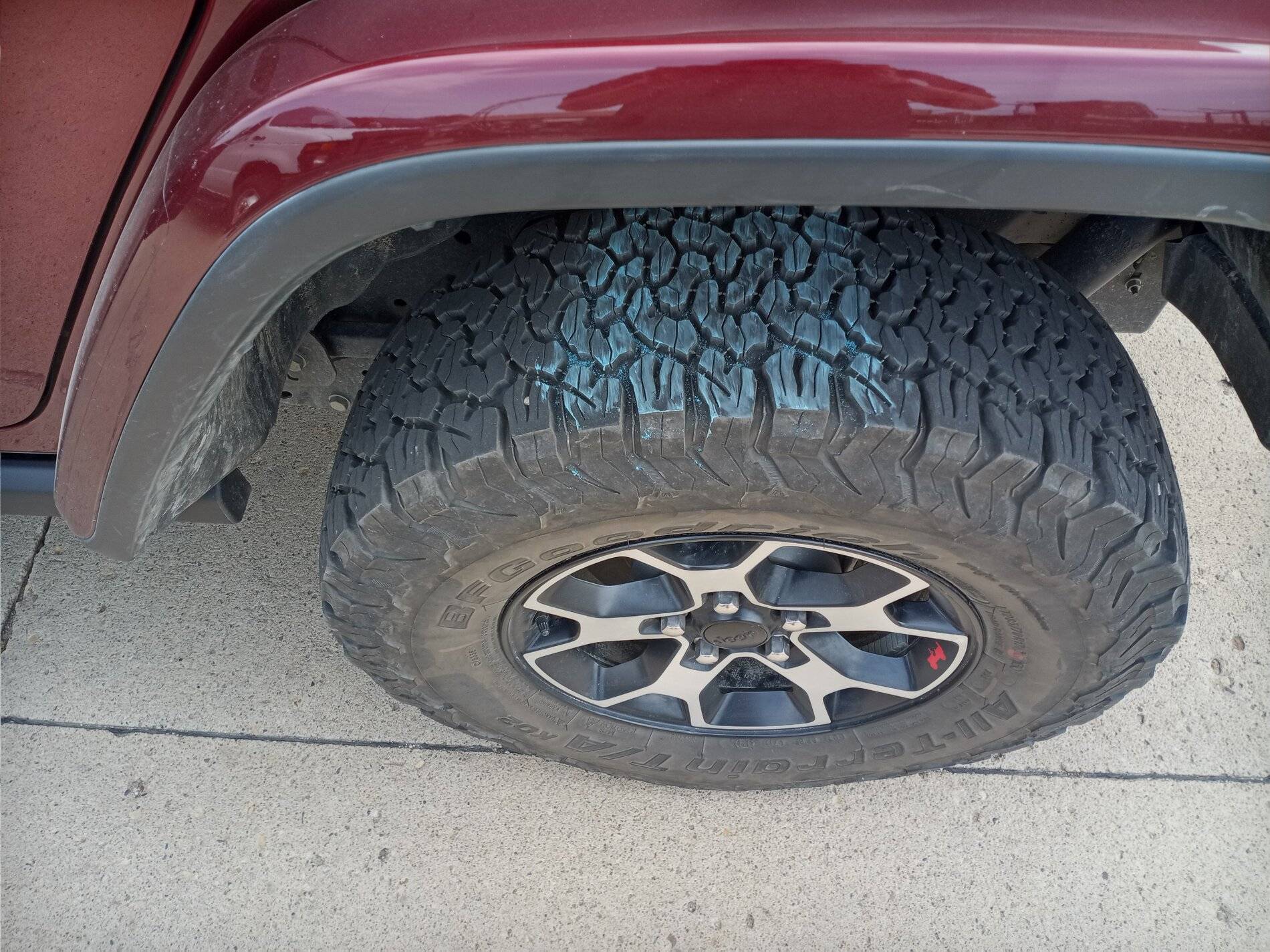

Running 31-32 here in the summer. Notice in the last pic you can barely see the chalk on the outer edge. I repeated this test 2X. Once on a back, blacktop road and once on the concrete you see in this pic. Got almost identical results so I think/hope I did the testing correctly. Did these tests after our run out to CO (see other thread) to wheel and back. Stock JLURD, AT stock tires, empty of all camping gear for the tests, 3/4 seat delete, half doors...as seen in pic. When we get the deep snows/drifts I will air down just a little more...personal preference. I also ROTATE tires on a very regular basis, 3-4K miles and 5 tire rotation.

My light is constantly on now...no biggie for me. I check tires often. Have a tazer for the JK but not getting for this one yet until I eventually go up to 35's.

Update on tire wear in post #21 here. Here is the snippet related to this thread:
FYI - this was over a distance of 3389 - 2545 of which was during the CO trip. Also posting this info to help validate that running my tires at MY "chalk test" pressure has done no harm whatsoever to over or under wear across the surface of the tread. At least, as per the mechanic.
