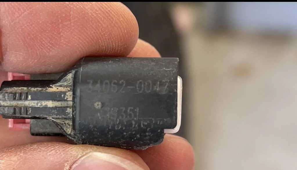

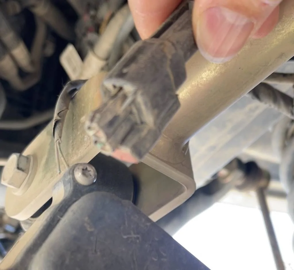

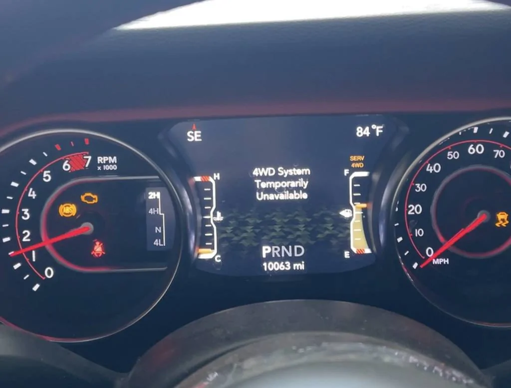

Last weekend we were on a fairly easy trail (Webster Pass) when I started getting multiple warning lights. These included ABS, Serv 4WD, 4WD Unavailable, Stability Control Unavailable, and Traction Control unavailable. We got back home without issue and I started looking under my Jeep. There I found a broken wire near the front passenger side of the axle. I think this is to an ABS sensor and this cascades to all the other issues. I think, while flexing, the Jeep pulled the ware from the Molex connector.
So basically I'm looking for this connector so I can fix it myself. I think the one linked below is it but it doesn't have the exact part number. http://cycleterminal.com/molex-mx150.html.
It's an MX150 type connector, part number 34062-0047. There are also some other numbers on the connector (19351). I'm very confident I can repair this myself if I can get the part. The sooner the better as I'm wanting to hit up Holy Cross this weekend. Can anyone confirm this is the right Molex or point me in the right direction on it? Many Thanks in advance.

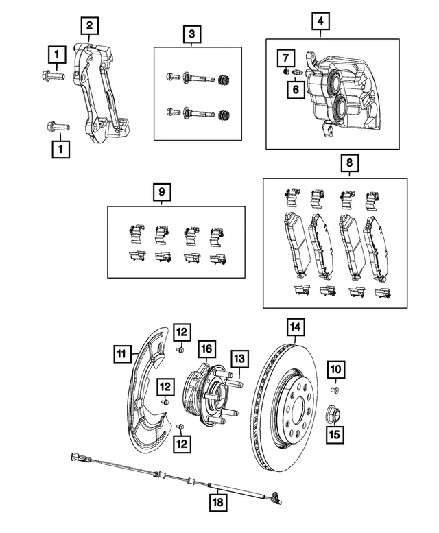

Any chance it's the wheel speed sensor? Looks like it comes in a "kit" from the sensor to the first connector. P/N 68394210AD (~$40 online)
No. 18 here:
Jeep Wrangler JL Broken wiring harness 1629737808746

It looks like that cable, (part 18) has the male end of the connector. I need the female connector.

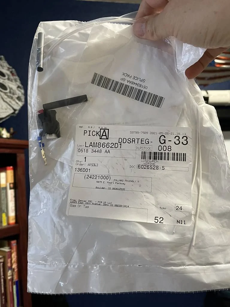

WOOHOO! I lucked out! I went to Pollard Jeep in Boulder and they had EXACTLY what I needed. Bonus that it came with about a foot of wire that is already crimped to the pins. I just need to assemble everything.

Hi -- I have the exact same issue and need to order this splice pack. Do you know the Mopar p/n? I tried different numbers from your picture and it does not come up. Any pictures of your splice work afterwards? My issue if the front right sensor.
GATORB8
May 30, 2021
8,894
11,830
CLT NC
21 JLURe, 06 LJ, 25 HDZR2
05183448aa
