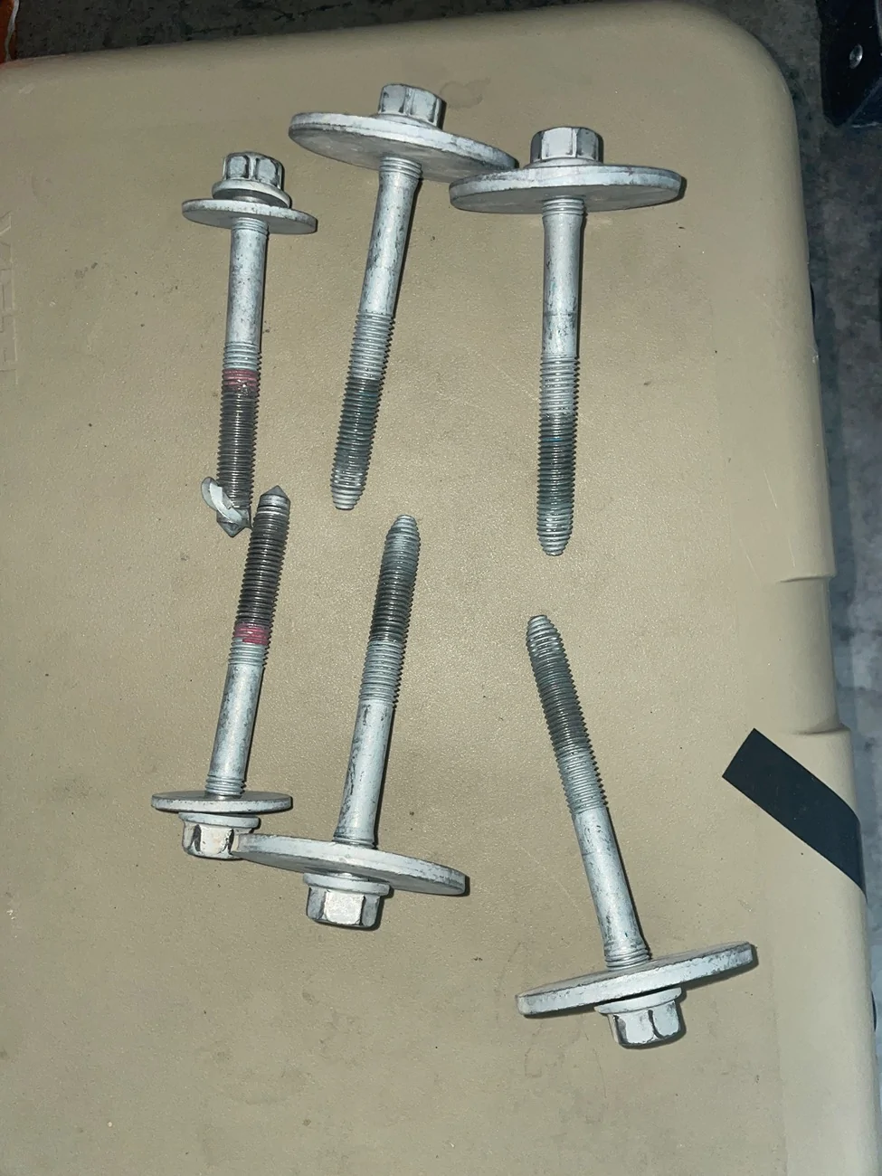

Jeep Wrangler JL Body Mount Bolts IMG_0578
The top left bolt still has a washer attached in the pic, it’s down on the tip. The washer holds the bolt in place on the body until you force the body bolt down and away from the body. You can see how mangled up it got when I pulled out the bolt. The other bolts separated from the washer and you cant see them in the pic..
My sliders included new bolts, they don’t use the crush washers included in the OEM bolts. So it is my internet guess that your bolt has been unscrewed from the body but the washer is holding it in place, and that is why it keeps spinning.
Either way when you completely remove the body bolts they will look like the ones in the pic. If they are BROKEN they will not have a pointy end and that is a massive headache you don’t want.

I suspect they aren’t all truly broken. I removed mine carefully with hand tools and installed RSE step sliders. They can make popping sounds that might lead someone to believe something is breaking as they are being removed. Hopefully the person got cold feet and didn’t want to deal with it.
If you’re being told it is covered under warranty leave them alone and let them deal with it.
