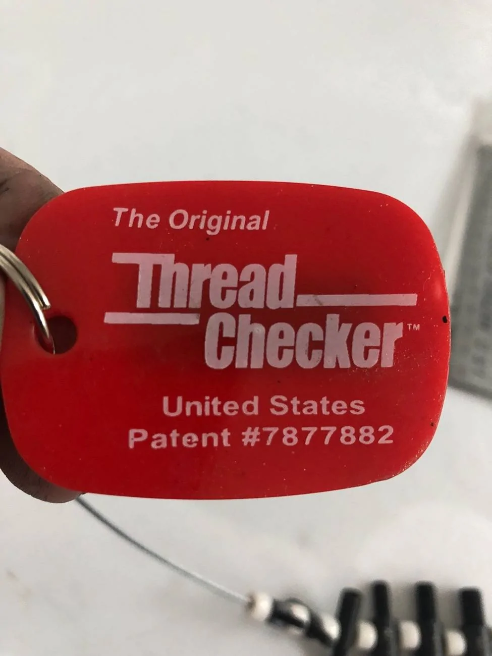

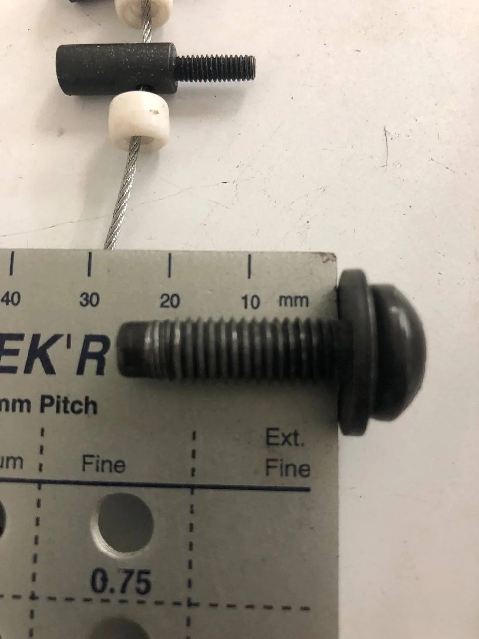

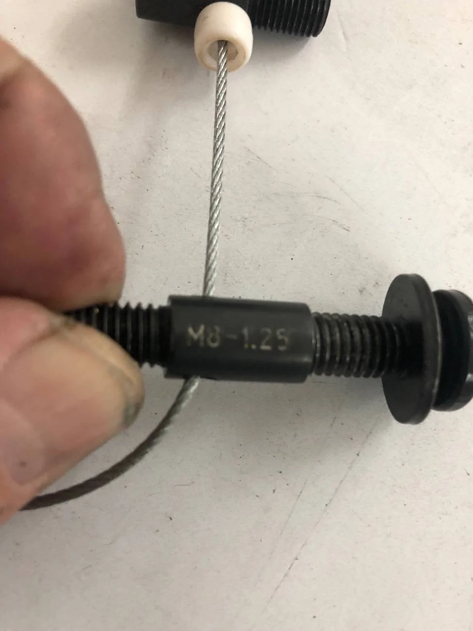

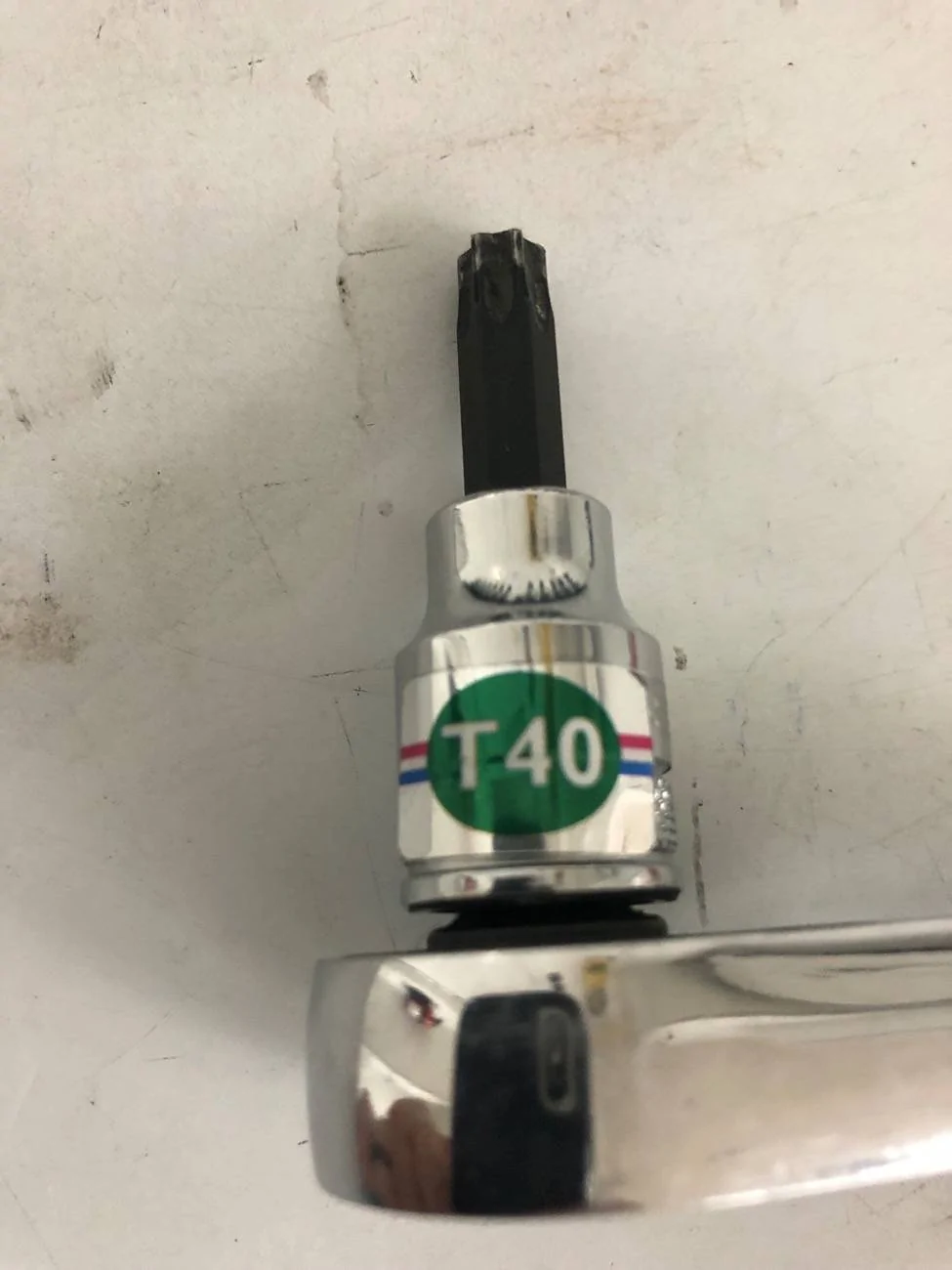

Hi,
Does anyone know where I can find the bolt size/dimensions for the beauty ring bolts?
This is for the 392/Rubicon X/Rubicon Extreme package equipped (maybe others) vehicles.
Thank you in advance!
I can find the replacement bolts but I cannot find the specific size of those bolts...
@DOOKEY says “The 392 beadlock capable wheels take a M10x1.50. The XR Beadlock capable wheel takes a M8x1.25.” I’m betting he knows the correct dimensions.

Weird that the size is metric but the length is standard? I can convert length to metric as well.

No sorry those are metric, the “ symbol is a quotation mark since I quoted @DOOKEY. M8 x 1.25 is the bolt size and thread pitch. The length Is not given.

Yes. I had forgotten that until I searched them. I'm sloooowww sometimes! Thank you!
