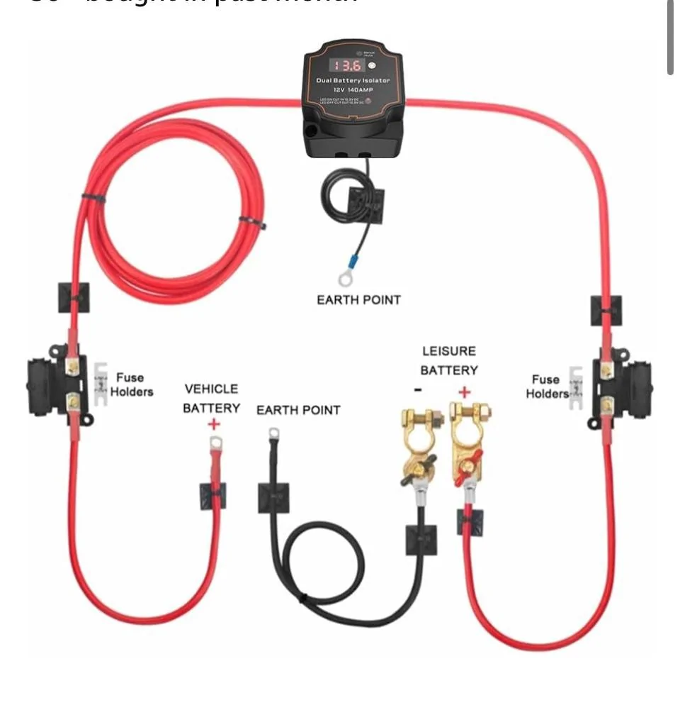

100% my fault I killed batteries. But after first roadside couldn't jump it with high amp NOCO and wait over 7 hrs for flatbed to jump. I started looking at dual battery kits. Nearly spent $1100 on genisis gen 3 until I read comments from people that have gotten stuck still with it because it's cutoff it to low to crank Jl's sometimes. I found kits online like the auto isolator my boat came with 25 years ago. And for $60 and up you can get automatic ones that isolate main battery at higher voltages to ensure Jl's start. One guy commented pictures of his full size aux mounted in the tiny trunk since 19 and runs fridge camping and zero issues. For me it's piece of mind knowing my daughter isn't going to get stuck and have to get step still out of trunk and climb my 4" lifted and try jumping it

Hey @Joe jl what are you posting about? Did you install the thing in the first picture or are you PUI? Are you asking, or telling, and if either of those, what? Your post just seems like a random thought pulled out of the ether and posted on a forum. Context maybe? Is this the sort of post a person makes right before they do something awful? You kill batteries, cool, like for a living?
The pictured device disconnects at 12.8 V, the Genesis system disconnects at 12.7 V. That difference in voltage threshold is entirely inconsequential.

What is your house load? Unless it's just a fridge or inverter, not going to help much since all the Jeep circuits are integrated.
