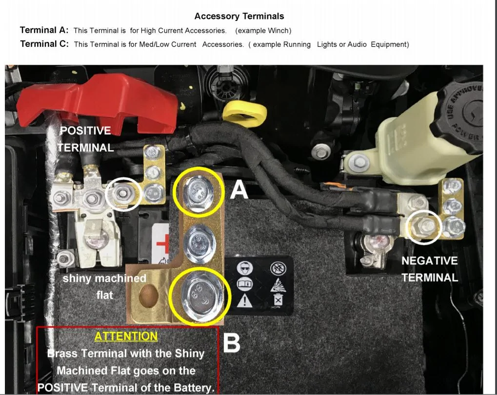

Maybe it's just me.. If I'm missing something I'd gladly put on my hat and sit in the corner for lunch.. when the reference 'C' for Med/Low Current and there is no 'C' in the picture.. who writes this stuff??

Where on earth, did you find the labeled pic you posted? :puke:
It was on a Jeep parts site that starts with 'Q', it's their in-house product.. just seemed a bit sketchy to me as I'm not too experienced with electrical..

@Dadams20
Best bet is to seek / search out... a forum thread that focuses on the electrical goodie you wish to install on your JL. You will find info you need and you will easily get the info you need. Lots of guys are willing to guide you along lets say.
What are you wanting to install?
That pic will do little for a guy that is "inexperienced with electrical" as you say you are.

Installing a winch soon, so just wanted to ensure I'm using the right option.. Thanks, I'll do some searching, appreciate it!

@Dadams20, I'm not sure what the purpose of that brass piece except to add additional contact points...but I hooked up my winch directly to the bolt in the white circle and it works perfectly.

Thanks - I'm going to do just that and put this poor tech writing thing to bed.. it seems to be a trend in after market Jeep installation instructions!
