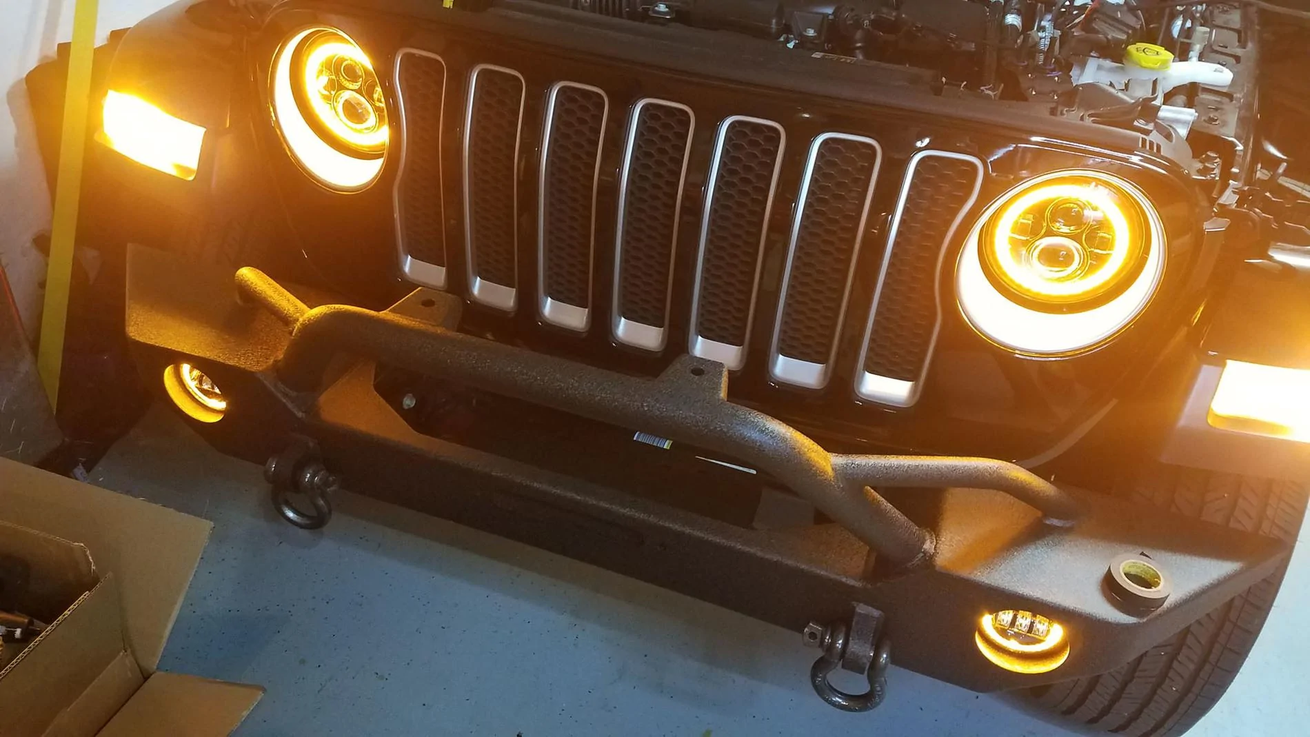

I got the 7" with brackets from Inspired Engineering. White/Amber Halos. I love them.
I wired the Amber Halos to the ignition on, to use as my DRLs, and turned off the fender markers (Too many DRLs).
You don't really notice the gap, and I figure it helps with getting air into the engine compartment for cooling ;)

Wow those look awesome! For some reason I thought the gap looked much more noticeable than that so maybe I'll go with 7" after all.

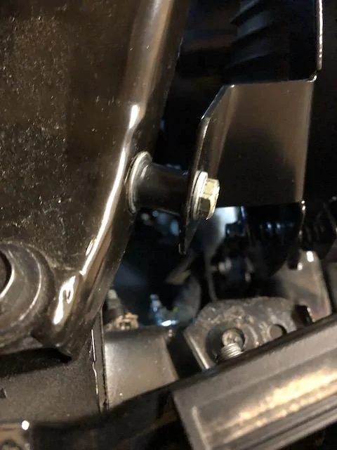

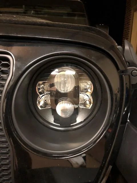

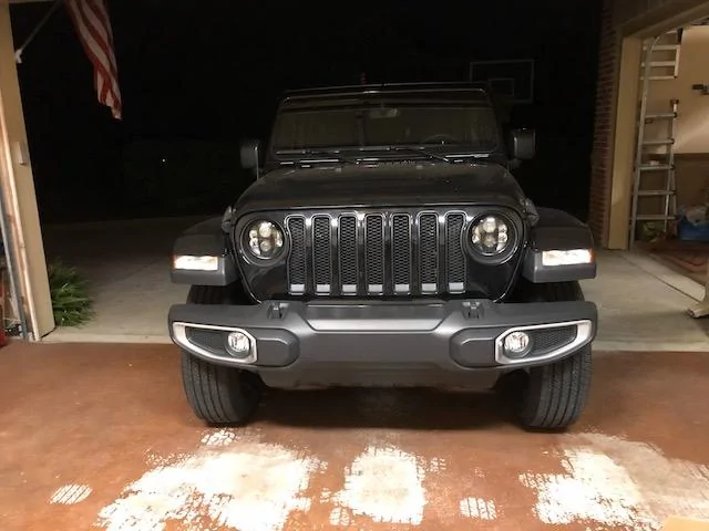

Here's mine when I finished with them.
Jeep Wrangler JL Aftermarket Lighting- Headlights & Fogs HeadlightsInstalled
Close up of the headlight bucket
Jeep Wrangler JL Aftermarket Lighting- Headlights & Fogs HeadlightAdapter
I did install 1/2" spacers on the bolts of the adapters to push them forward, so that they are tight up against the headlight bucket.
