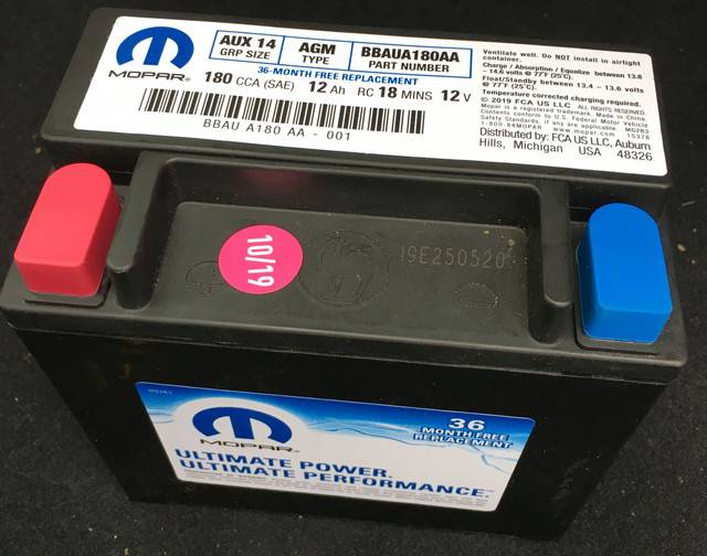

I was looking under the battery tray, and I think I see what is a smaller tray for the ESS battery. If that's the case, then I'm going to get one of those ESS batteries and wire it into the system as a backup or accessory battery. Those batteries don't hold much juice, but it might be a nice to have. I'm of the mindset that you can never have enough battery when you're in a place where a jump start just isn't possible.

I wouldn't go through the hassle of putting a small ESS battery in your vehicle.....
Their capacity is small and pretty much useless.
Jeep Wrangler JL 392 Battery - what group size is it? IMG-3393-mopar-battery-BBAUA180-AA-part-number-3
So 12ah, my 12v Fridge/Freezer combo takes about 5 amps while running and although it doesn't run continuously that battery would be dead within 4 or so hours. The odyssey battery you have is designed to be deeply drawn down and recharged, it has a 65ah capacity what kind of things are you wanting to run, if you are looking for an extended run solution then a dual battery kit would be the way to go instead of a smaller secondary battery.
