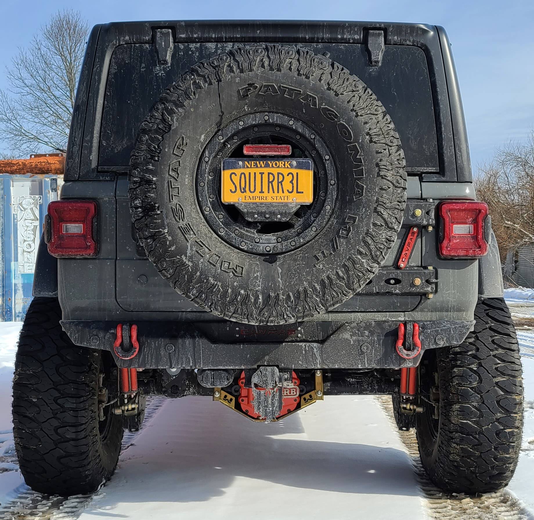

A 4 door kit will definitely net more actual height when installed on a 2d vs 4d. It will also ride stiffer as a byproduct. For reference, here's my JLUR with the 3.5" Metalcloak Gamechanger 4 door kit and 38's with chopped fenders. Even with unchopped fenders, a 3.5" kit specifically for a 2 door will net you plenty of lift for 37's. Mine is still sitting at about 3.75" over stock with a 12k winch and mounting plate, sliders, aftermarket rear bumper, hinged tailgate reinforcement, and on-board air. Before these items, it was about 4.25" over stock height.
