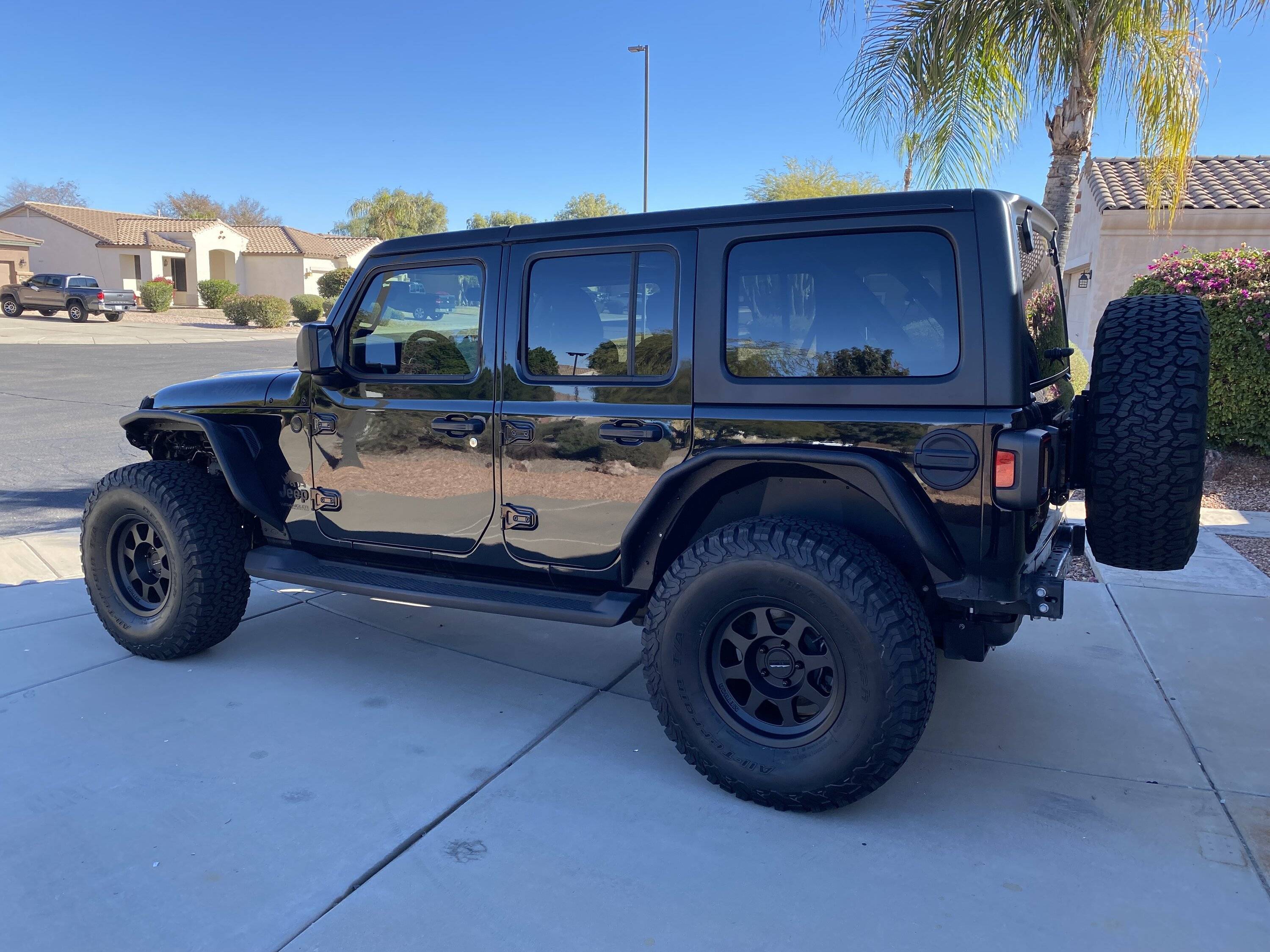

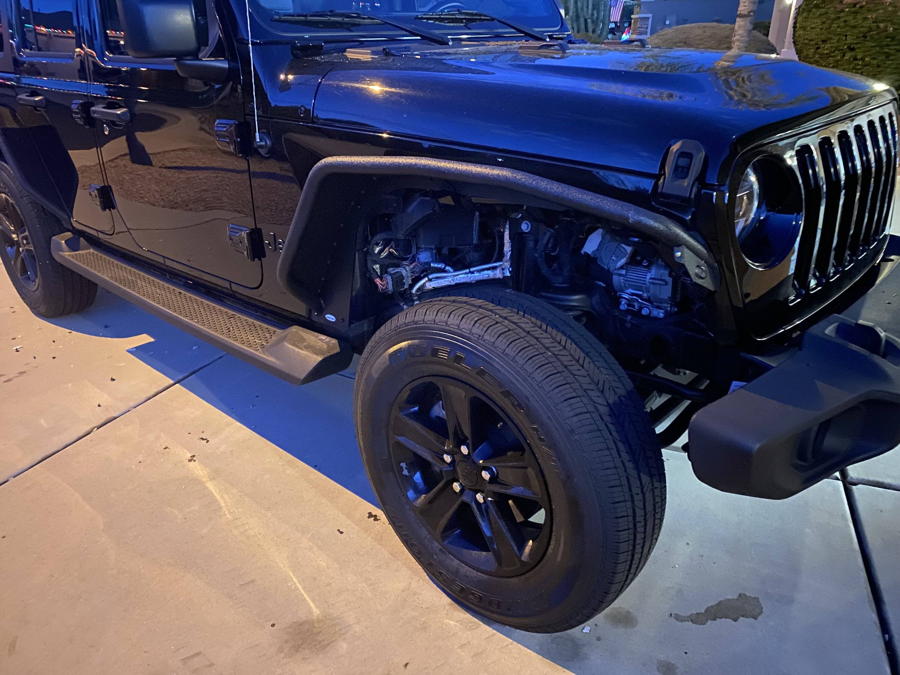

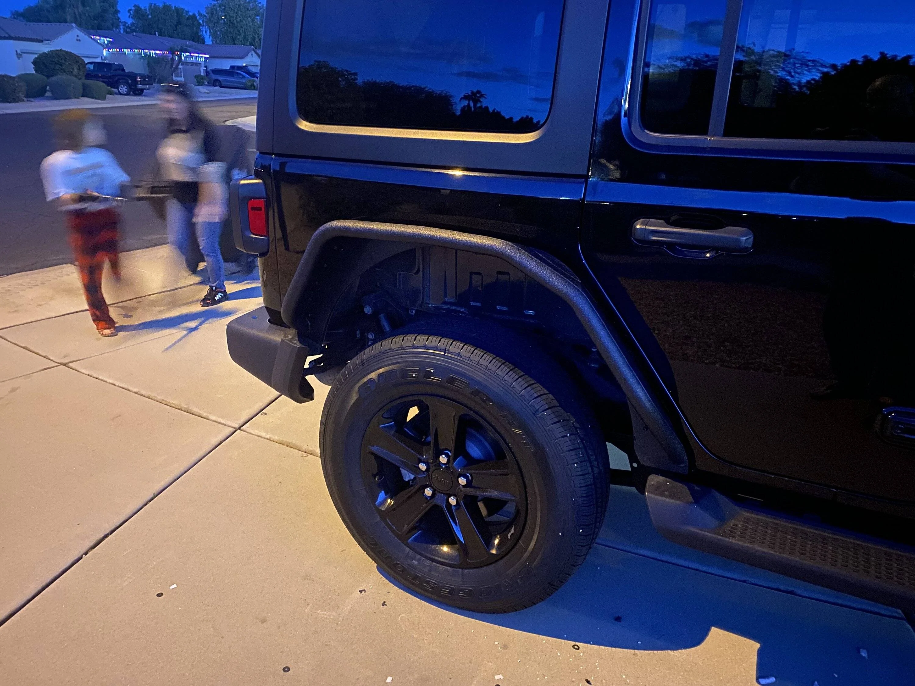

Got the new fenders in today. Hooke Road angled fenders and liners. Still waiting on the liners but I’ll put those in after the lift anyway.
Jeep Wrangler JL 2020 JLU EcoDiesel Build - 'Black Rhino' IMG_0247
Jeep Wrangler JL 2020 JLU EcoDiesel Build - 'Black Rhino' IMG_0248
The fit was fantastic. I didn’t have the thread for their rivnuts so I had to use their tool they provided which broke pretty easily so I had to make my own. Plenty of room in there now for wheels and tires next week and I’ve still got the spacer lift to put in this weekend.

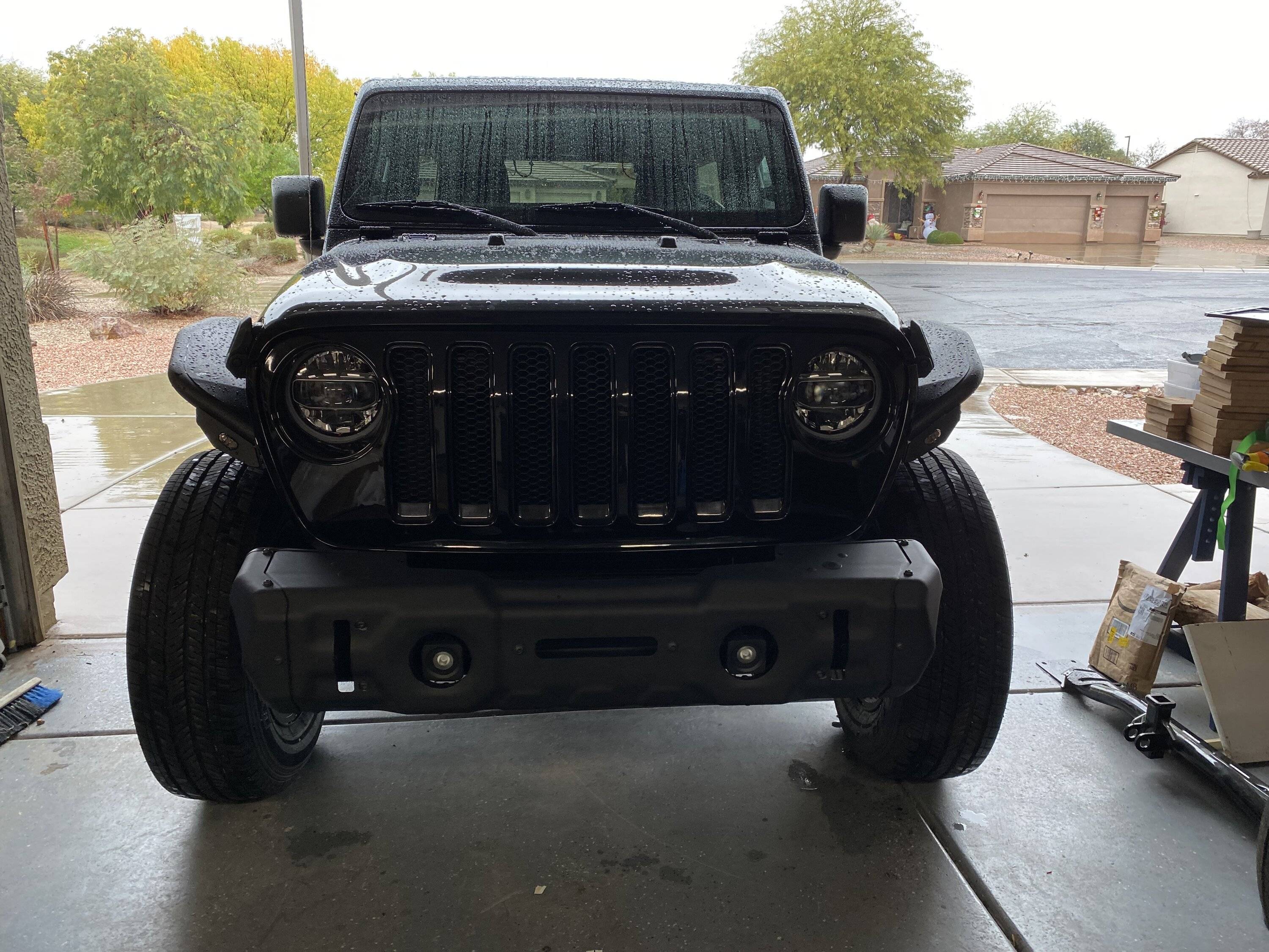

Installed my Stubby bumper and winch mount. Wired up the fog lights and led turn signals.

Wired up the highlights and gender turn signals.
Is it a He, She, or They? Never seen a gender specific turn signal before ?
coming along nicely, keep us posted

It was a busy afternoon. Got the rear fender liners installed.
Jeep Wrangler JL 2020 JLU EcoDiesel Build - 'Black Rhino' Photo Dec 28 2023, 7 28 48 PM

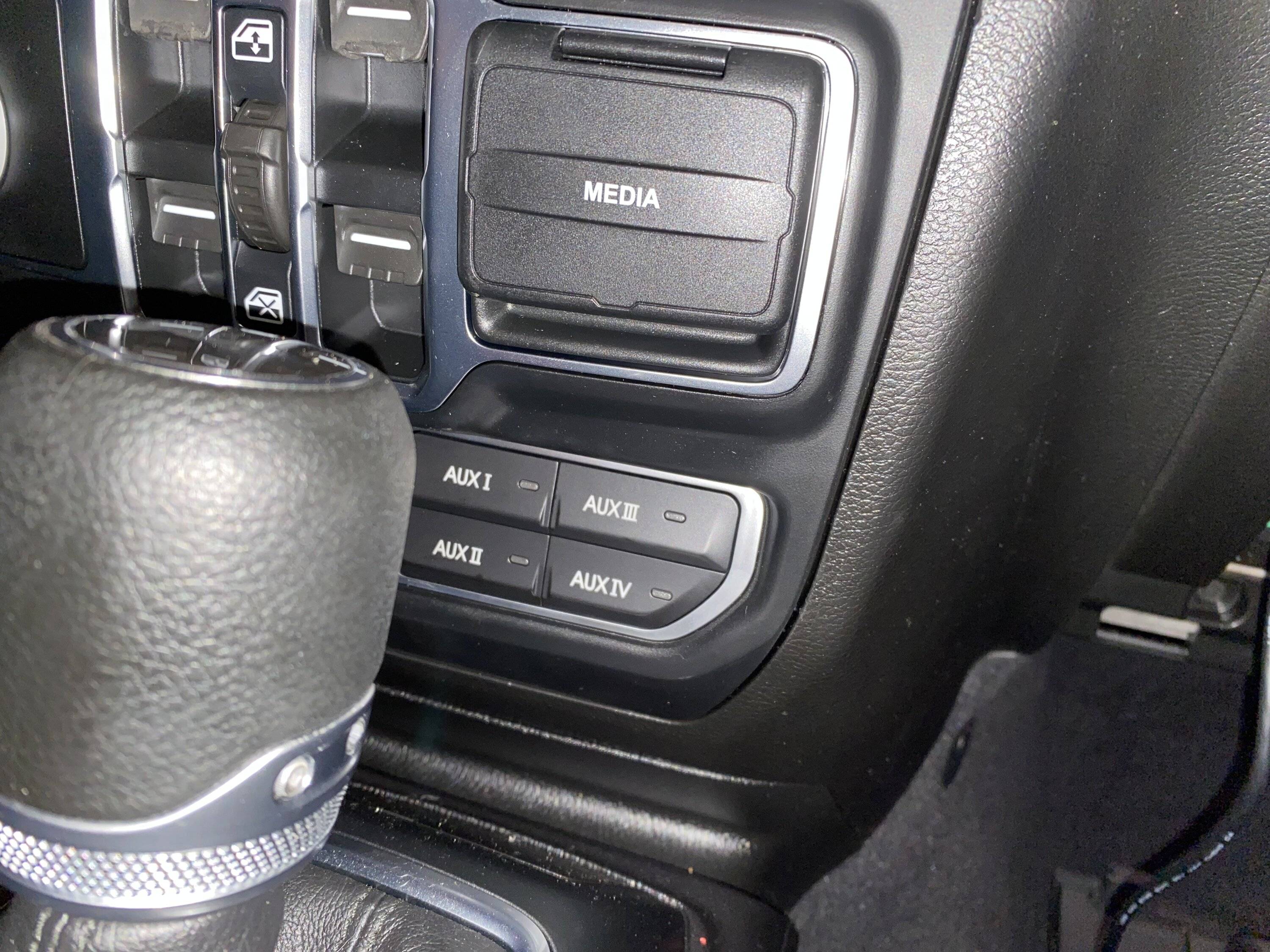

Got the Lastfit aux switches installed. Need to zip tie all the wiring tomorrow under the dash but everything is operational.
Jeep Wrangler JL 2020 JLU EcoDiesel Build - 'Black Rhino' Photo Dec 28 2023, 7 29 13 PM
Jeep Wrangler JL 2020 JLU EcoDiesel Build - 'Black Rhino' Photo Dec 28 2023, 7 29 27 PM

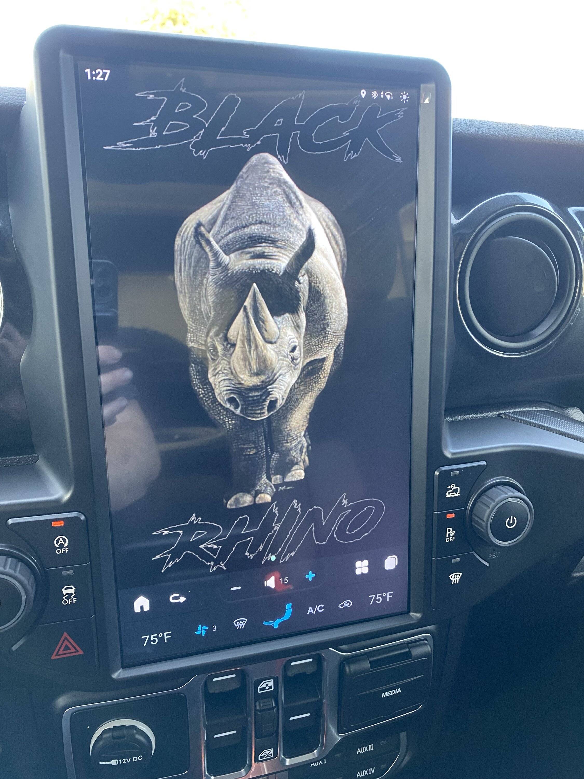

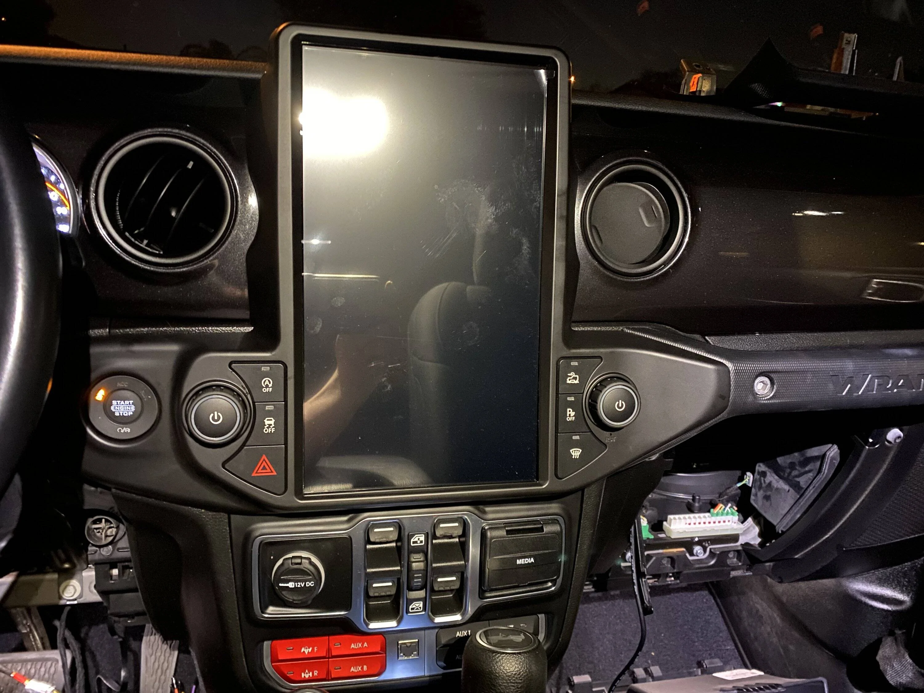

Also got the AuCar Tesla screen installed and made sure it was all working as expected.
Jeep Wrangler JL 2020 JLU EcoDiesel Build - 'Black Rhino' Photo Dec 28 2023, 7 29 37 PM
Tomorrow I'll be going through all the settings. I did the basics tonight but it got to be too cold out there. Also tomorrow I'll be getting the front fender liners installed, the Midland 275 installed and should be picking up the wheels and tires. This weekend the budget boost goes in while I wait a bit to buy the Metalcloak Lift.

Messed around with the front fender liners for hours today. They don’t fit the Sri er side due to some things on the diesel and on the passenger side they just look like crap so those aren’t going on. Instead played with the head unit a bit.

The "Tesla" screen was probably the easiest thing I've installed on the Jeep so far. lol You just need a trim panel tool or flat screwdriver to pop off the climate portion and the radio bezel. There are 5 screws to remove that you won't even reuse. Move the connectors over to the Tesla harness and and the Start Stop button and it clips back into place. My only concern is knowing how easy it is to pop off if thieves know that too it'll take 10 seconds to pop it off and disconnect the plugs and be gone.

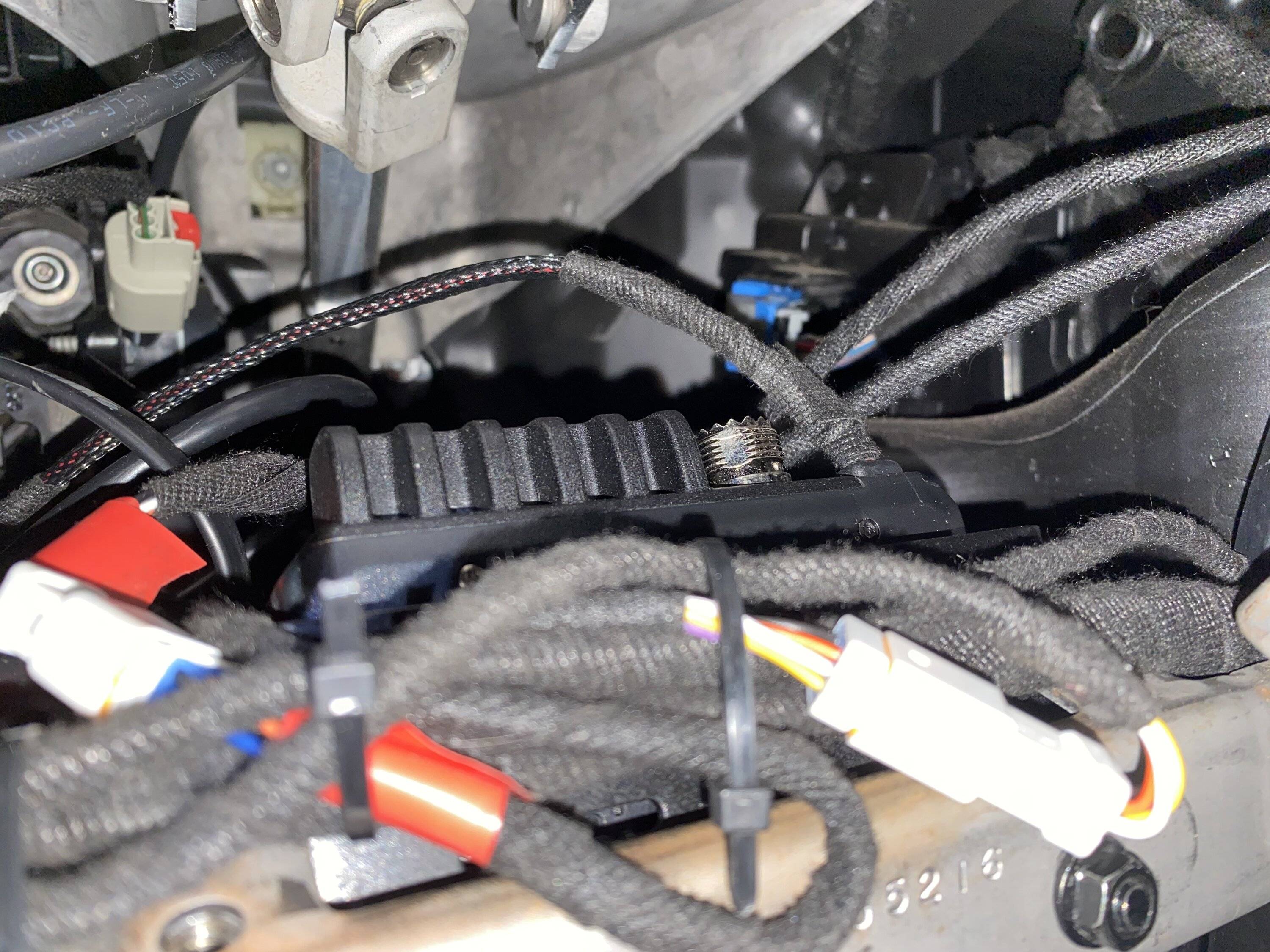

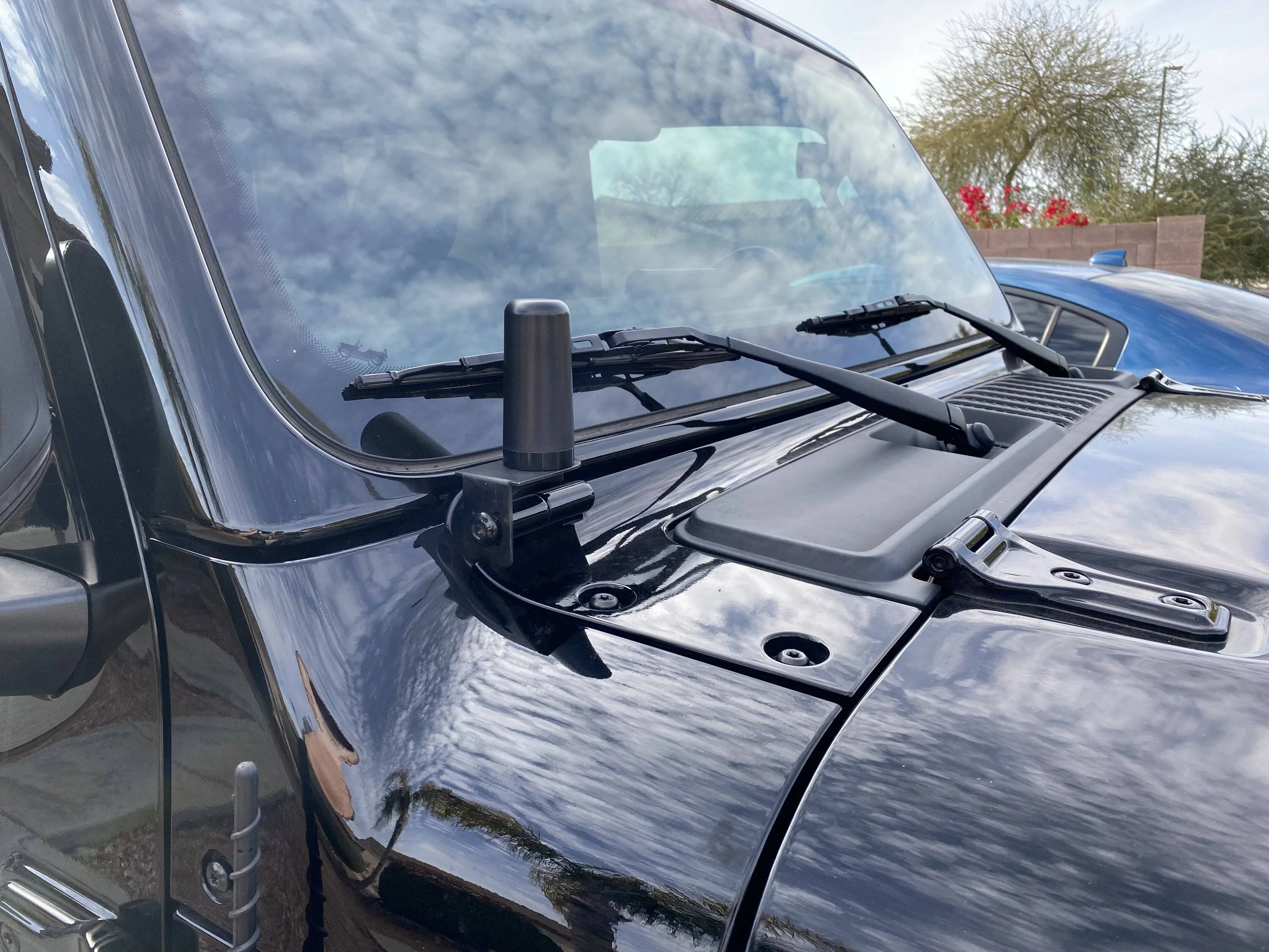

GMRS - Midland 275 installed.
Mic extension is hidden and protected from the panel.
Jeep Wrangler JL 2020 JLU EcoDiesel Build - 'Black Rhino' Photo Dec 30 2023, 7 48 45 PM
This was before tidying up all the wires and connecting the antenna.
Jeep Wrangler JL 2020 JLU EcoDiesel Build - 'Black Rhino' Photo Dec 30 2023, 7 49 20 PM

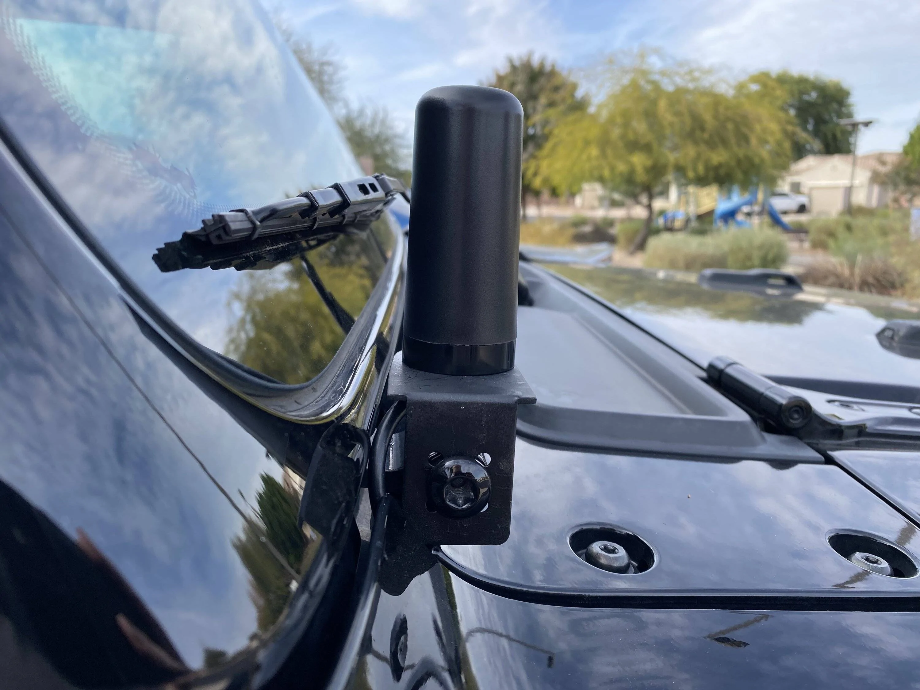

Seemed like a decent place to mount it. Made a bracket and ran the cable along the top of the firewall to the driver side.
Jeep Wrangler JL 2020 JLU EcoDiesel Build - 'Black Rhino' Photo Dec 31 2023, 1 23 21 PM
Tested it out and it's worked great. Have not tested range yet but I'm not all that worried since most of our comms are under a mile.
Jeep Wrangler JL 2020 JLU EcoDiesel Build - 'Black Rhino' Photo Dec 31 2023, 1 23 28 PM
