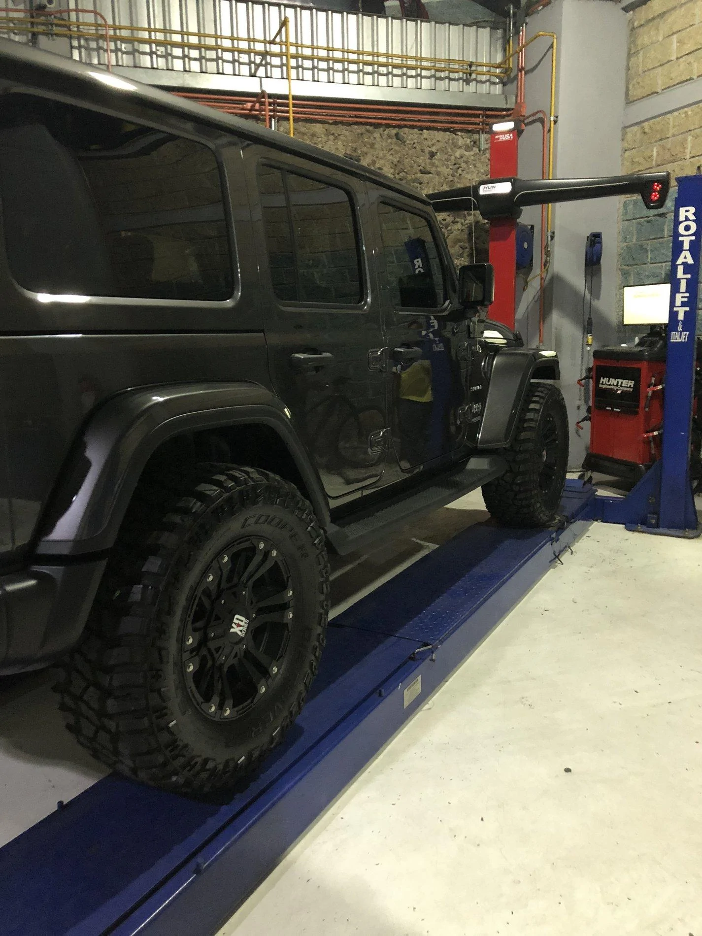

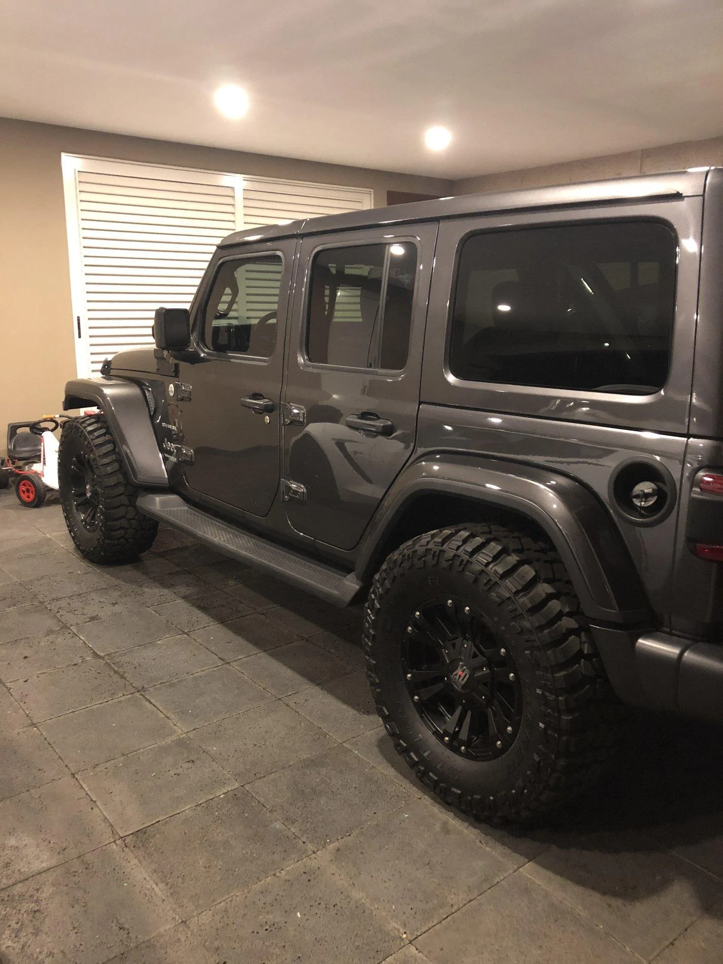

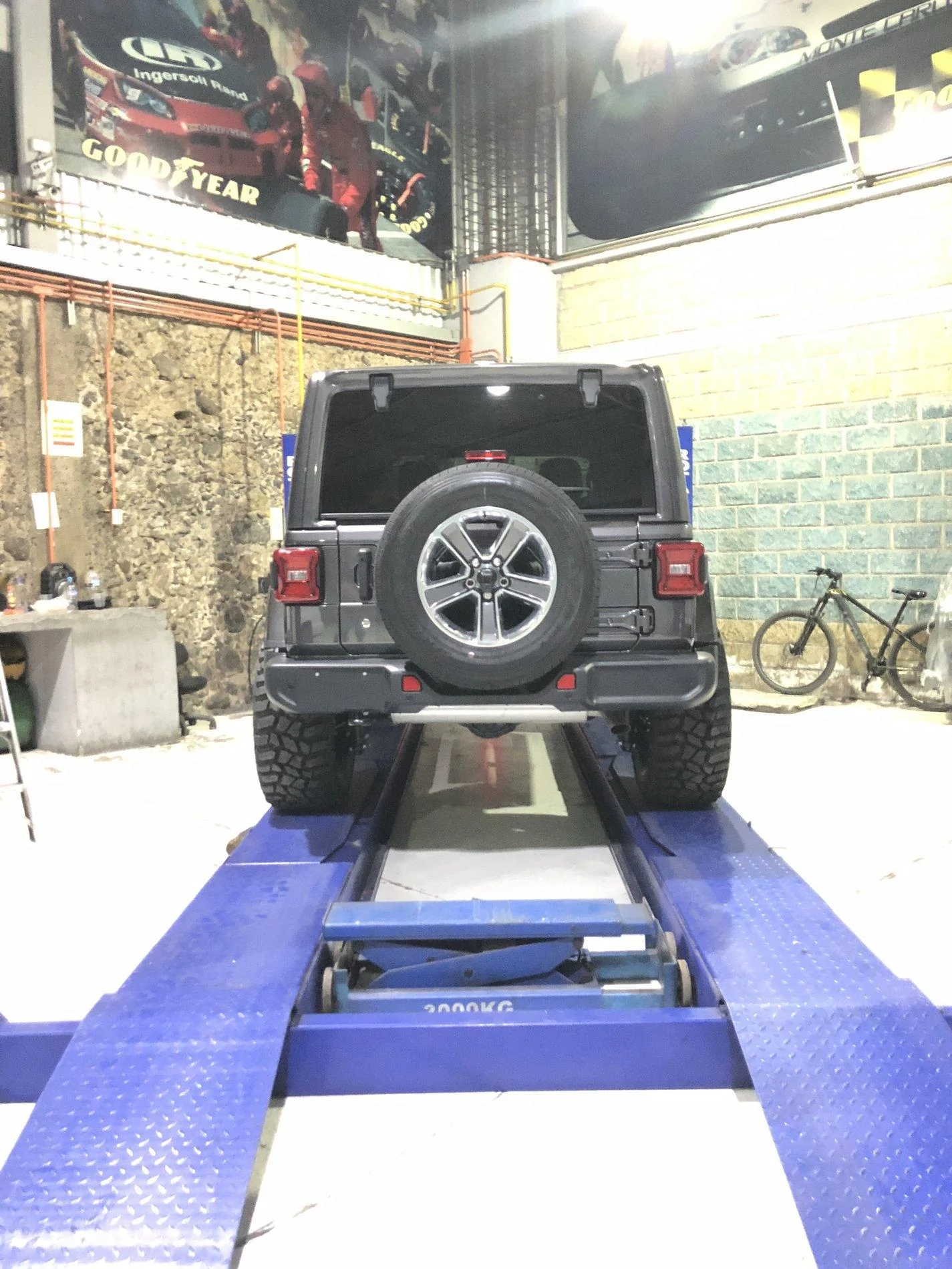

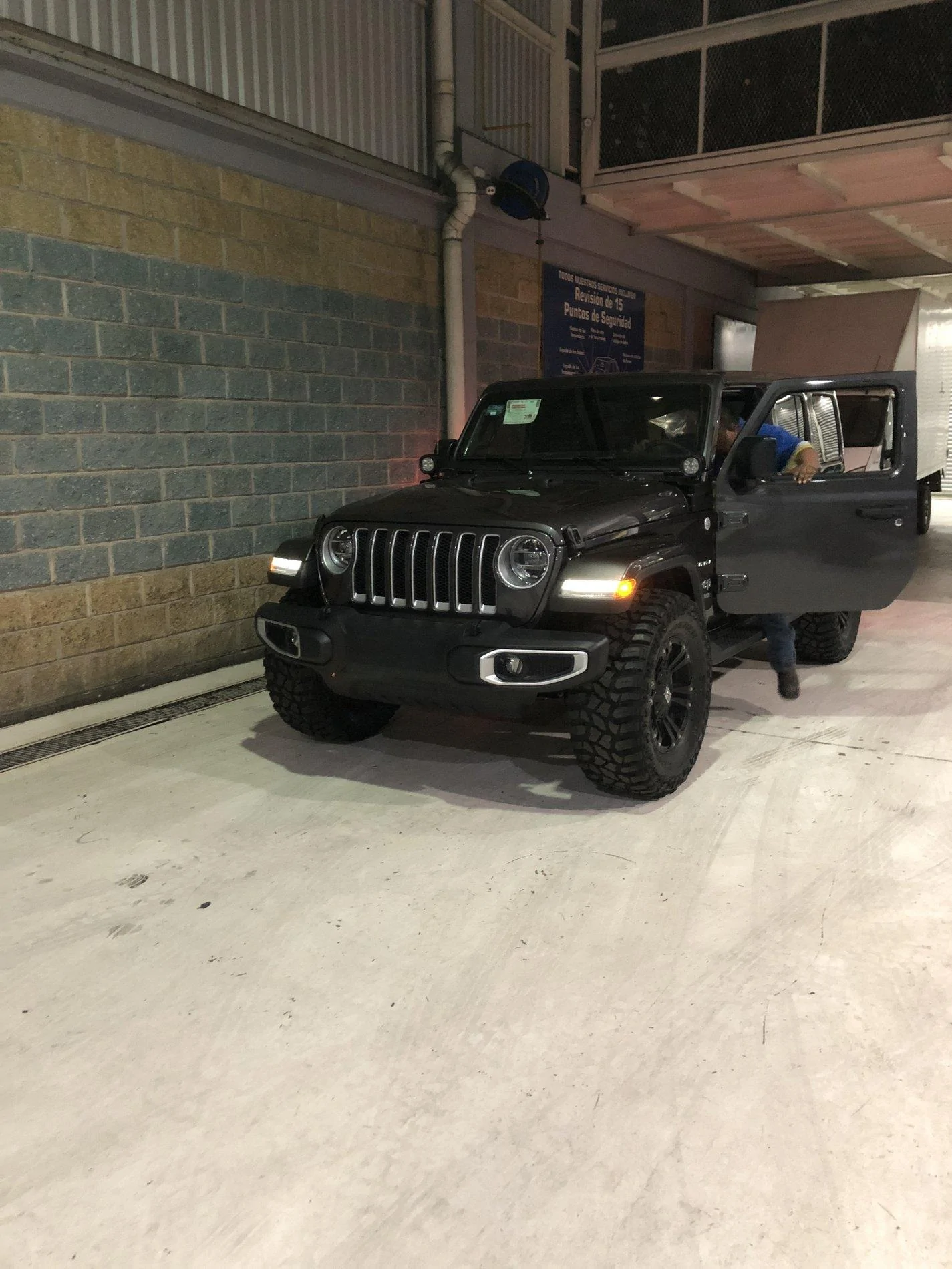

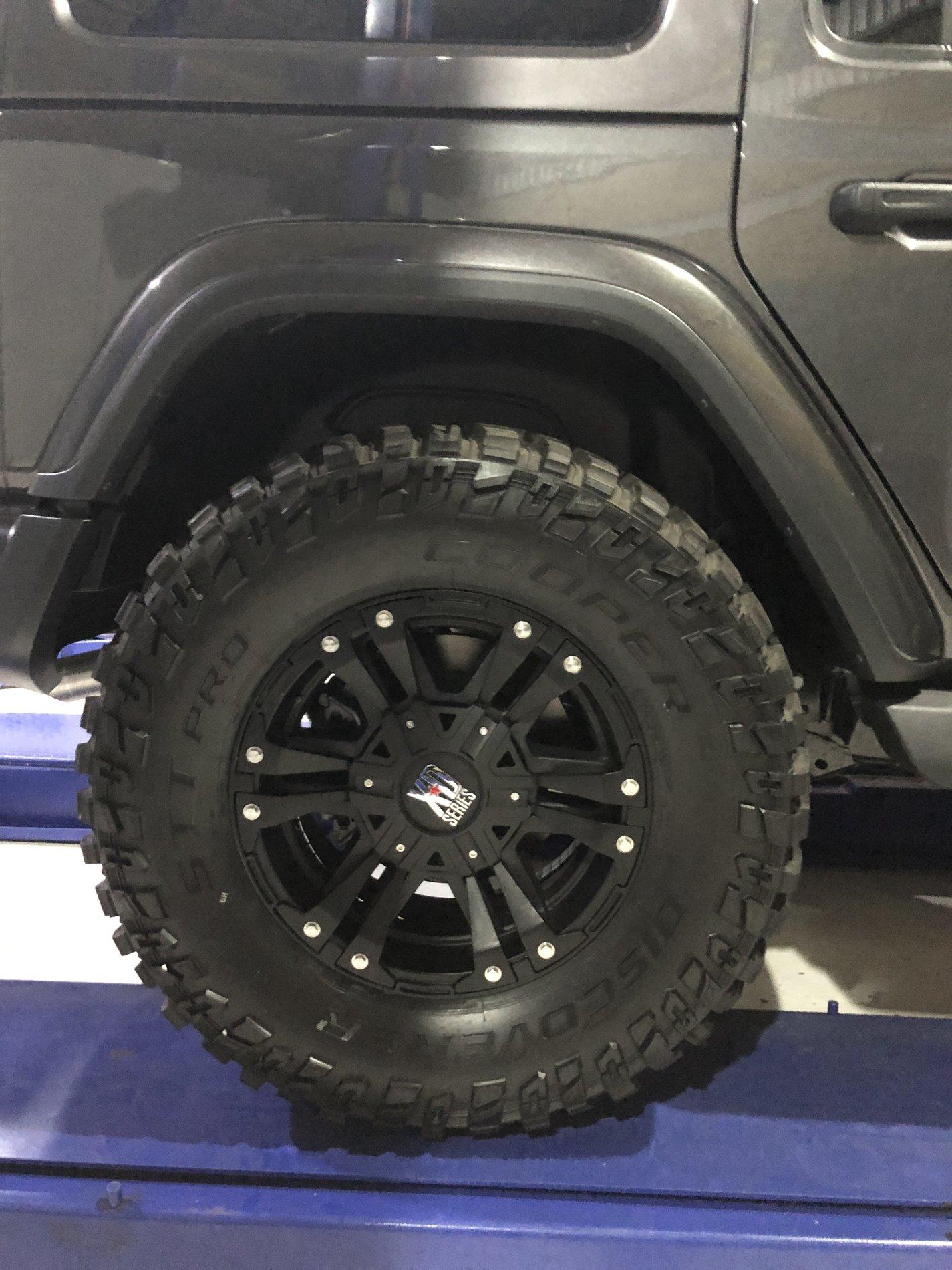

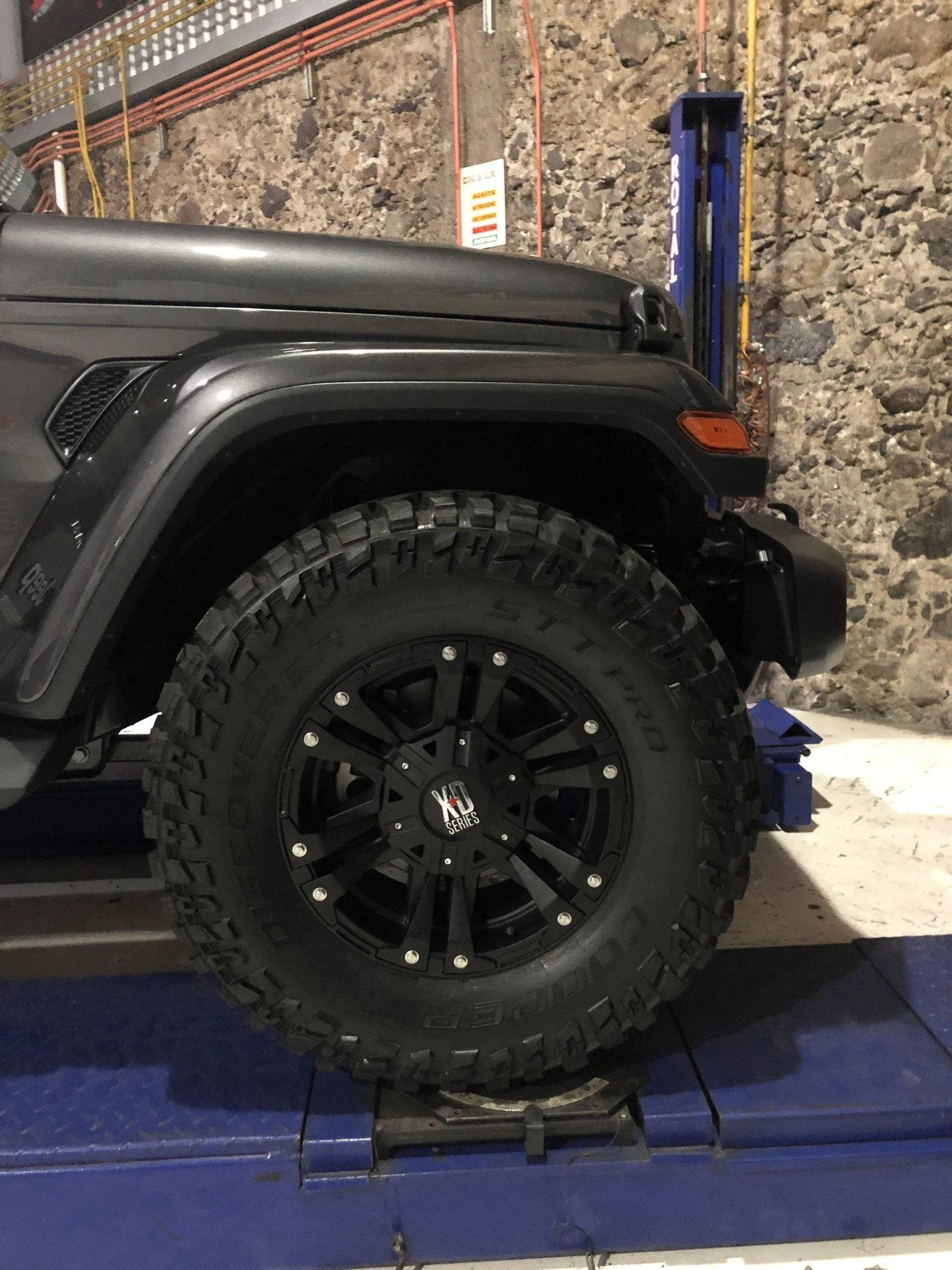

Hello Atomic Anvil,
I just got my 2018 Jeep Wrangler Sahara with stock 18" wheels. Two days later I changed wheels and tires.
Wheels XD Monster II in 18x9.0 5x127/139.7
Tires Cooper STT Pro 325/65R18
There is no rubbing at all. Ride is a bit bouncy but that was expected. Tire shop set them at 50psi (crazy high) so I did the chalk test and lower them at 35psi (much better ride).
Waiting for the tailgate support for the spare tire. I guess the stock setup won't handle that much weight. It's supposed to be 85lbs.
I have no lift but I am planning on buying the Mopar 2" lift. I really don't know why, I guess it will help on ride confort?? A little help here needed.
Hope this helps.

JL_MX I love your setup! I want this same setup on a new Rubi. I have a question (for anyone) about your Monster II’s. Most of the pics I’ve seen of that wheel are on a 17” w a (-12) offset. This seems to push the tire out nicely away from the fender lip. When I looked at the 18” version, specifically your (+18) offset, I expected the wheels and tires to be much more flush under the fender lip (which I don’t want). BUT - your picture speaks otherwise! It looks like it sticks out just the right amount. But I can’t figure it out (-12) To (+18) is a 30mm difference, well over an inch. I would expect to see the 18” wheels tucked in much more because of that. Can anyone smarter than me please explain? Lol Thank you in advance. Basically, I just want to make sure that if I order the same setup as JL_MX that it will still stick out a bit. Maybe it’s bc of the 325 tire width? Ps - first time poster here, please be kind. :)
