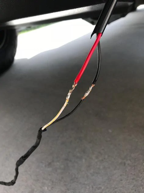

Not a direct answer but maybe an option. I received my rockhard4x4 bumper a few weeks ago and found my sport fogs would not fit. Upon discussing with them, they were not aware like most that the sport halogen and rubicon leds had different mount bracket styles. Long story short, I traded them my factory fogs to used for making an adapter bracket for their customers in exchange for a set of JK model KC LED fogs. The JL models from KC are not yet available but the JK model was so close that they bolted right up without issue. Hopefully this gives you some ideas if you can’t find the factory rubicon models.

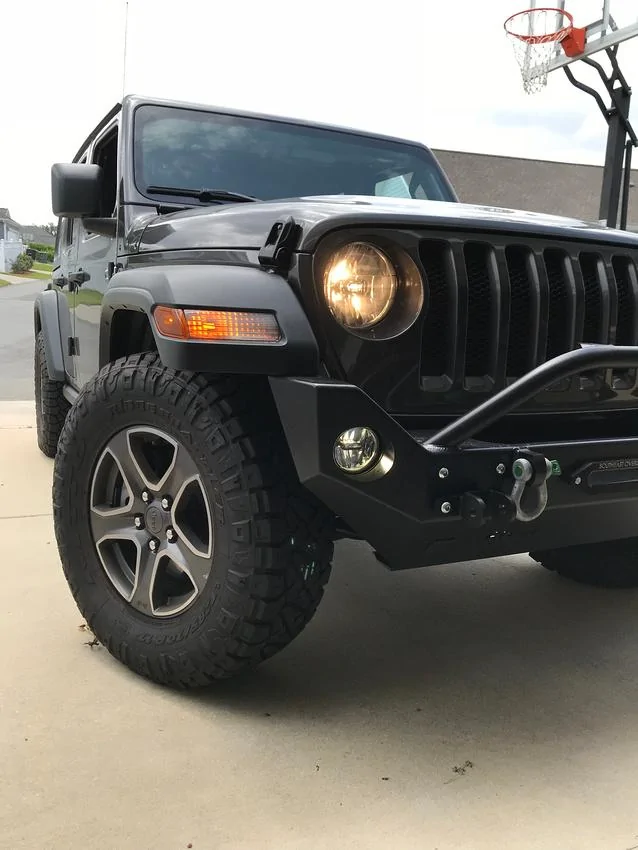

Mounted and good to go

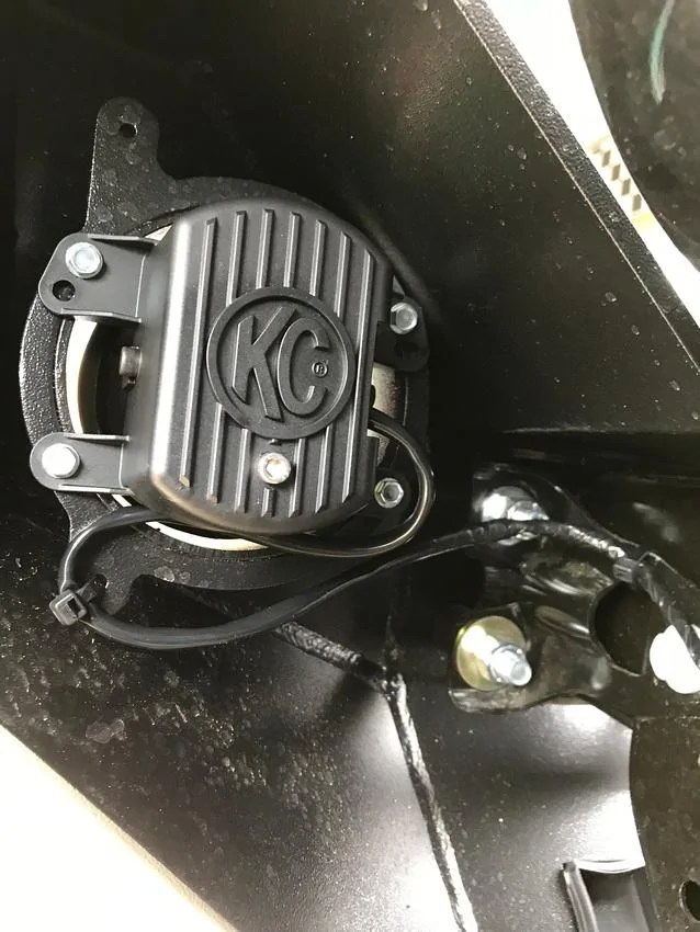

KC lights screwed in

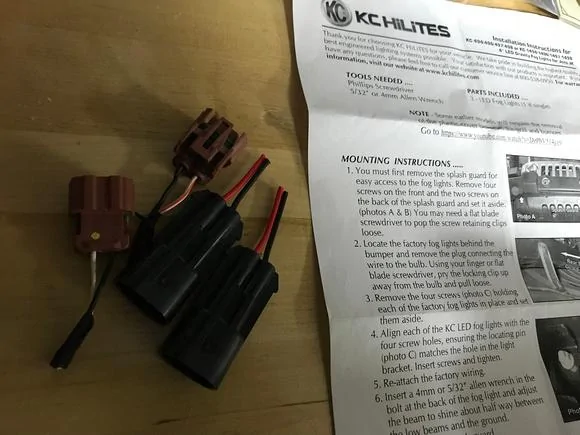

Sport harness plug vs KC’s JK harness plug
Jeep Wrangler JL WTB: rubicon led fog lights p2832738845-3

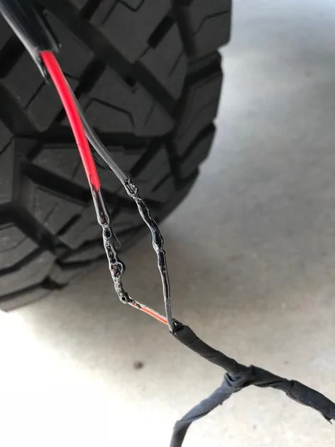

Crude, quick solder job with mini torch, but it’s a solid connection now

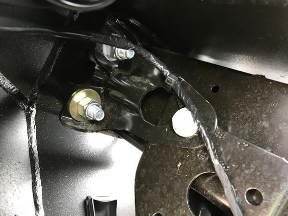

Hard to see but here is splice area fully taped from jacket to jacket and then zip tied across back of the sway bar which is protected by the bumper skid and stays out of way of winch mount area.

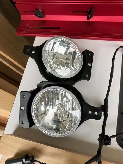

Sport factory halogens
