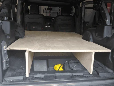

I am designing a Jeep Camping Sleeping platform designed for an optimum balance between comfort and storage. Check it out if interested. I am open to any tips you might have.

I'm going to approach this project soon - what tweaks/mods did you make? Any other tips having actually built it?Took me about 2 hours to make. Works well. A few mods to make it fit right. Cheap and easy fix.
I made it an inch or two taller for more storage. The tweaks were most just an "adjustment" here and there to fit the tolerances of the space. Other than that followed the plans.I'm going to approach this project soon - what tweaks/mods did you make? Any other tips having actually built it?
Yeah the height has been a consideration for me. I'm 6'1", so I was actually thinking about lowering it ~1-3 inches to try to give myself room to actually sit up "in bed", but I don't think it'll work that low.I made it an inch or two taller for more storage. The tweaks were most just an "adjustment" here and there to fit the tolerances of the space. Other than that followed the plans.
