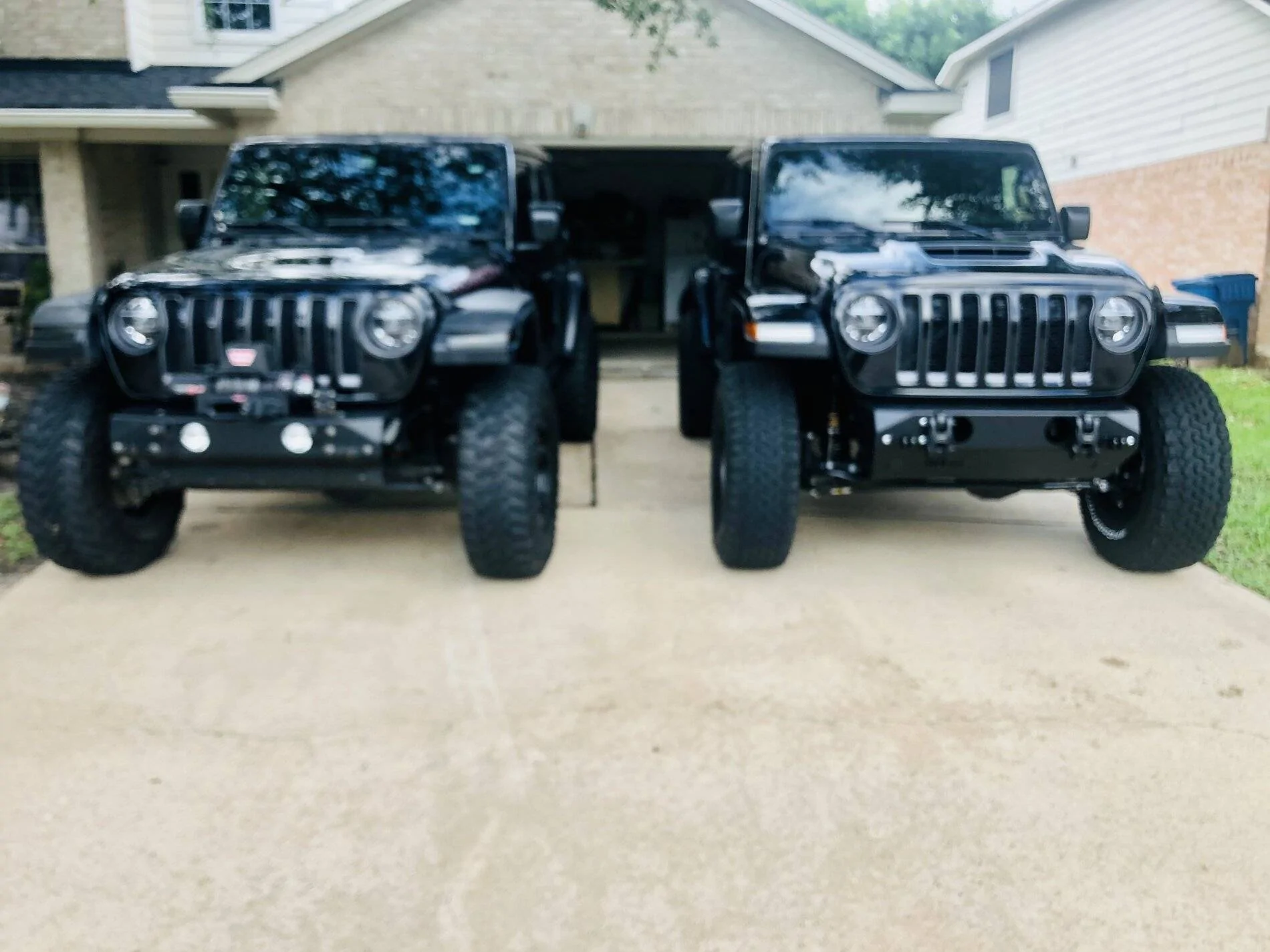

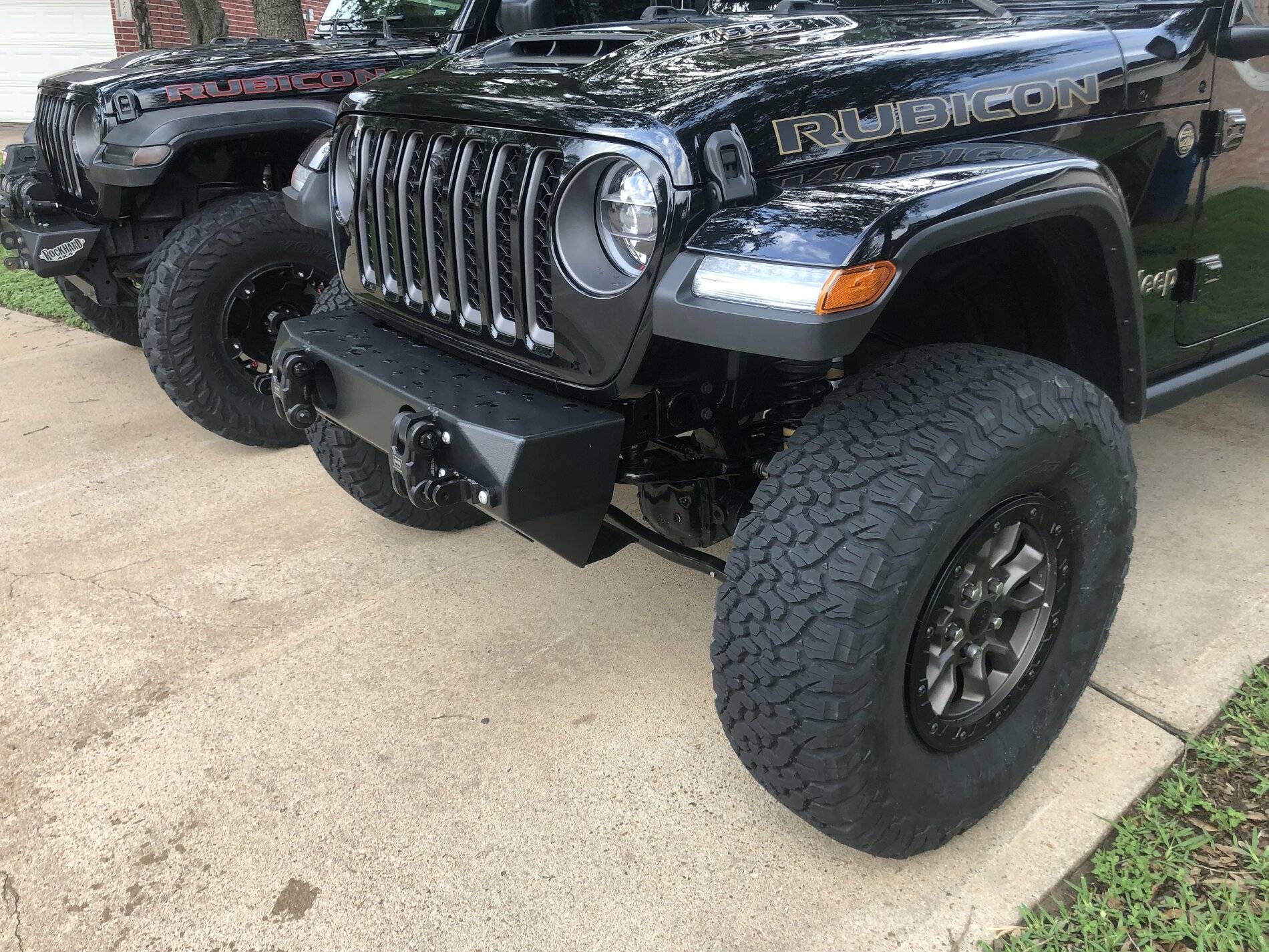

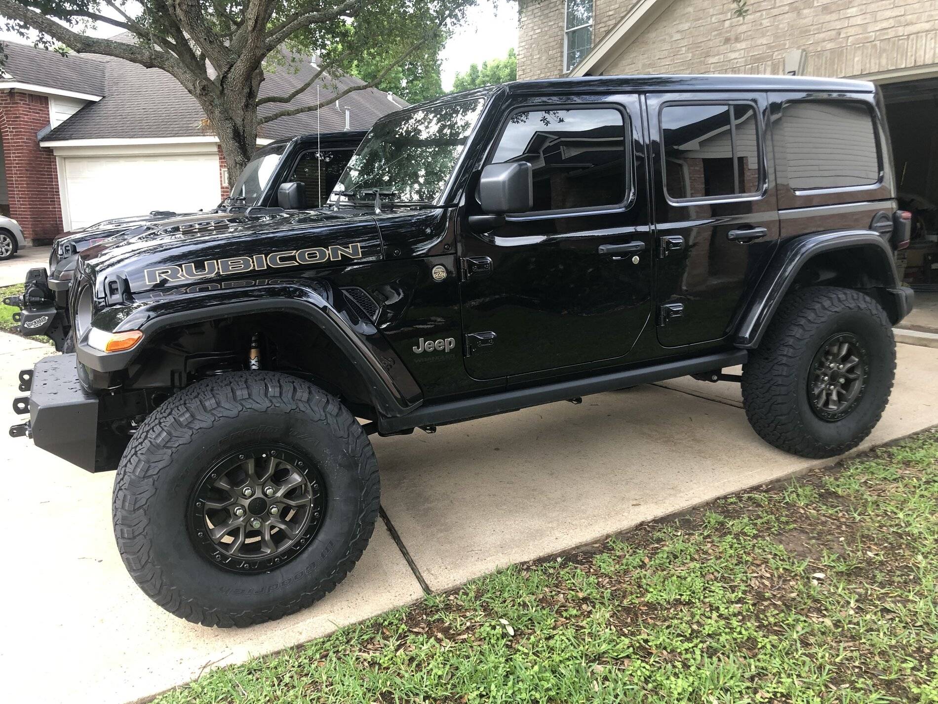

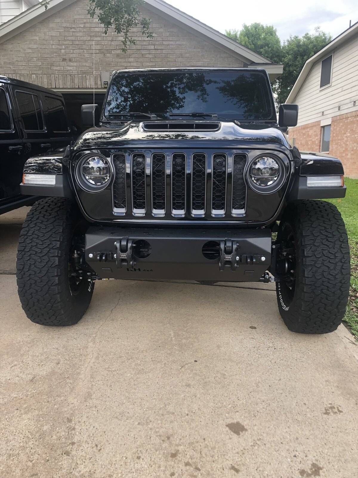

Tera Fkex ST1 Lift, 1.5 spring spacers/ bigger bumps stop. Rock Hard Aluminum freedom series bumper, RH sway bar motor skid plate, RH front axle motor skid plate. and artic spare tire delete kit. Lost about 200lbs wish my diet work as good. I will through my spare tire in the back if i doing any 8 plus trails. Next week will install shock extensions, longer sway bar links, new rock sliders and ridged amber radiance pods in the fog light holes.
Tuesday she goes to get xpel wrap and ceramic coat/wax.

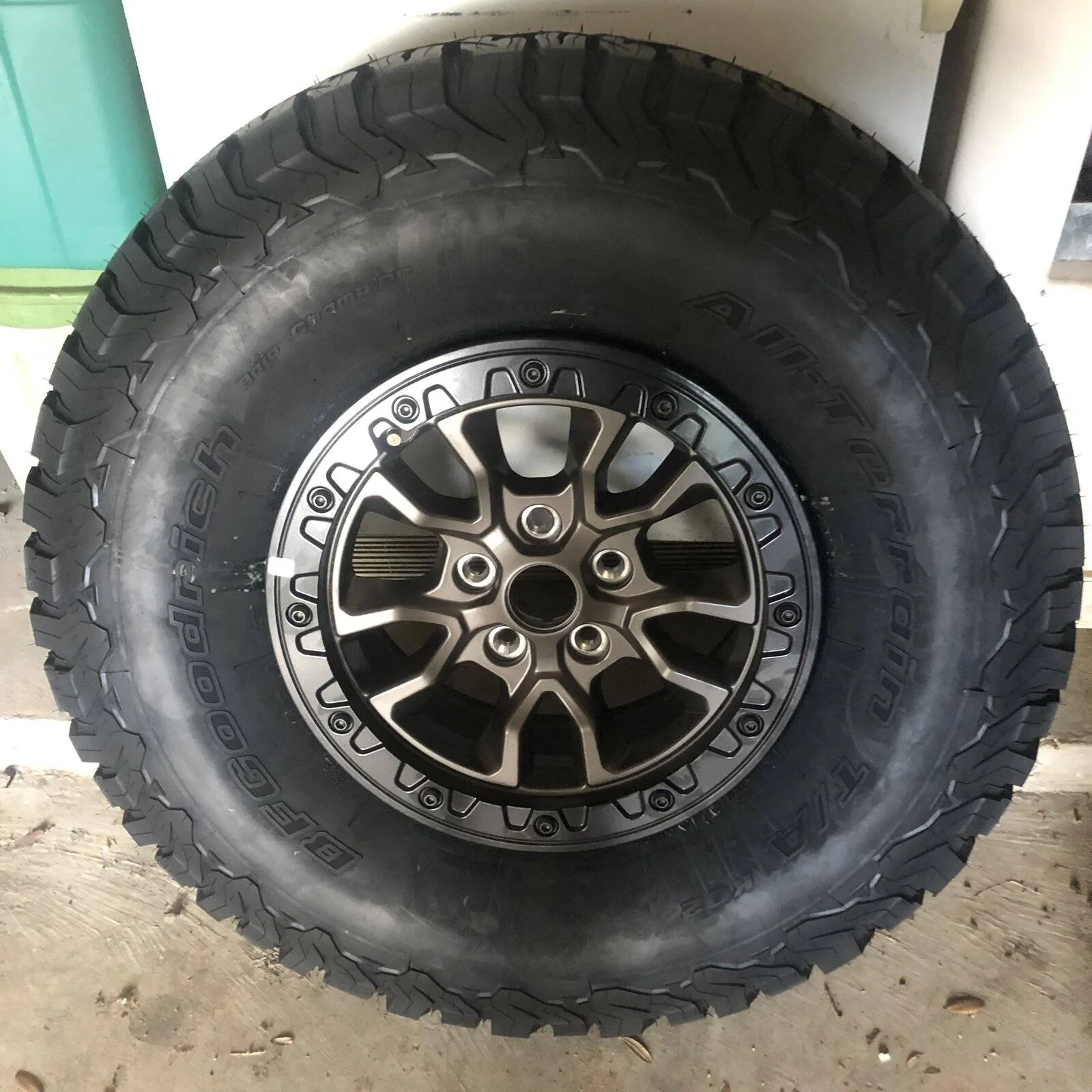

Right to it, :captain:. I've come to really like it in black, looks great. I'll be Following this thread, it will be interesting to watch your build. Looking like another 2-7 day until mine and I would still love to see a picture of the specs on the back of the rims if you wouldn't mind.

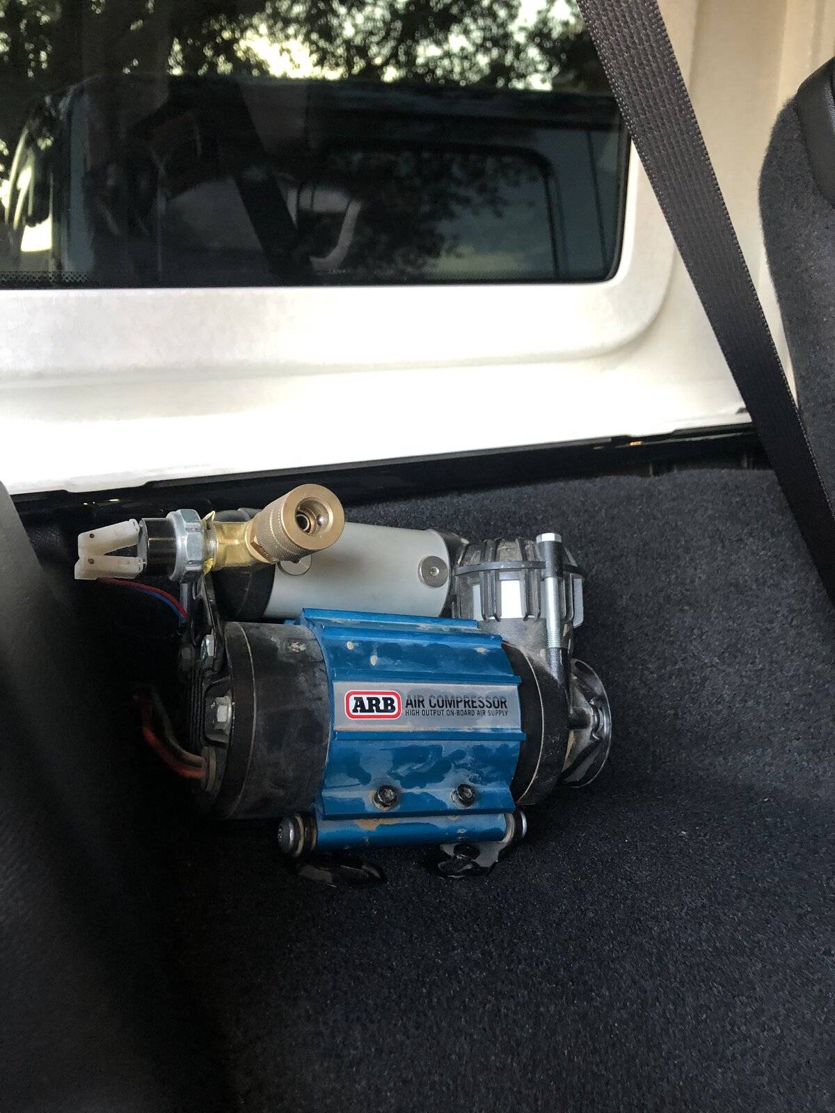

I read "gave her some air" and looked for modifications to give your 392 better breathing, but didn't see any. Did you mean that it was sitting higher with the lift/spacers?
Oh yeah I forgot to post that pictue, it gets enough of that air LOL. Installed ARB air compresso.

Is it me or do your wheels look weirdly small in those 37's? I know its a 17in wheel but in the first pic it looks like a 15in.
It may just be the angle of the picture.

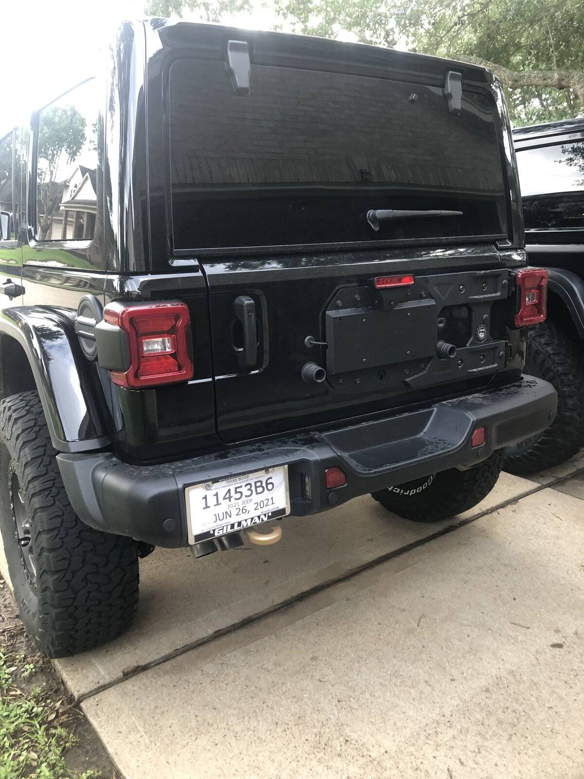

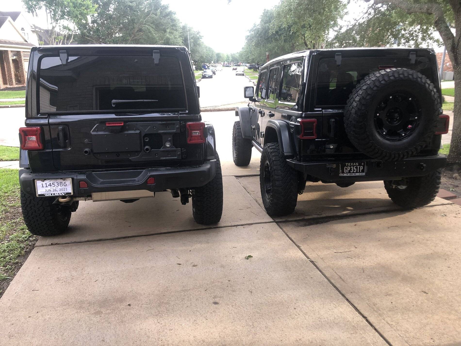

I think I've been in Law Enforcement too Long, so you can take this advice, or not.
Put in photo's, with your license plate blocked.
Really nice looking Jeep, lets hope the wrong guy, doesn't thinks that also.

Law enforcement aside, why? You drive all day with your plates showing, how is that different from showing it on a forum.
Wider audience! Do you drive into area's where there have been carjacking's, or do you avoid them?

Are you using anything to increase the width of your setup other than the spacers for your wheels? I really like the width of yours in these pics. They seem farther outward than I would have thought for just a wheel spacer though. You did say 1.75" spacers in your original post, correct?
I guess the tires are an inch wider as well, maybe that impacts the look of the "width" too. Really looks nice though man.
