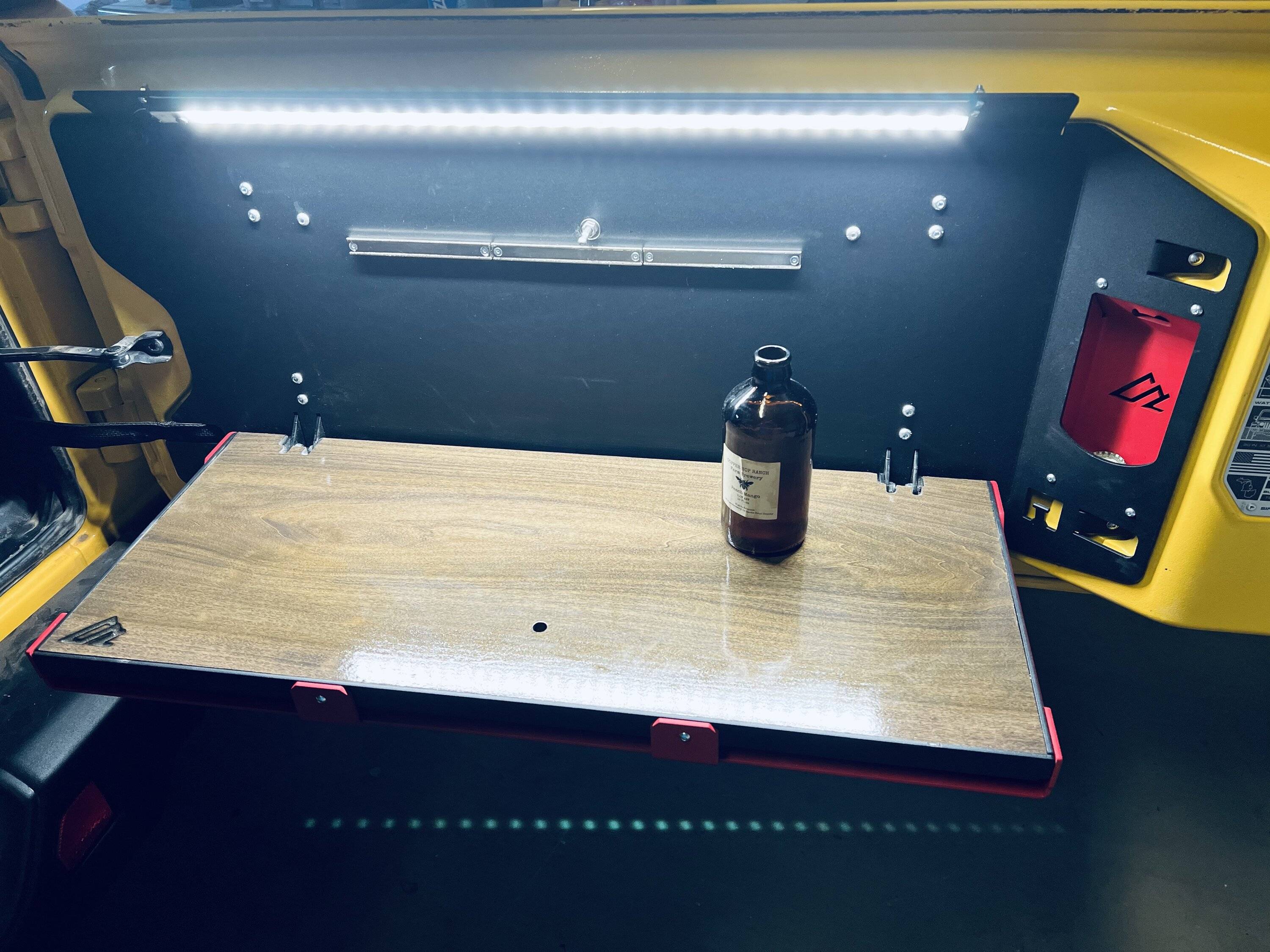

TAILGATE TABLE LIGHT: This is a switched 12v light that is part of my AAL Versa Table. I want to be able to turn it on/off when the Jeep is off. The manufacturer's instructions says "Everyone has their own way they like to wire-in accessories, so we leave this step up to the installer's discretion." ?
They also say "Most people simply tie the surface light into the rear 12v Port power."
I haven't found much information on wiring solutions at the rear of the Jeep for this objective. Is there any "always on" source of power in the vacinity of the right, rear tail lamp side of the JLUR? Or is the only viable / most straightforward solution to run the wiring over to the left side to tap into the 12v Port?

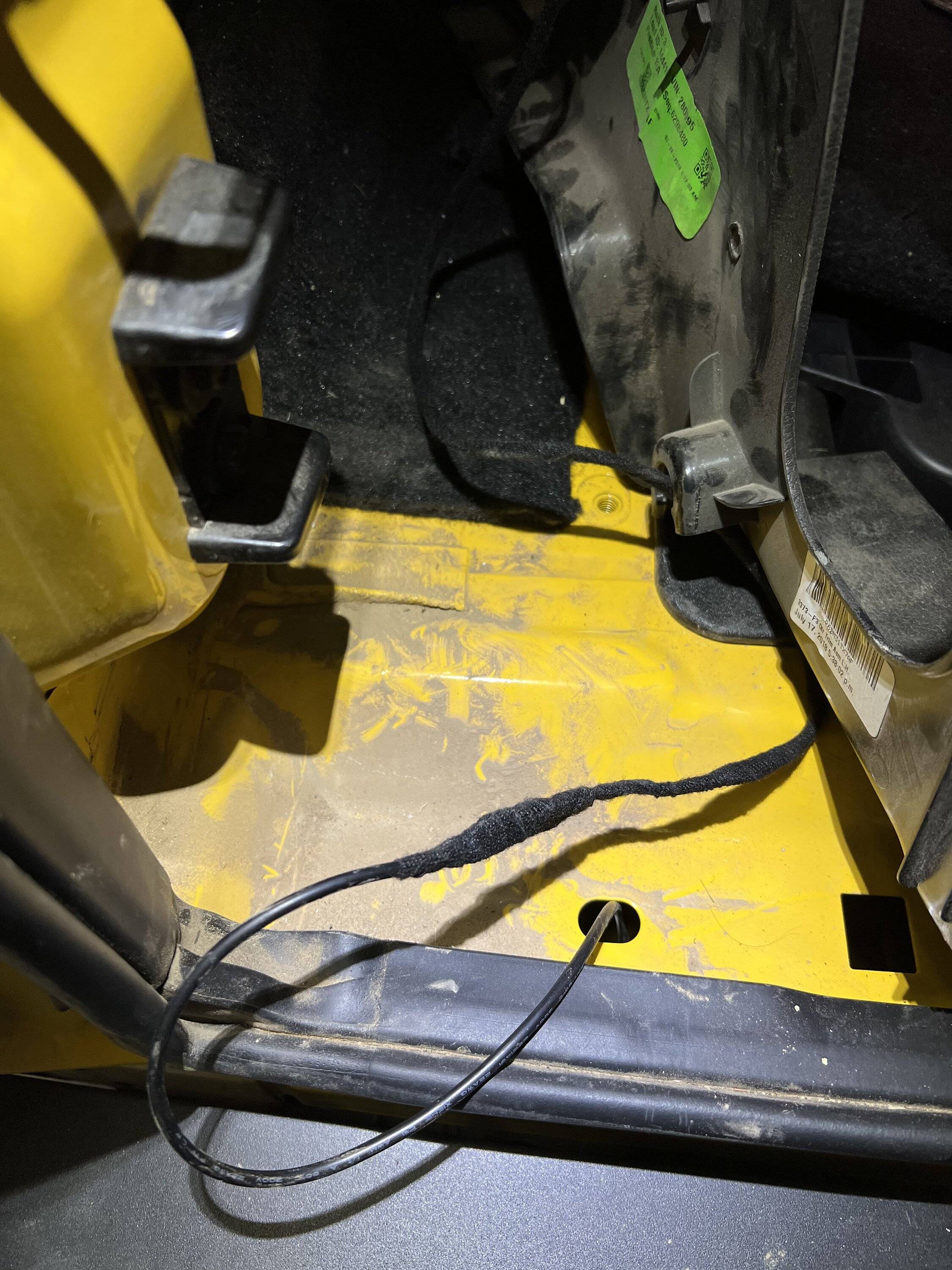

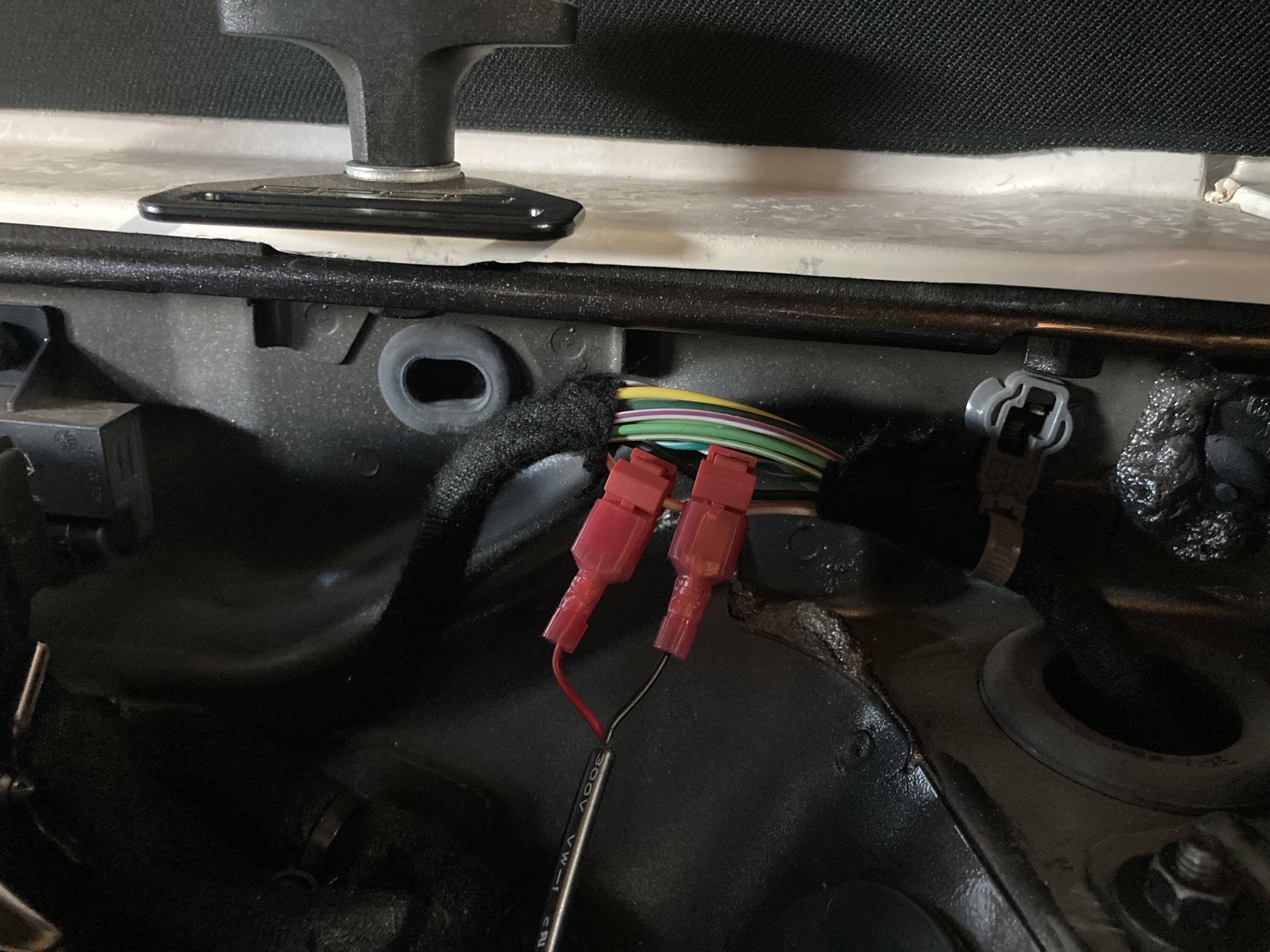

For anyone who searches and finds this thread, here is what I learned:
LICENSE PLATE LIGHTING:
>> I successfully tapped into Jeep-side of the Right Rear Tail Lamp harness using:
POSITIVE = White Wire w/ Orange Stripe. (RIGHT SIDE MARKER CONTROL).
NEGATIVE = Black Wire.
>> I have not received any Warnings that my JLUR recognizes that I am not using the original wiring circuit for the OEM rear bumper license plate lights. I was driving for weeks without any license plate lights, and nothing seems amiss with this solution.
>> The thicker wiring harness is near the top of the area under the rear panel, between the roll bar and the grommet that leads down to the tail light. (see pic)
>> You do not need to remove the rear tail lamp. (I did just to figure out which of the wiring harnesses I had to unwrap to find these wires.)
>> It was very useful and reassuring to have a Power Probe to verify the White/Orange wire was correct when I turned the headlights on/off.

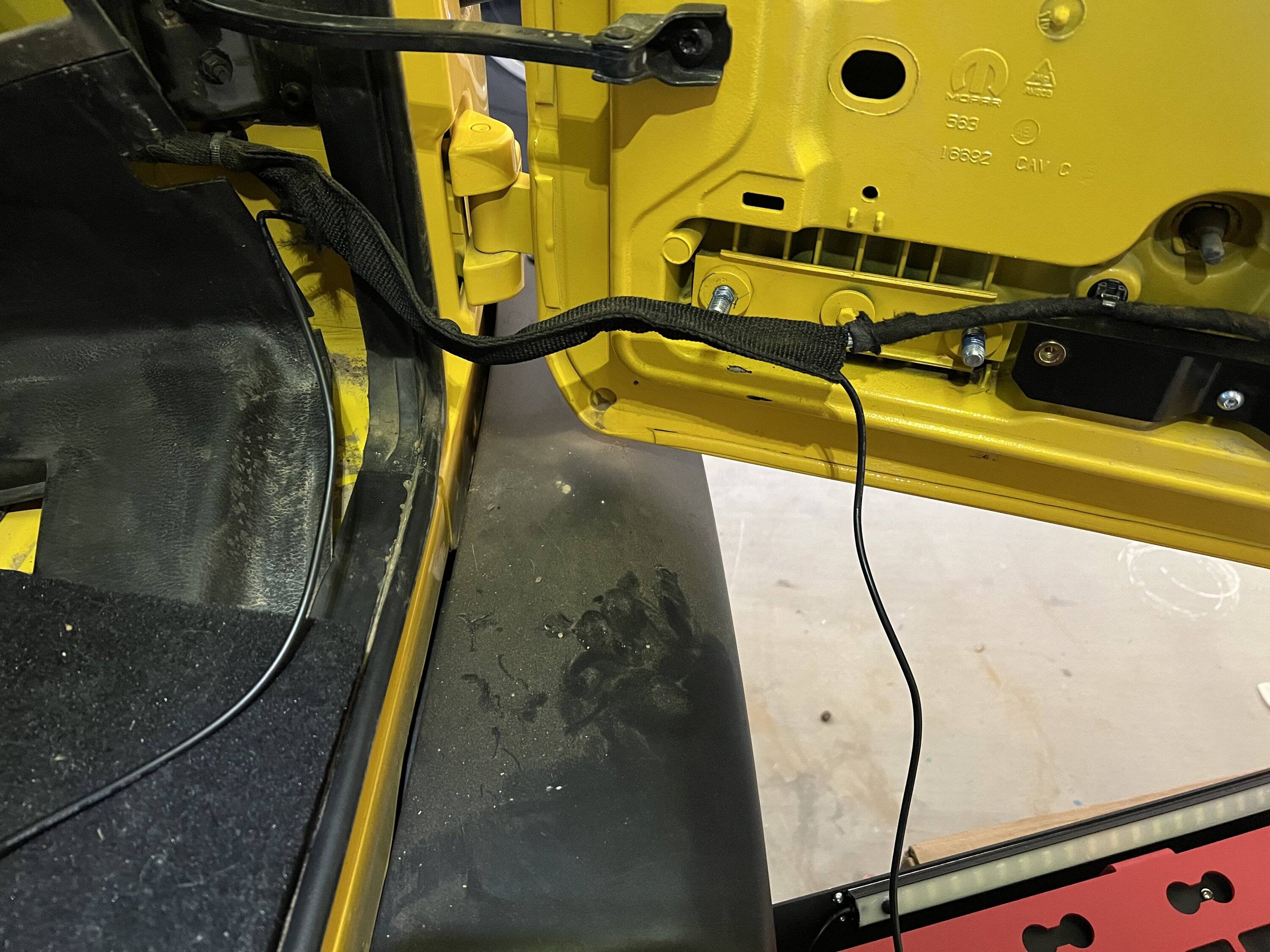

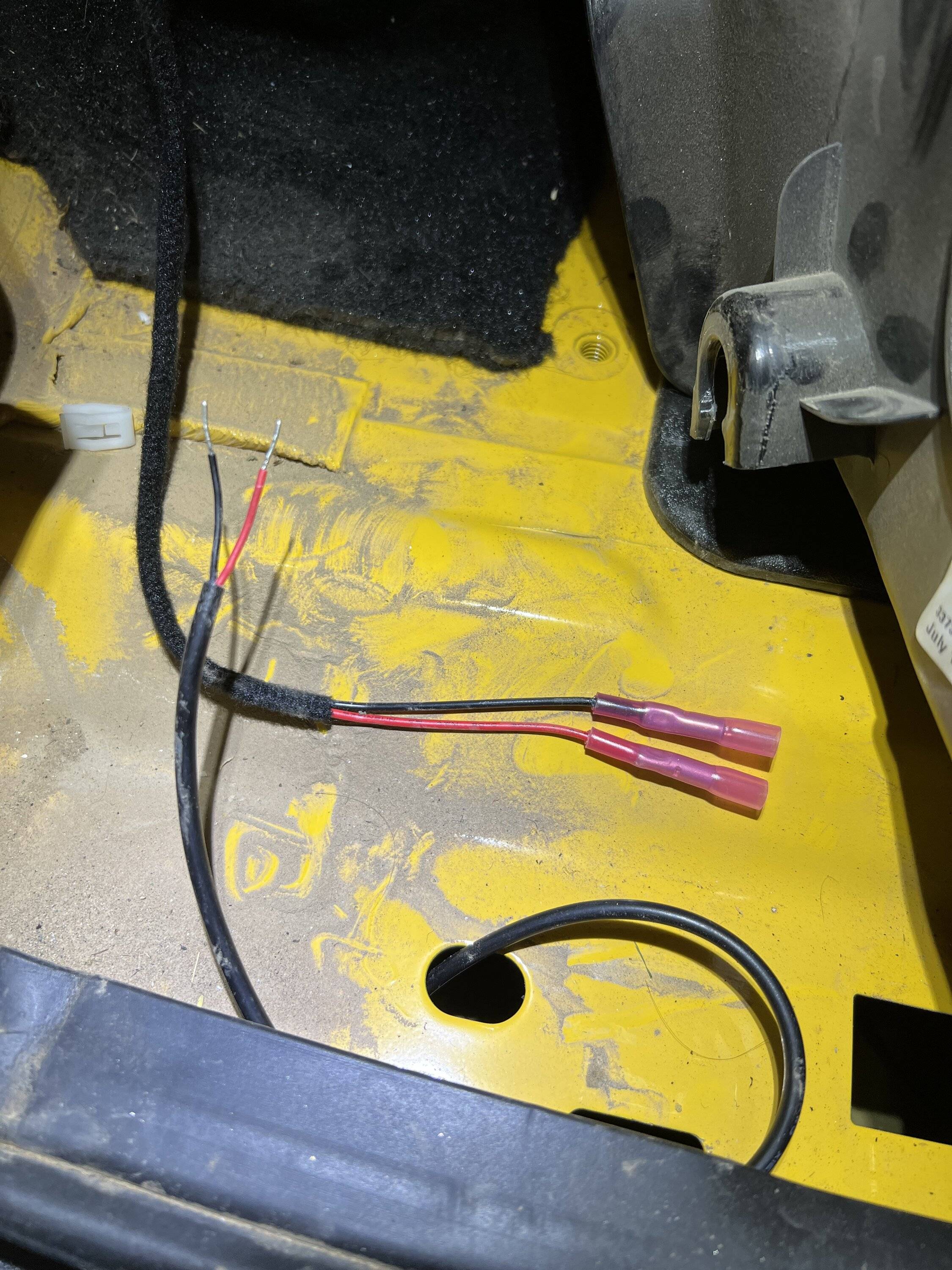

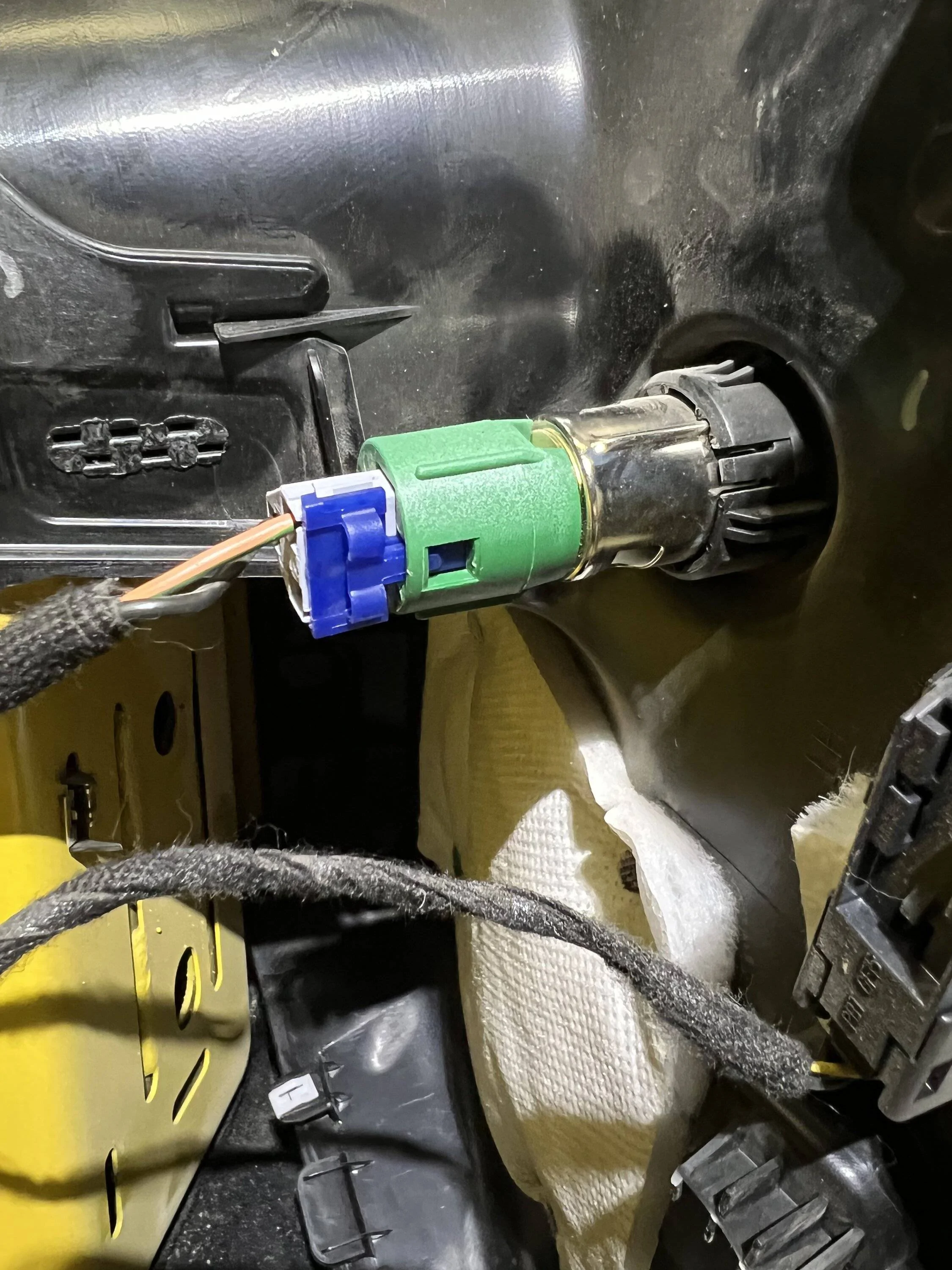

TAILGATE TABLE LIGHTING:
>> I never found any information for an “always on” source of power behind the right, rear panel of the JLUR. Therefore, I just ran a wire over to the left-side and tapped into the 12v Port. I used an extra length of wire in case I decide to establish a 12v power distribution panel somewhere in this vicinity in the future.

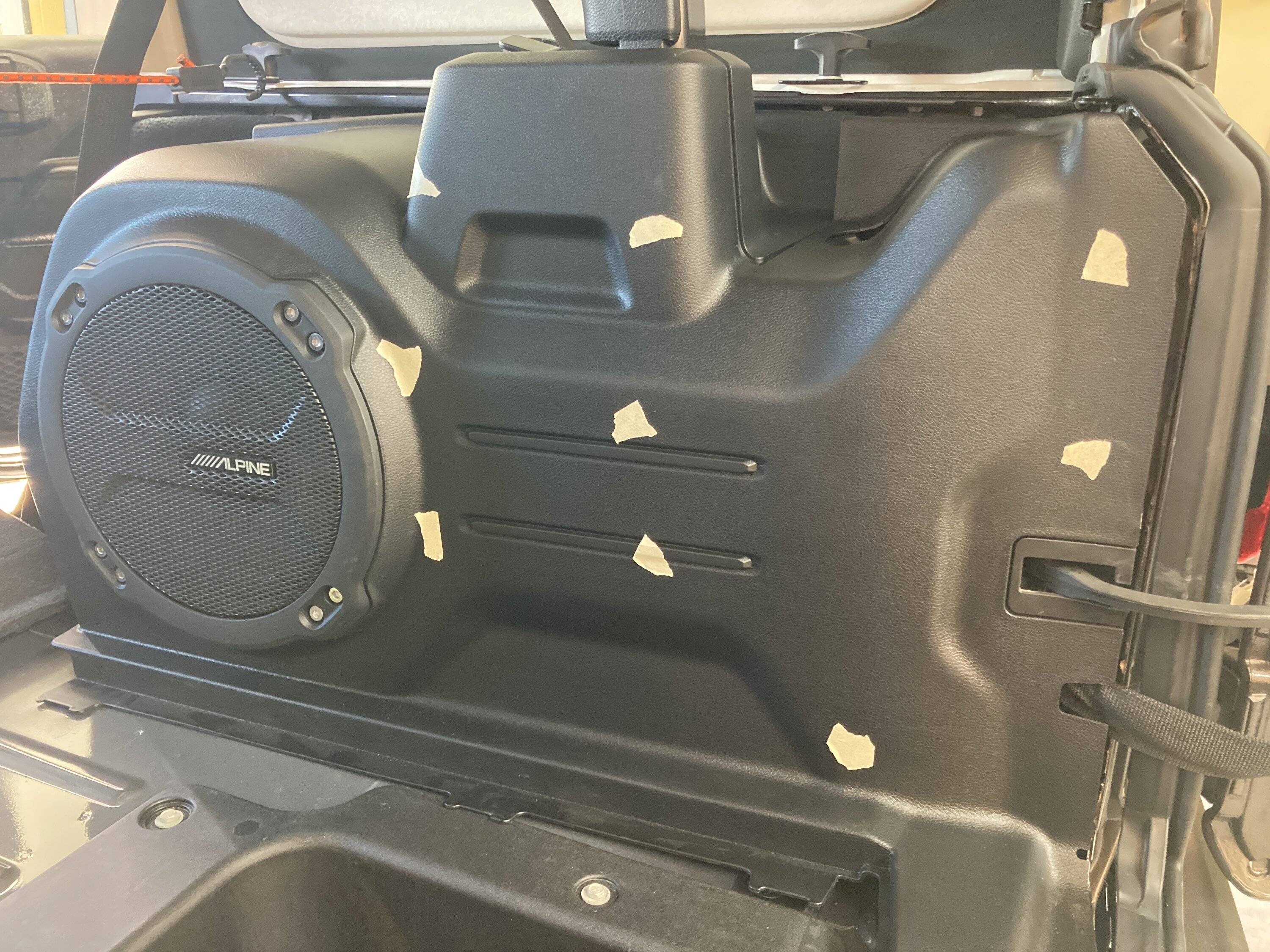

REMOVING THE REAR INTERIOR PANELS:
>> I found this video the most useful.
>> If you have a JLU with the Subwoofer, there is a T25 screw that needs to be removed on side of the subwoofer near the back seat.
>> Once I had the panel off, I found it useful to mark the connection points so that I knew where to pound when reinstalling.

Fudster, it also became apparent to me during this project that this rear cargo plug is "alway energized" for my 2022 JL. I didn't have to mess with any fuses.
In fact, I noticed that the plug's cover has an image of a Battery - representing that it is connected directly to the battery. Contrast this to the plug upfront near the driver, which has a Key image - representing that the 12v is only available when the ingnition on.
