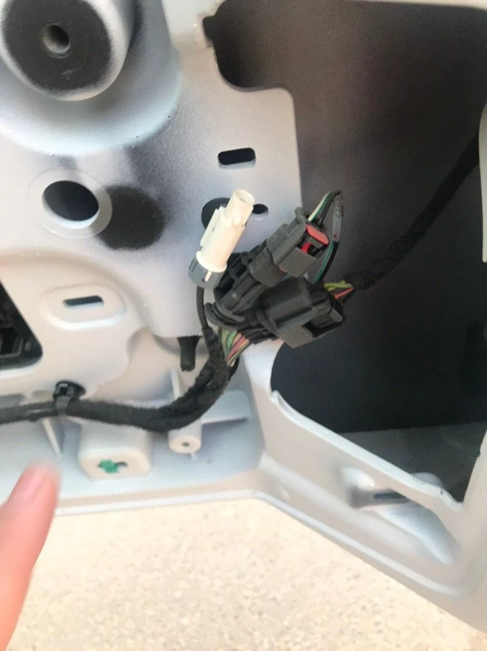

Hi, I opened the Tailgate cover in my JL Sport 2020 and found these wires , what are they for? I hope it’s for the backup camera because I really want to install it
The white wire is for a backup camera.

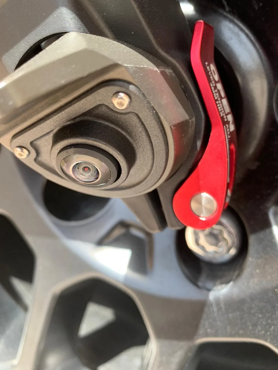

Well I took it to the dealer to program it and it worked fine, camera cost me 90 USD and installing + programming it was 100 USD, the funny thing is when I contacted the dealer before they told be it would cost 1200 USD to install
