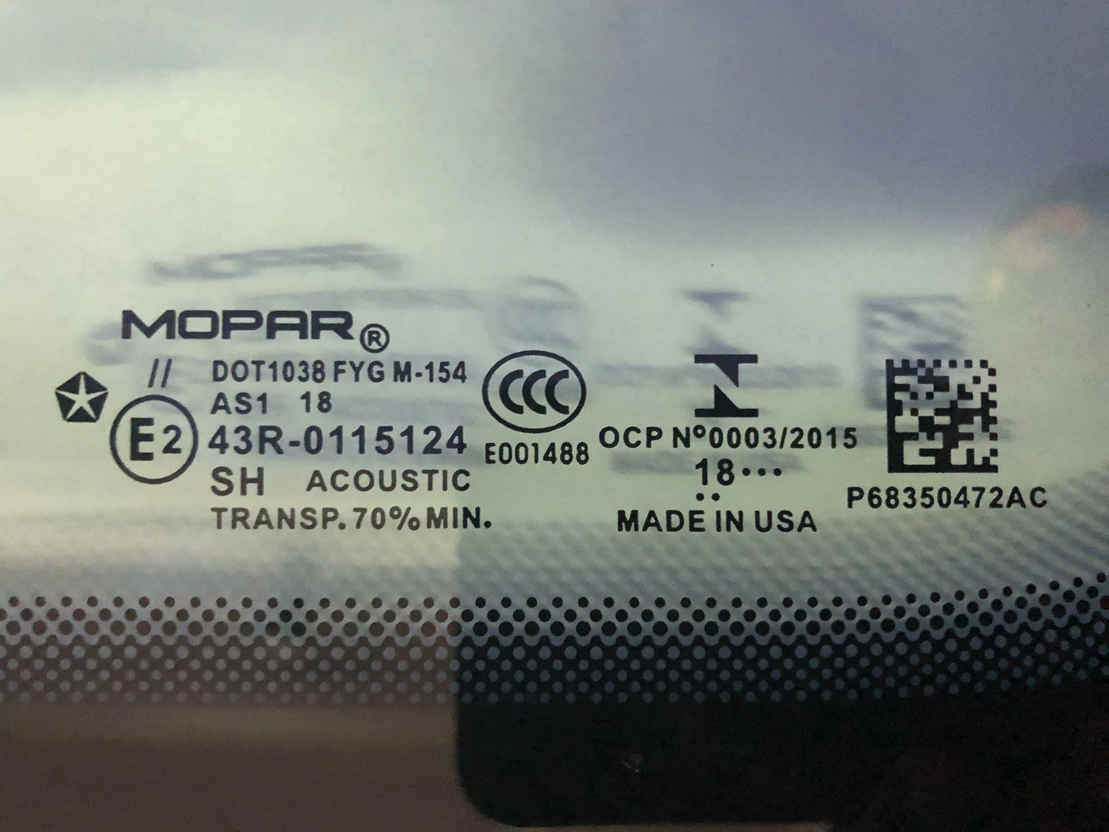

Rob, when you get a chance, could you please take a decent picture of the markings on the windshield and post here. You will find, on lower corner of the windshield. I would like for my JL data base and I'm sure other's he, would also like to see the markings;
Not a great picture, but legible...
