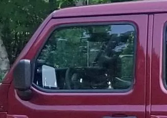

Happens sometimes, nothing more than an eye sore.. Wait for a hot day and fool with it to get it's shape back. Or heat it with a hair dryer and reshape it.

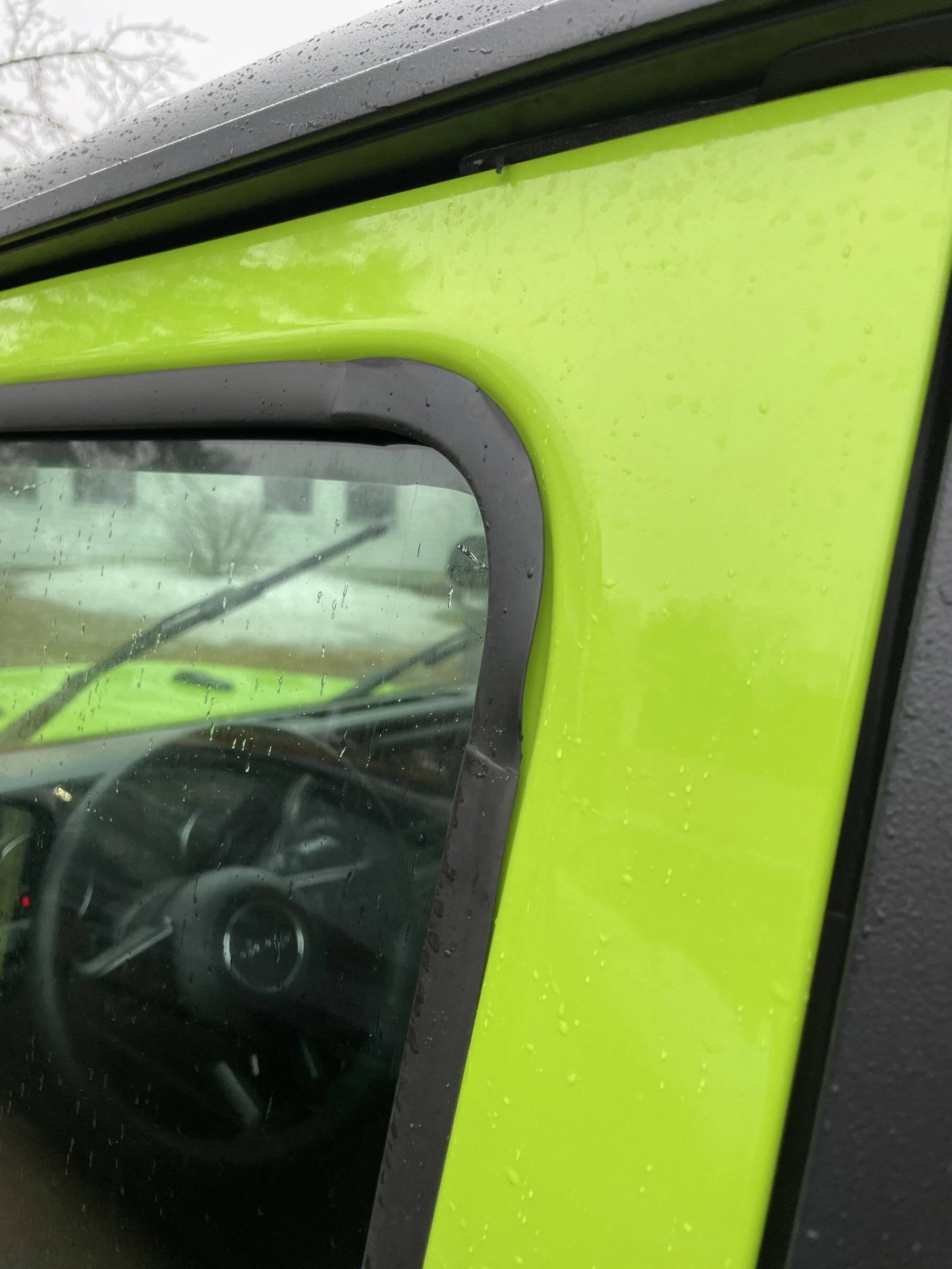

Weatherstripping is not hard to handle if you just want to replace it. The worst part is removing the inner door panel to access any hidden pins. My half doors had two pins that were under the panel. I don't know if full doors do as well.
