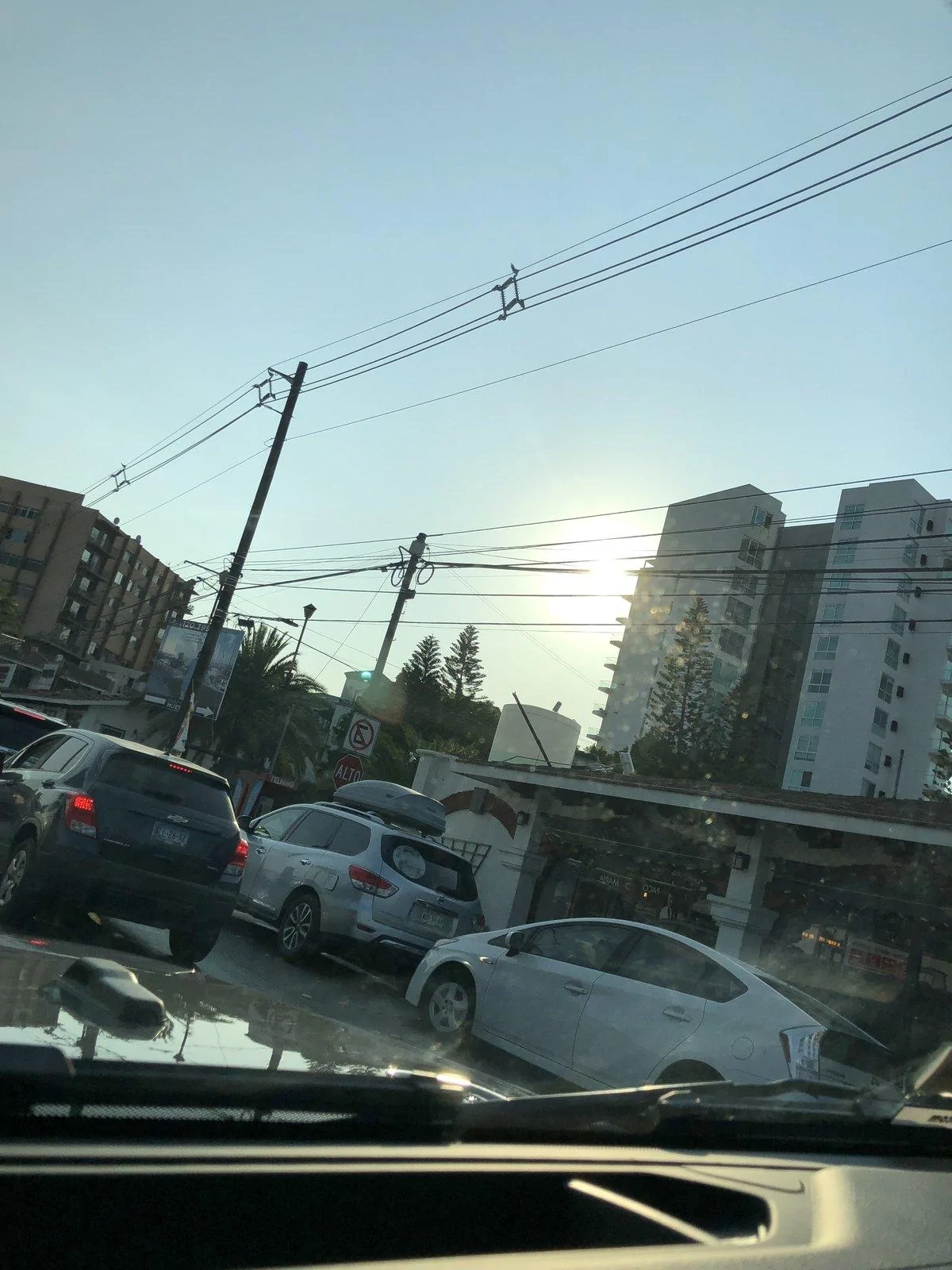

Ok I know it sounds stupid but,
i Can’t totally clean my windos,
I clean them with water then with special window cleaner but still has watermarks, little waterspots all over window, heres a pic.
Its hard to look at it but its there
How DO YOU CLEAN YOUR WINDOWS????????????...

Invisible Glass cleaner used with coffee filters. I have had good results with this combo. There may be some better glass cleaner somewhere, but after getting used to using Invisible Glass, when using Windex type cleaners it seems like you are using Vaseline to clean glass with.
No mater how clean you get the glass, when the sunlight shine on your front windshield at the just right angle when your are inside the Jeep, there are 3-inch diameter rings from suction cups the factory used to hold the glass during installation that can not be removed/cleaned from the glass, it drives me nuts.
Do not try to clean glass in direct sunlight, you will never win!
Also look up using 0000 steel wool to polish glass (that is 4 ought, NOT 3 or less).
