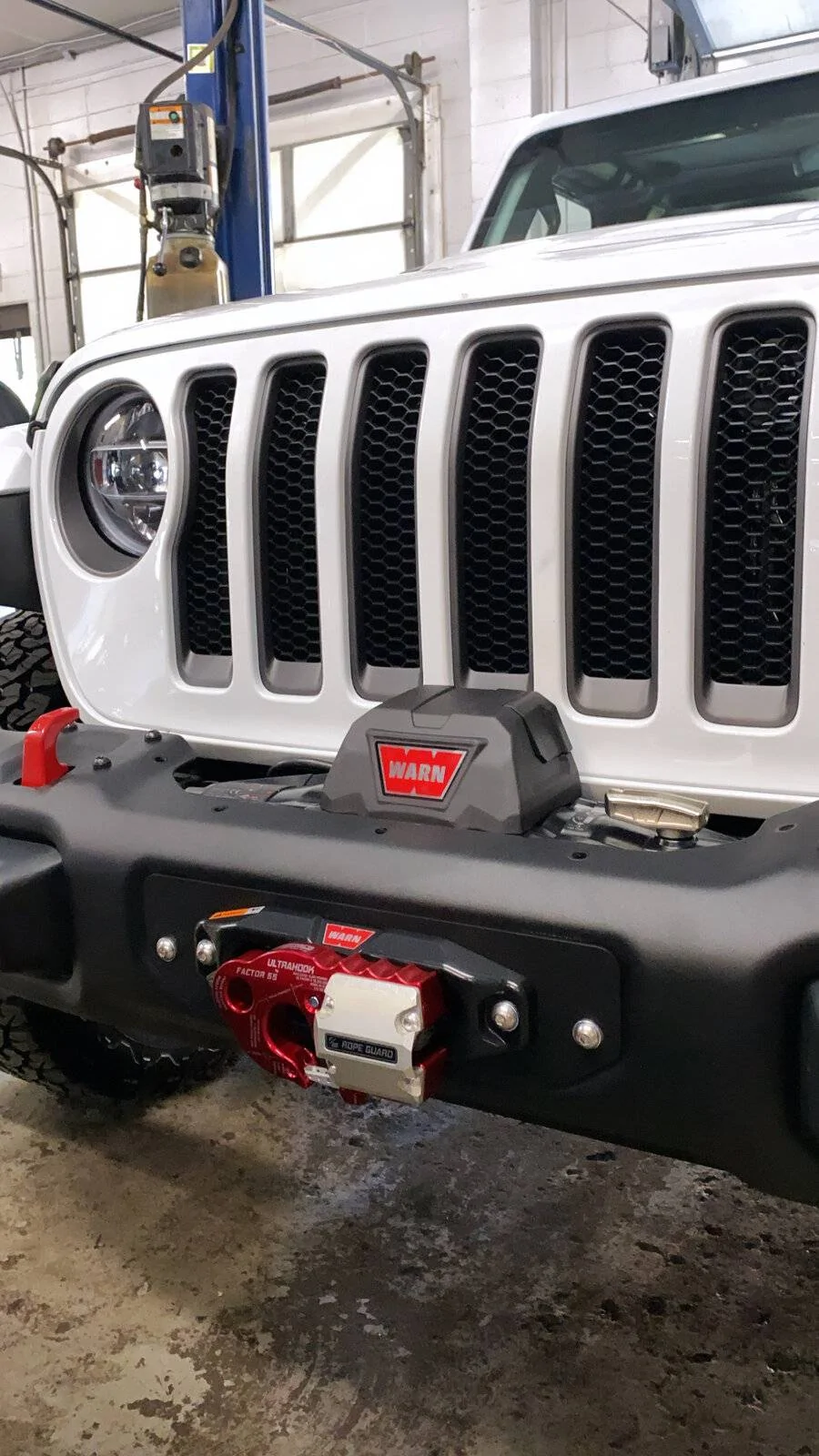

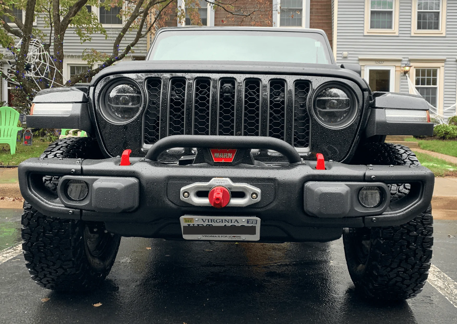

My JLR came with a factory-included steel bumper. I bought the Warn Zeon Platinum 10-S and it fit. Like a glove. As in really, really hard to get the bumper back on, but after 3 tries it worked. Side note: The larger the winch (10-S is pretty big), the less space you'll have if you plan to put the Mopar Winch/brush guard on the bumper. Pretty sure there are no spacers for that winch/brush guard available unless you have them fabricated. All that means is that your winch will fit, but it's like 1/32nd or closer to the winch/brush guard once all is said and done. I also had to buy the following things:
1) Mopar winch mount
2) Mopar fairlead centered adaptor
3) Different shackle/thimble if you don't want a Warn hook (I'm sure there are tons of threads on this)
Don't buy a winch cover unless your winch is tiny and/or it's not mounted in the bumper. You'll never get the cover on.
Lastly, I took my JLR to a install shop and I'm very, very glad I did. But after it's done and before you leave the shop....take a flashlight and check ALL the bolts, under the vehicle's bumper, around the skid plate, around the inside of the winch area, etc. They left 2 bolts out, 1 untightened...I think it's because my winch caused a lot of heartache with the guy putting it into the bumper and he was exhausted and wanting to be done by the time the job ended. But I didn't check and ended up buying some bolts and tightening a few others to complete the job. Also, be ready to tidy up the wiring inside as there are a few ways the wires can go but to make it look good you might want to have some zipties handy.
Good luck! I just literally went thru this so I know you are trying to plan it all correctly. I think you are doing this right, but I bet there are threads on this too....

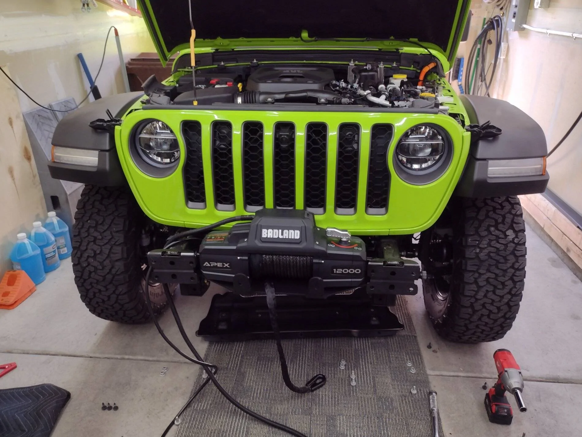

The winch plate mounts to the frame mostly, using the bumper bolts as well....the winch ready part basically means you can install the winch in the bumper without cutting anything, and without replacing the bumper.....I guess haha

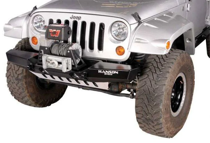

Jeep Wrangler JL winches to fit the JLR's optional steel bumper? Hanson_JK_8274mount
You're right that having the space designed into the bumper makes it winch ready. We'll give them that ;-) Having an integrated winch plate already there would be even better--what I was assuming--but that would be a lot of wasted steel and frame-tie for those who are not going to install a winch.
So that green-jeep photo is showing the winch installed to the frame with a winch plate in place, and then the JL optional steel bumper mounts around/on top of that?
