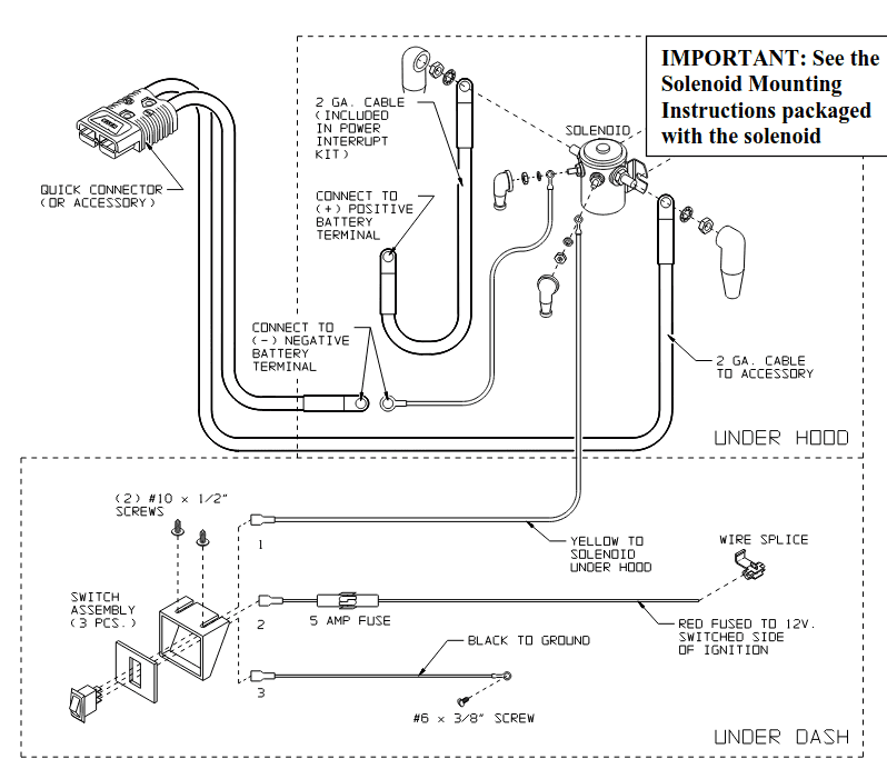

I installed the Warn power relay kit, the instructions and diagram (below) do not call out a fuse. The relay is mounted right next to the battery, so the opportunity for a short circuit is very small. Normally the power relay is off, so shorts downstream would not be active (for example in the case of an accident where the winch wiring could be crushed).
A valid argument for the no-fuse approach is that if you are in the middle of a critical recovery situation the last thing you'd want is an inadvertent fuse failure.
