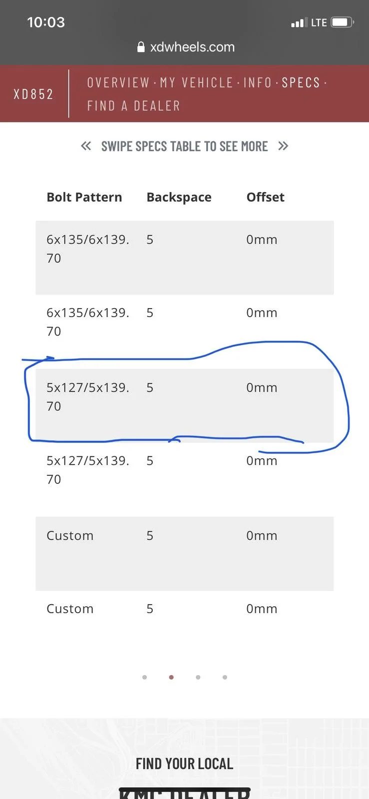

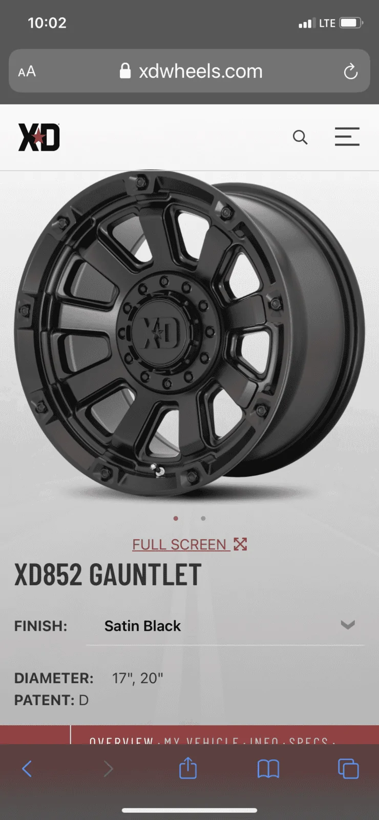

Website shows they won’t. I’m hoping they really do. Going with these wheels and a 4.5” Evo lift in the next couple of weeks for my JLUD.
If these won’t work I may go with a Method wheel.

Looks like bolt pattern is correct. How wide are the wheels?
Sorry. Forgot to mention that. Going with BFG KM3, 37/12.5/17. My concern was backspacing. Showing 4.5” is ideal, didn’t know if this 5” backspaced wheel would work.

Anything over 4.75", you will have rubbing with most lifts.
Best people to call is EVO. With a 12.50" wide tire, you'll likely rub the control arms or sway bar when aired down at 5" of backspacing.
