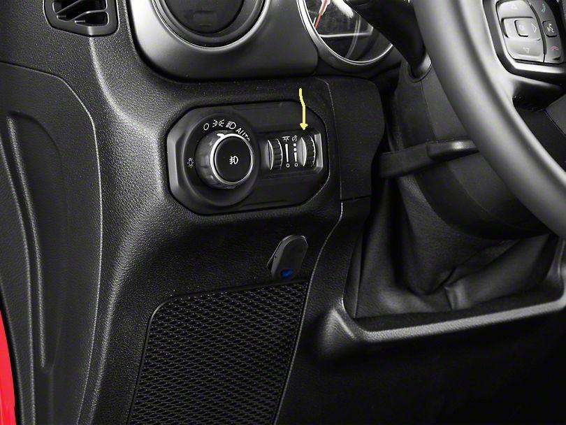

New Jeep JLU owner (got it yesterday). Tonight, pulled in the garage, got out closed doors, locked it... and realized all of the interior lights are on.
And they don't see to want to go off.
Any ideas?

Use the adjuster that the yellow arrow in the pic points to, to adjust / turn off your interior lights.
Do a forum search in regard to "Ambient Lighting" for lots of info on the adjuster to the left of the one that the arrow points to.
