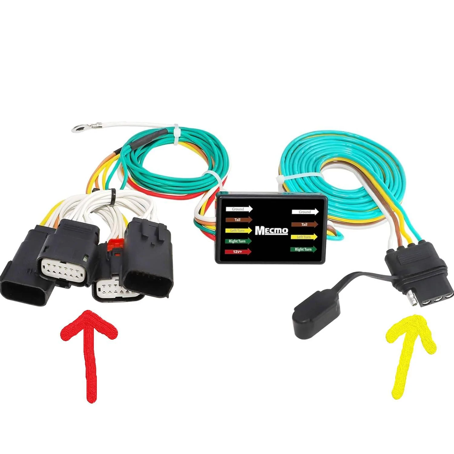

I found some at Harbor Freight, I also found some on Amazon that didn't look too bad. Sorry I can't speak for longevity but a common problem with the wiring; dirt and debris can build up in the connectors. I know it comes with a cover, but I still put a small Ziplock bag with a zip tie around mine and electrical tape on the other connections. I had very good luck with this.
Amazon.com: MECMO 56407 4-Pin Trailer Wiring Harness for 2018-2024 Jeep Wrangler JL/JLU, 2020-2024 Jeep Gladiator JT, 19-24 Jeep Wrangler Unlimited, Wrangler 4xe Towing Hitch Wiring for JL Trailer Light Connect : Automotive
