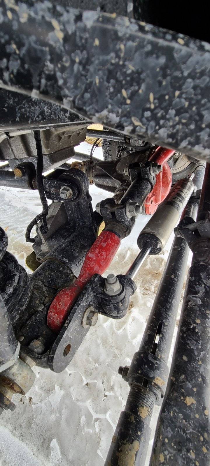

So, I'm doing my MC Gamechanger lift in a couple of weeks. Changing my Tie-rod, and Draglink also. My question is using the MC steering stabilizer relocation bracket. On the Axle side you have to drill a hole where you mount it. On the Synergy it just replaces the dragline bolt and has a stud sticking out you mount the shock to. I'm not a fan of drilling the hole. I considered combining parts. Using the Synergy mount for the dragline bolt, and the MC billet mount to mount to the tie-rod. What is everyones thoughts to me doing this?
