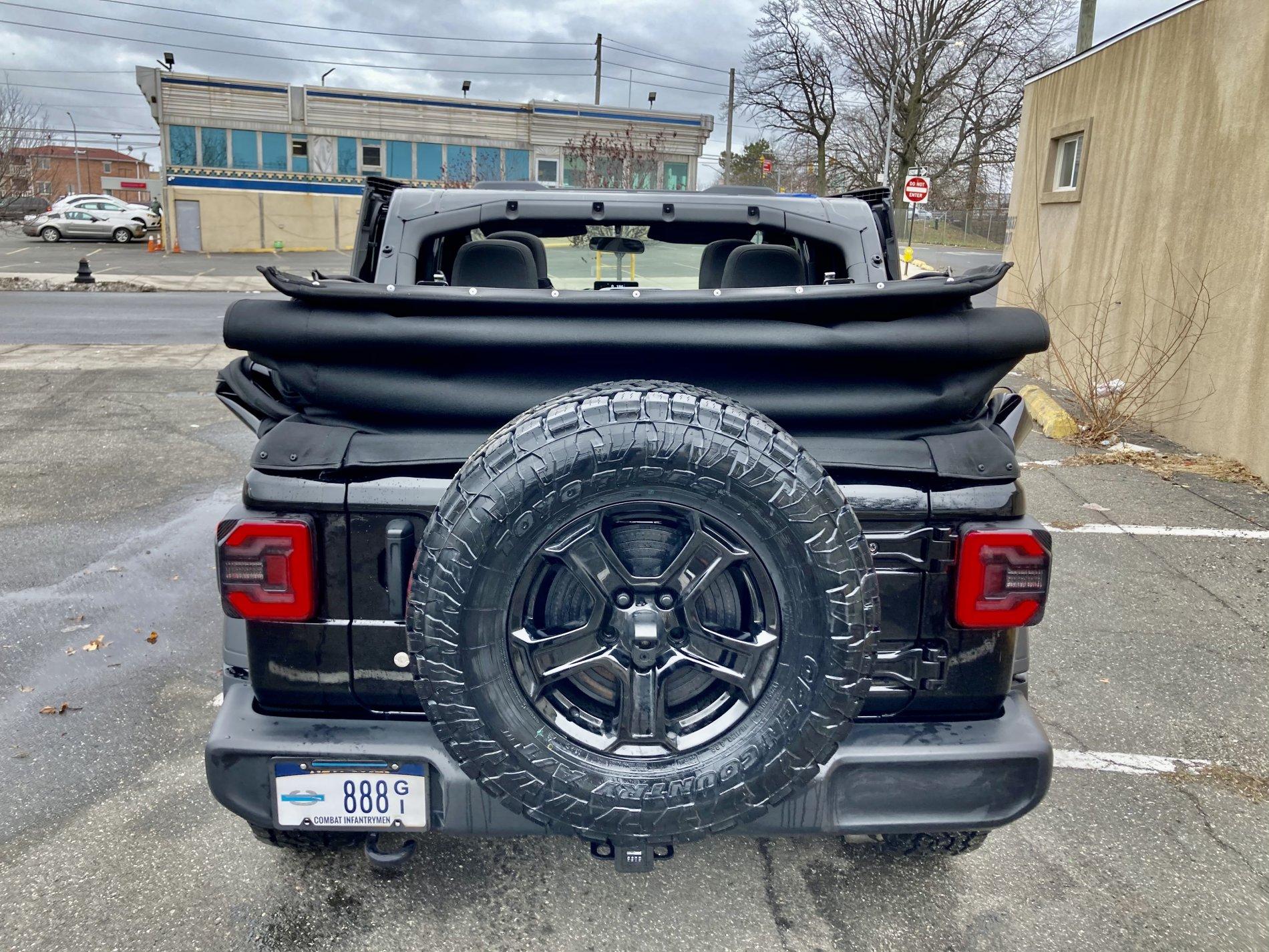

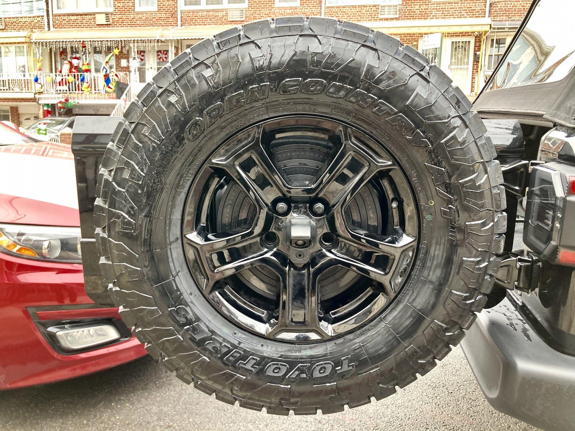

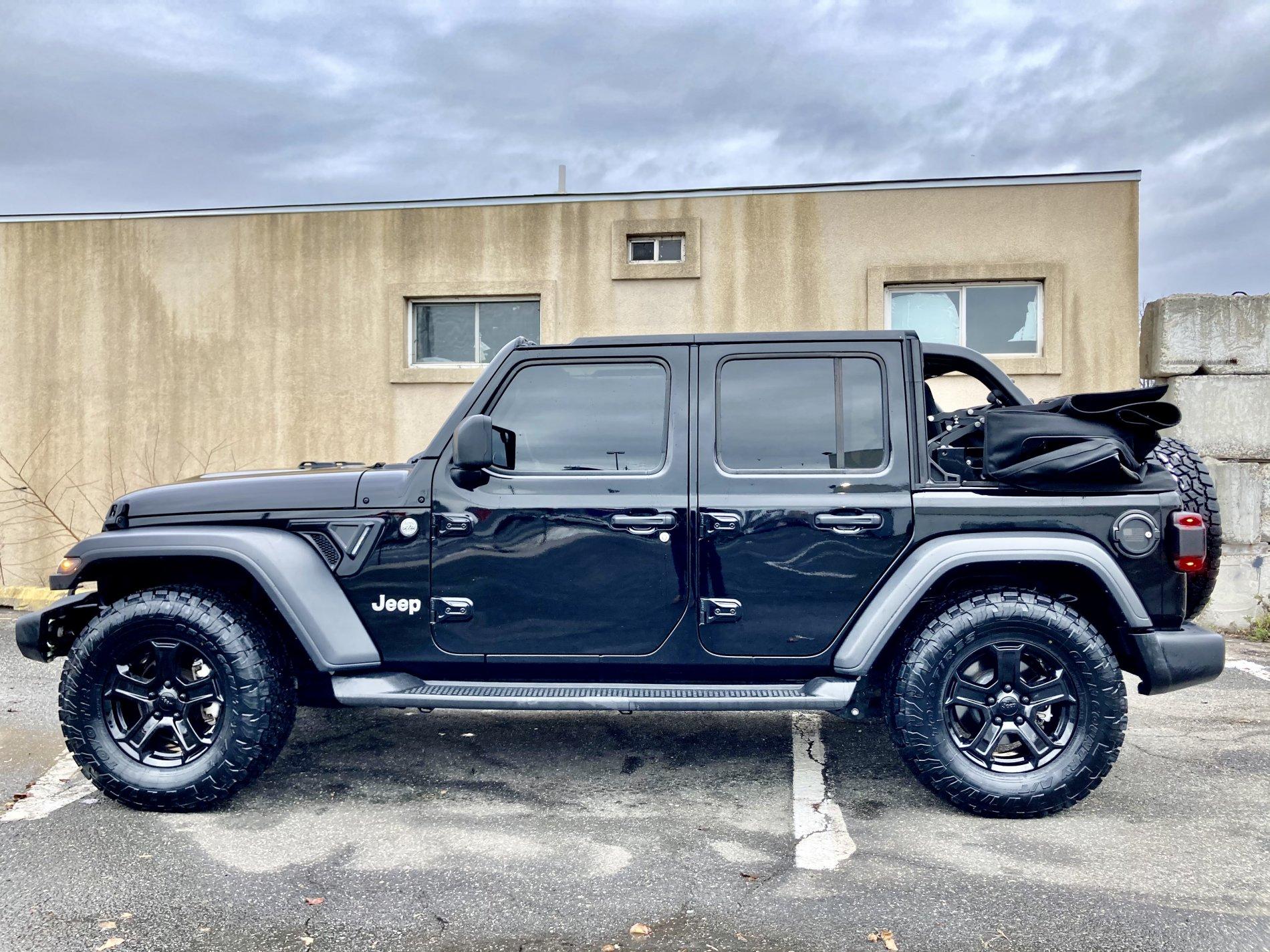

285/75r17 on Sport S wheels powdered coated gloss black
You can get Sport S takeoff wheels for $150 or less. It would be really expensive to get 20-21lb wheels aftermarket
My friend, those are friggin' sweet!!
