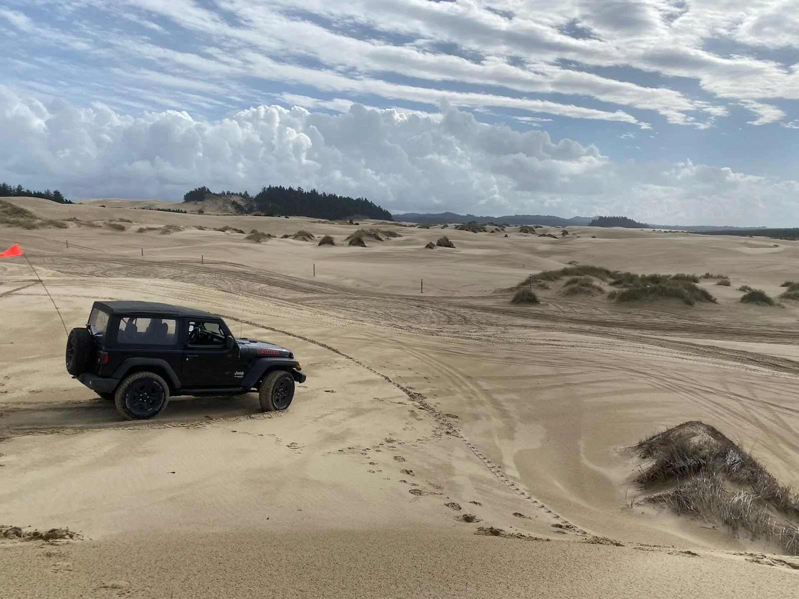

I have a 2020 2 door soft top 3.6 and 6 speed that I get to take out into sand dunes pretty much on the regular.
I'm currently running Mickey Thompson Deegan 38 AT, but I have tried other tires, and a 4 door hard top Rubi take off suspension.
As long as I stay in the flats or on the not so steep stuff the Jeep does fine. The whoops are brutal even creeping along at 25mph but I think as soon as I get some hydraulic bump stops it can smooth those out.
Problem is as soon as I try the steeper stuff there is a lot of wheel hop. I've tried taking the tires down to 8 PSI (that's where I popped the bead off). Anybody know how to fix the wheel hop? I'd hate to drop 5 to 6k on something like coilovers and long arms and still have the same problem.
