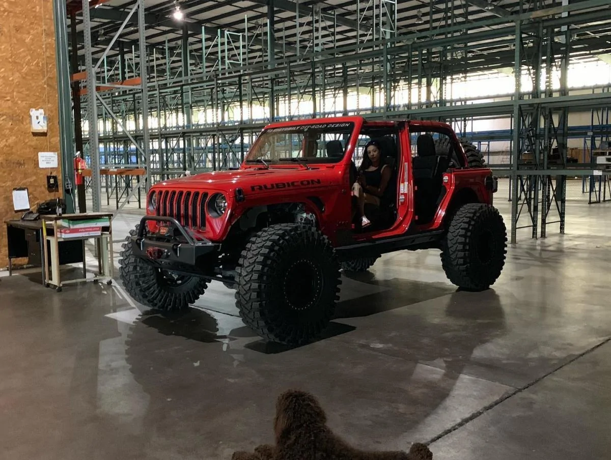

what Tires are these?

Those are bias ply tires. Not meant for on road use. They flat spot, go out of round, and will be bald in 10-15k miles. If you are looking for rocks only they are good.

dang. they are bad ass looking

They make a radial version but the sidewall is completely different. Much less aggressive.
Are they any good? Getting jeep lifted in 2 weeks and need a 37” tire. Looking at ridge grappler but these do look good.

Depends on what you plan on using them for. If mainly on road I'd avoid them. If it will be mostly offroad they will do well.
