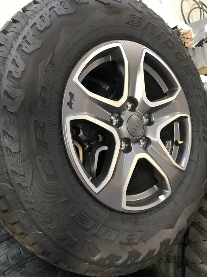

If it helps, here are the stock tires that came with a combo of granite wheels and anti-slip. I was told they're an upgraded Bridgestone Dueler AT (Revo 3).

I think the wheels that you have are the best looking ones available on the JL, but if that's not your thing then wheels are an easy swap that doesn't interfere with anything else.
I would get that rubicon suspension on there asap, a tiny bit of lift will do you well and help support the extra weight of future mods such as steel bumpers, winch, racks, etc.
Sidesteps / rock rails / sliders are again simple to install and don't interact much with anything else.
With the standard height fenders, I do not believe you will feel the need for larger tires with the rubi suspension, as the rubi's stock tires are barely larger and they use the high fender flares.
However, you may need wider tires or to air down for a lot of beach driving. If you go the air down route the compressor install would be huge.
