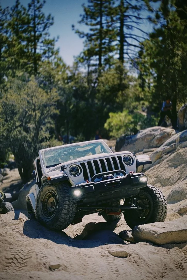

I almost went AEV and did a ton of research ending up with an RK lift in the end. If you're going to wheel it seriously which the tires suggest, I would go with a different lift. For similar money you can get the Rock Krawler 2.5" or 3.5" "flex" no limits system (I added fox 2.0 shocks) which gives you beefy adjustable lower control arms which are important, and an adjustable front track bar which is also important. The AEV lift lacks both of those items which is a bummer for $1200 as your front axle will be off center and no adjustments can be made. You'll also get a ton more flex than the stock lower control arms will offer you due to the ridiculously flexy joints in the RK arms.
If you have a little more to spend I'd do the metalcloak game changer, or at least the metalcloak true dual and add lower control arms. Best complete lift money can buy for trail performance IMO.
That and I'd probably go with a more standard mud tire like a nitto trail grappler, BFG KM3, Pat, STT Pro, etc - I've seen these tires do absolutely anything on trail, while still remaining tame on road and looking badass. That's me though, if you can put up with the noise the mud graps make they do look sweet.
As for tires ticking out, an 0 or -12 offset will get you 1.5-1.75" of poke per side, possibly a little more on a 13.50 tire. A full -38mm offset like most beadlocks are will get you about 3" of poke on each side.
I am a 2 door on 35s, but an example of the flex you miss out on quite a bit of by going mopar or AEV - it had a little more droop to go on the drivers side. You get even more with metalcloak or a full RK kit, I have the $1200 flex no limits system which is essentially the x-factor lite.
And all that said, it all depends on what you're going to do with the jeep. IF you're just gonna hit fire roads and camp/overland, the AEV lift is solid. I'd still add LCAs and a front trackbar tho.
