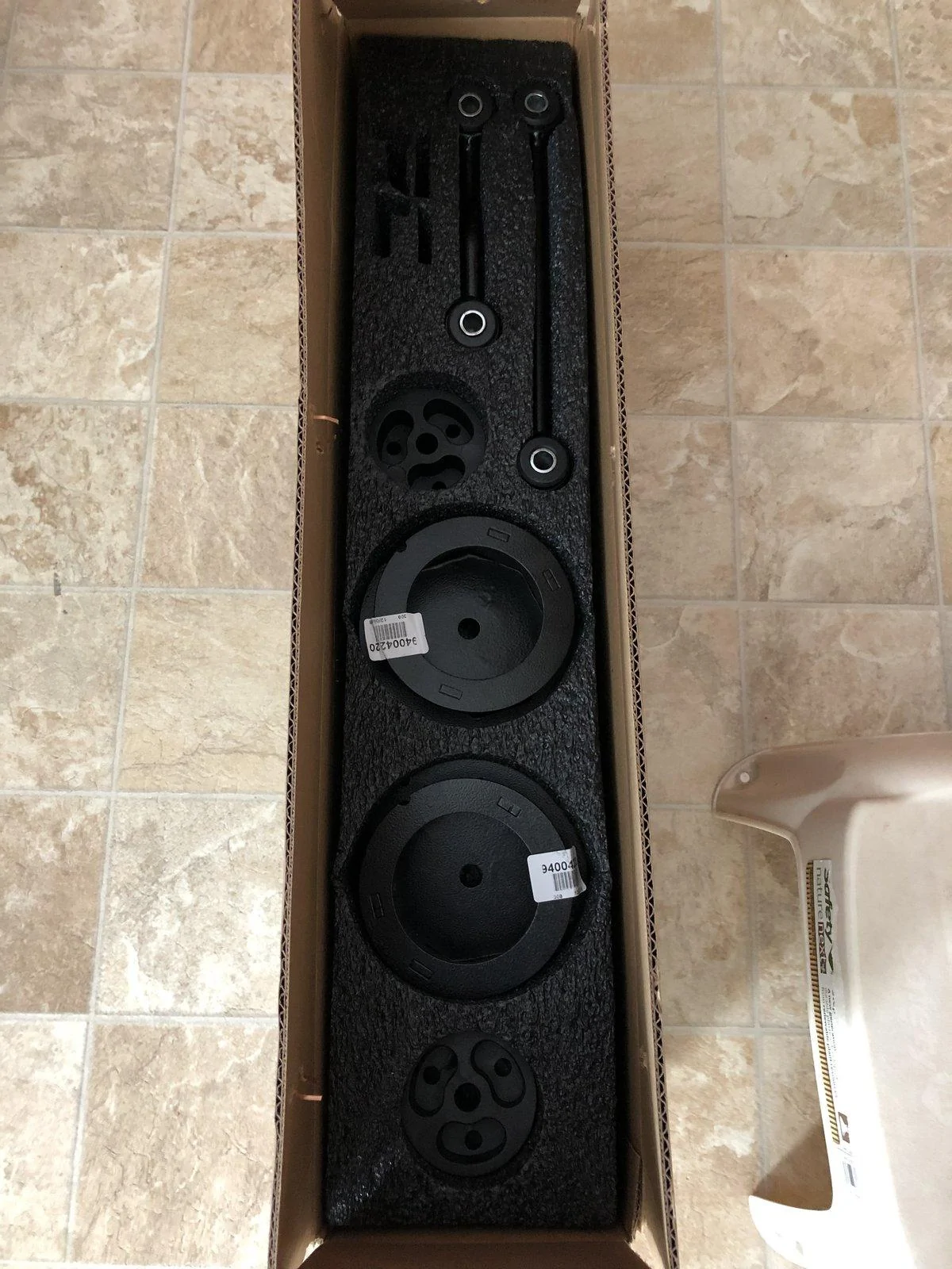

My headliner fabric and a few other necessities came in today. I am hoping to start making my headliners some time this weekend.

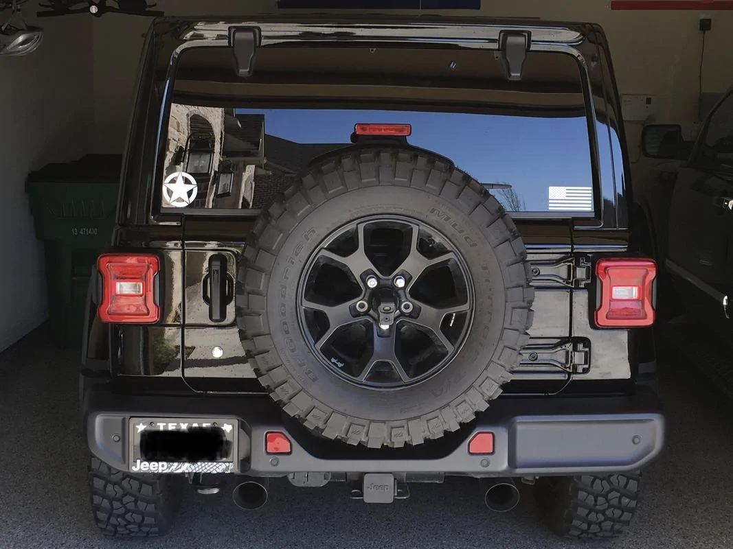

Got this Draw-Tite Hitch installed from amazon. Pretty easy install. Used the Tekonsha Trailer harness as well https://amzn.to/2HKboOK
I like this hitch because it has the longer receiver to clear the tire etc.

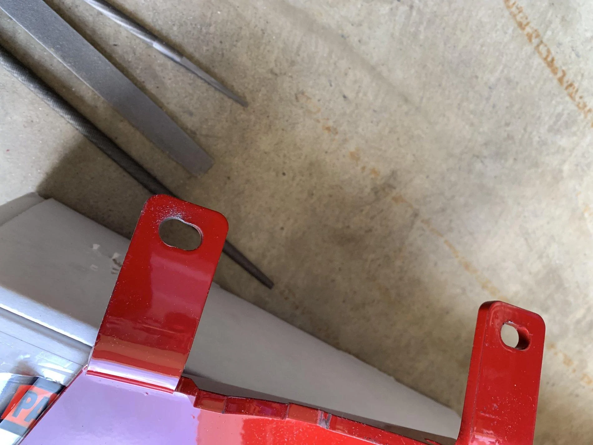

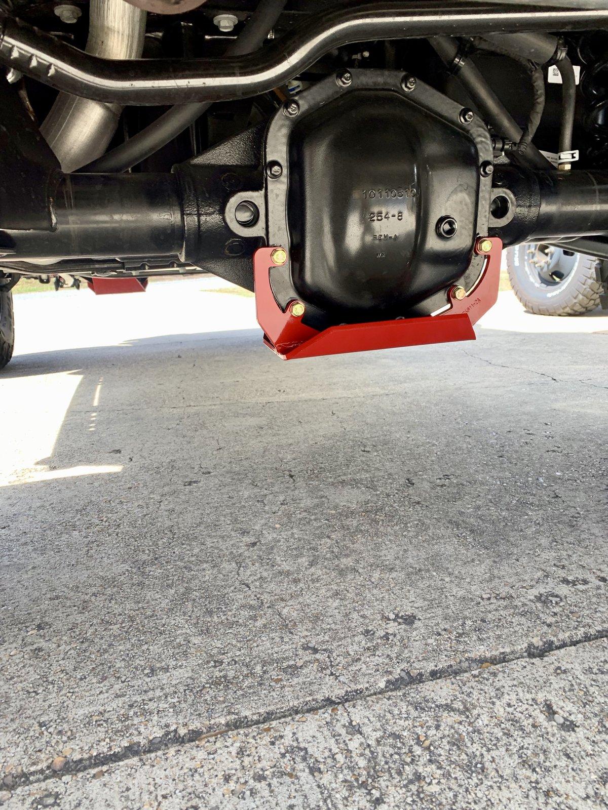

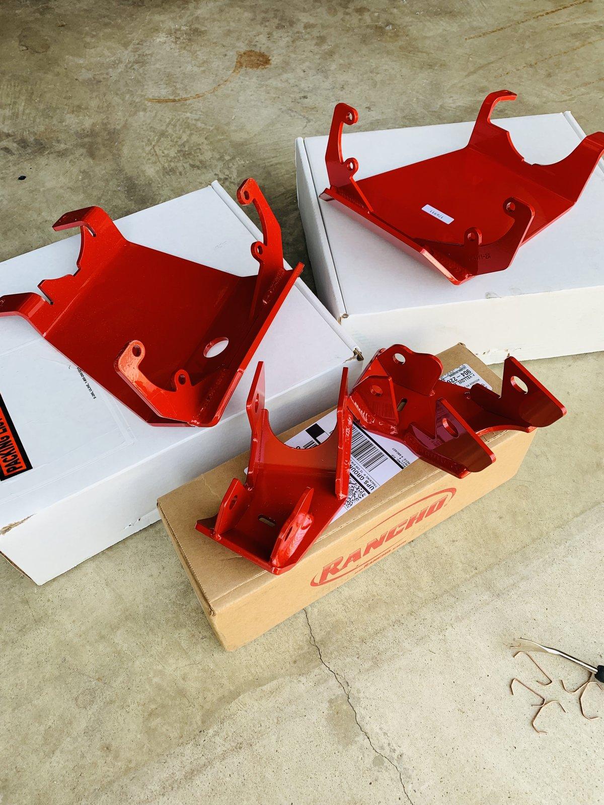

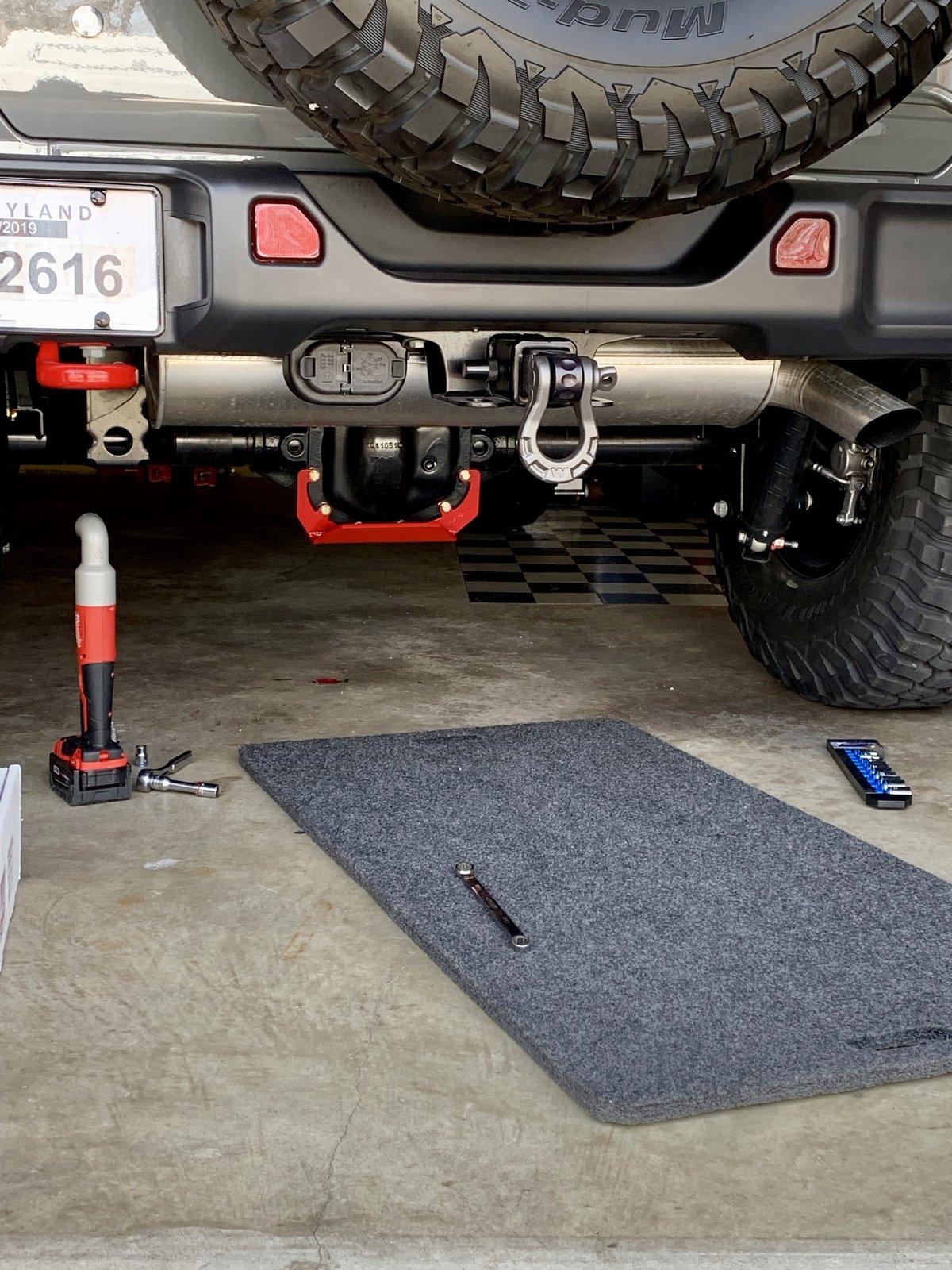

received the Rancho diff sliders. Was thinking of painting them black to keep them stealth, but they do match the oem hooks spot on so just left it. Rear went on without issues. The front I did have to file a little bit on one of the ears. No biggie, but since its only being torqued down 15 ftlbs Id recommend taking the 5 minutes to make sure the U bolt drops down without issues and not hung up to get a false reading. Red loctite supplied. The stock bolts on diff had some red loctite, some pink color residue. I had no issue but just wanted to mention it.
