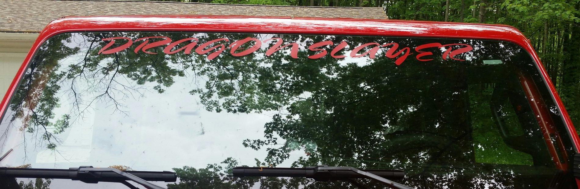

2018-05-31 10.17.50.jpg 1st graphic on. :clap:
couple wrinkles & 1 small tear but it looks good overall. way tougher than i anticipated. had to put it on standing up through the top.

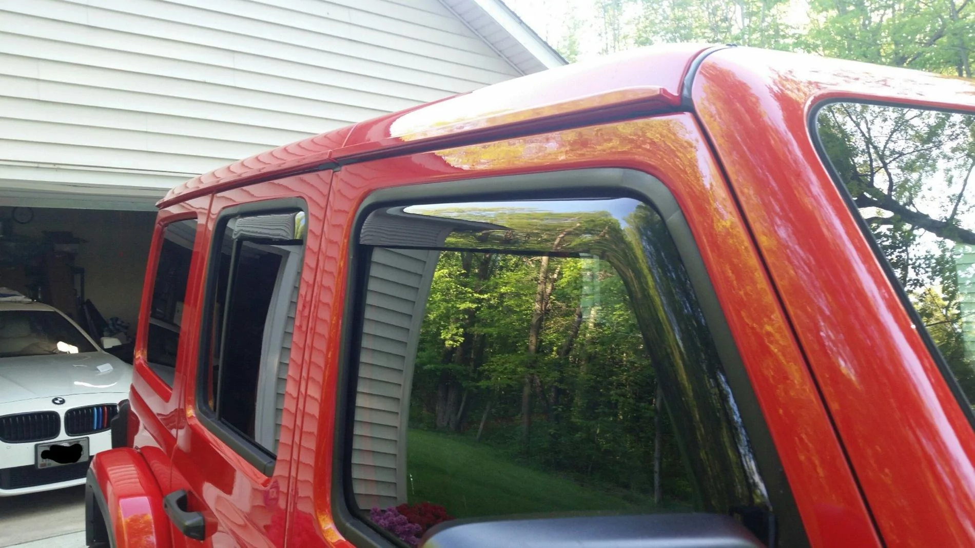

2018-05-23 21.33.50.jpg mine didn't come in a packaged "box". they were wrapped in a foam type film, inside of the shipping box. (bulk pack style) nothing was "wade" except the little red sticker on each one.

Hmm. I guess I'll shell out some money for the weathertech ones since I've had good luck with those. Hopefully I can at least get a refund for these.

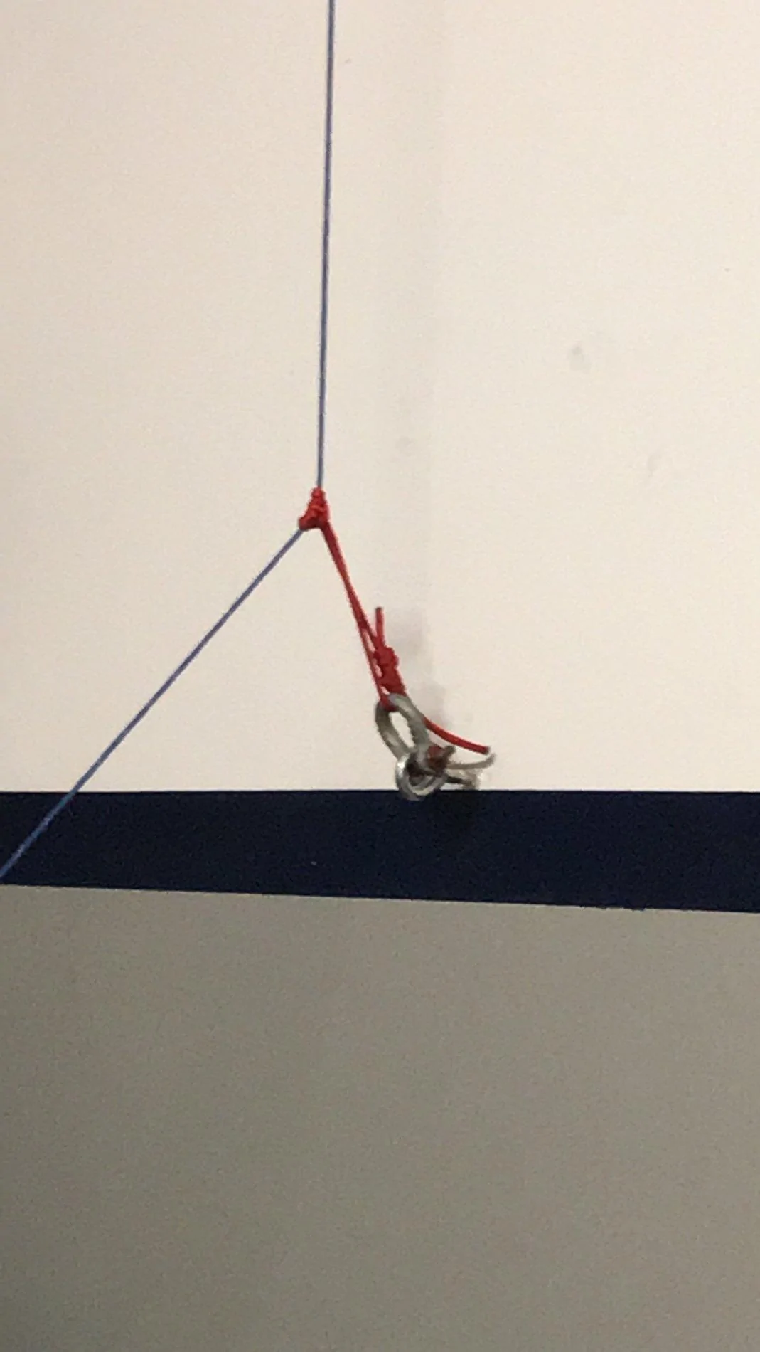

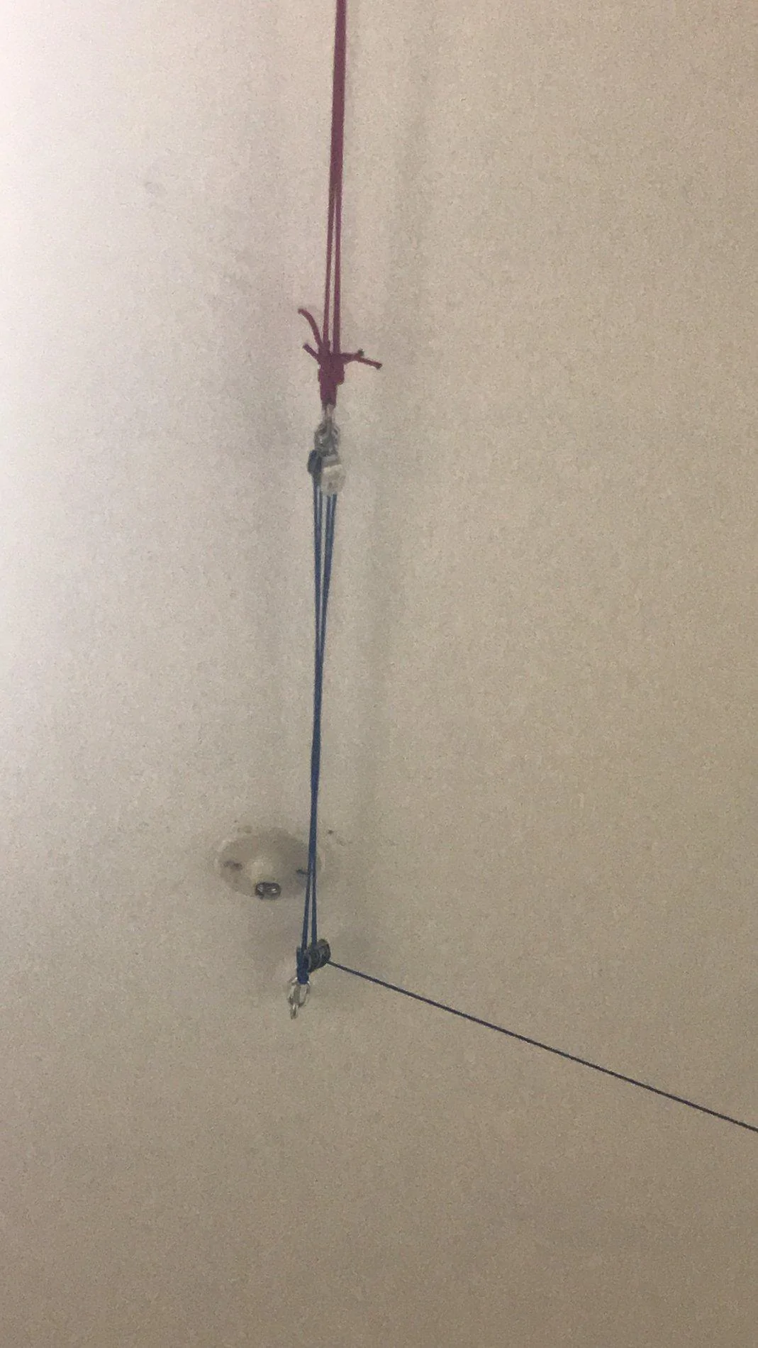

Then today, the wife and I installed my hardtop hoist. I of course had to take the top off after I got the hoist installed. I have a few kinks to work out yet, but once I have them fixed, should be great! I got the idea from the Harken hoist, but I pieced everything together myself.
More details on that hoist please! Looks super clean - was it cheap? I was looking at the Harken and that's not cheap, lol.

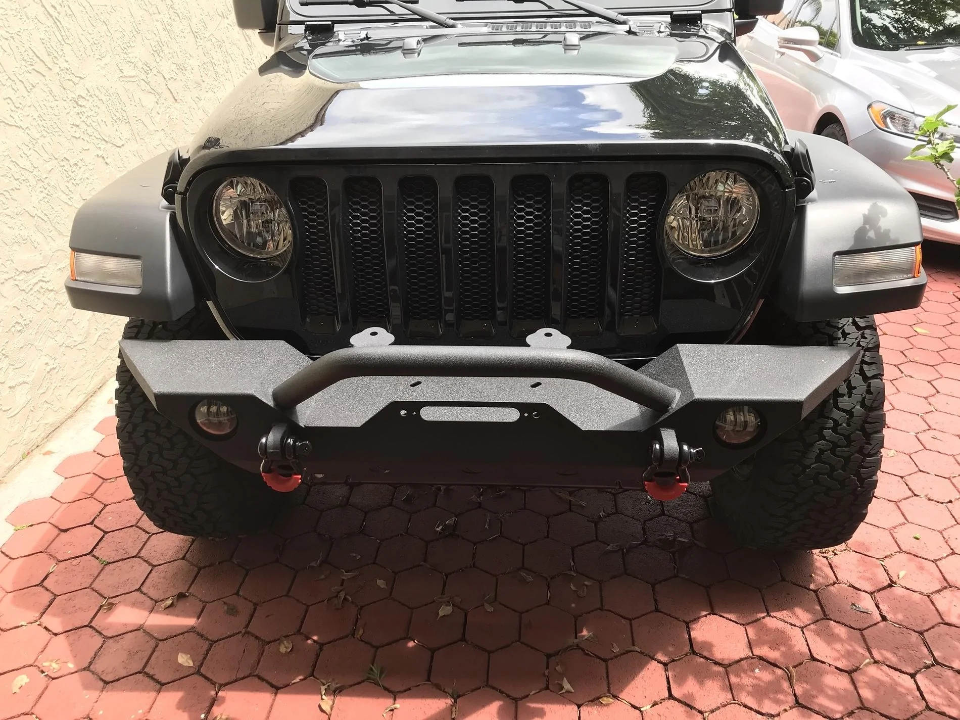

Got a new bumper from the Fleabay, thanks to some great advice from @jericbarg! It's for a JK but fit really well. I had to drill out the outer two holes a little, buy some LED fogs since my halogens wouldn't work, trim down the fog light surround a tiny bit but otherwise it went well. FedEx dropped it in my driveway, causing it to poke out of the box and dent the corner plus chip our pavers :(
I'll never need an LED bar but I hate those tabs and I'm afraid to get stuck so I think I'll grab a winch.

Well, in actuality, I got the idea from the Harken hoist. But being the person that I am, I didn’t want to pay the price for the Harken either. Having the mechanical aptitude that I do and having rigging experience, I built the system myself. I piece mealed pulleys, anchors, 550 paracord, made some straps from webbing and made some hooks. I may have $60-80 into the whole thing. I do have a few kinks to work out yet, but hope to have it fine tuned. I also integrated my own brake into the system, a little bit different from the Harken, it’s called a Prusik knot, that way, if the rope were to slip out of my hand, the whole thing doesn’t drop to the floor. Also, where the Harken was a 7:1 mechanical advantage, mine is only a 4:1, so a little more effort with my system.
