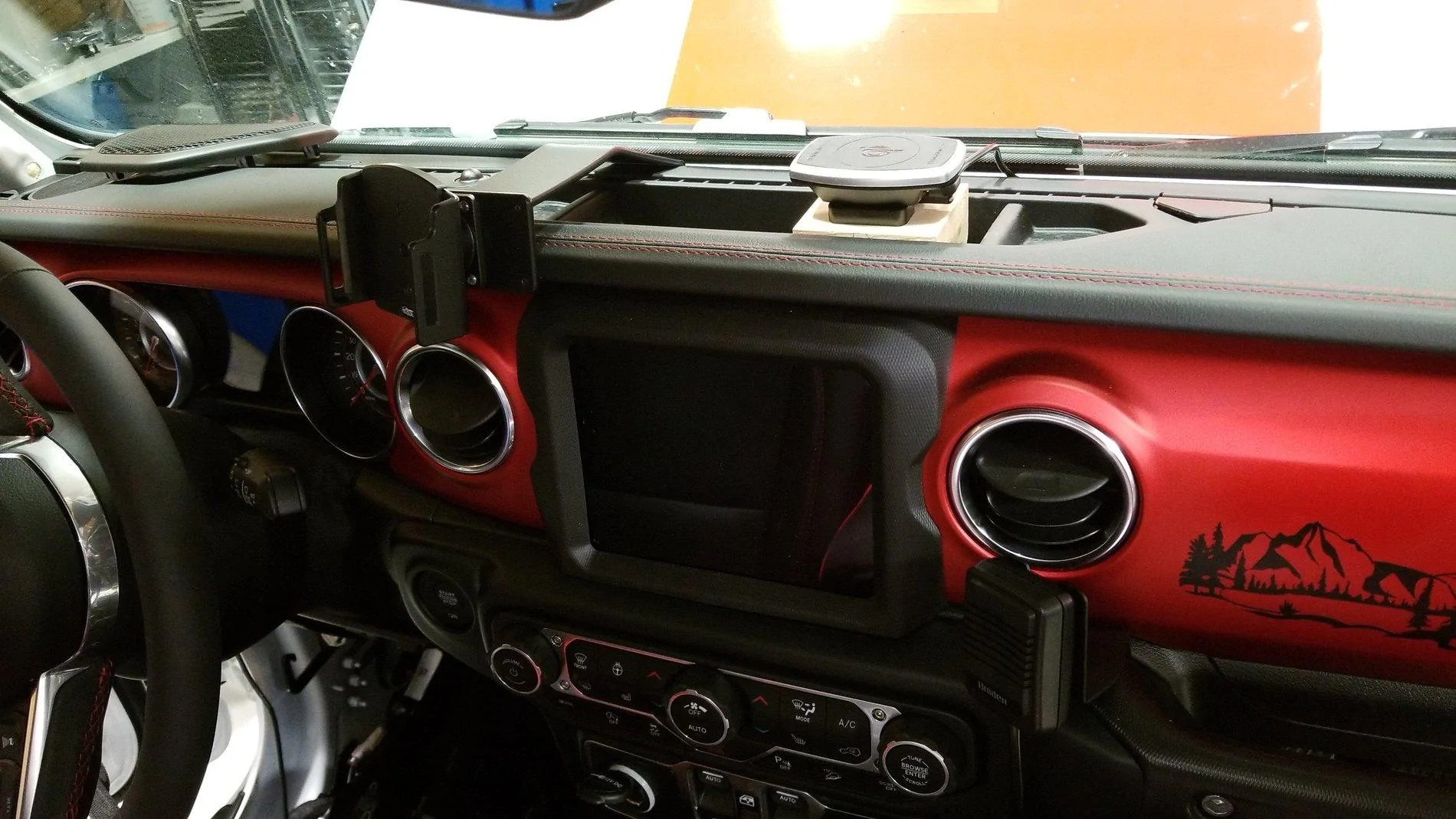

In an earlier mod I wanted to use my wireless charger with my ProClip mount but phone wouldn't stay on it. Doesn't surprise me. I have a Note 8. So I decided to move this charger to a horizontal location. Best idea I could come up with was to make a wooden piece that would sit on top of dash and hook charger to it. This worked. Well today I installed my other larger ProClip mount. I had no idea it had a horizontal mounting pad on it. I figured iPads, etc would mount to the vertical plastic. Anyway this was perfect to put the charger on. Looks better.

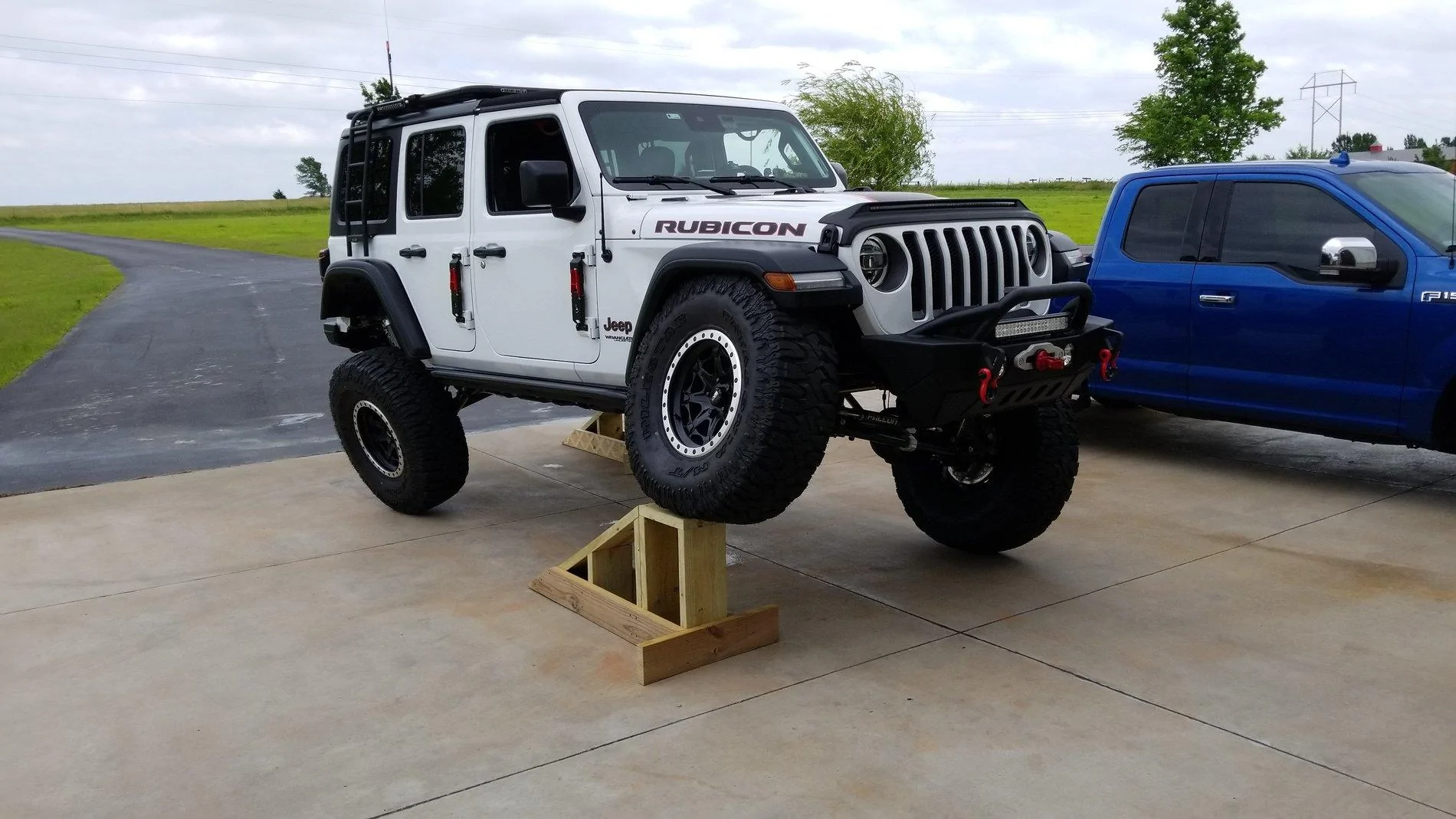

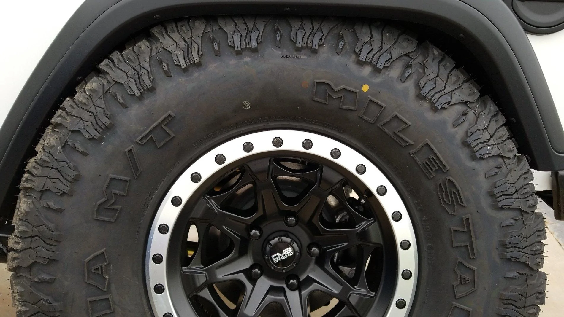

I have Metalcloak 3.5" game changer lift with 38" tires, all 4 pucks on front and 2 on rear. I flexed the JL using 21" tall ramps I made. The front tires were barely touching fenders. SteerSmarts top mounted draglink touched the rubber cooling line but missed frame by 1/8". Rear tires were heavily pressing against fenders. I went from 2 pucks on rear to 4 pucks. Rear tires still rubbing. Rubber bump stops look awfully squashed. Rear tires were also heavily pressed against pinch seam.
So 2 things perplex me...
1. If I have all 4 pucks installed why would I have any rubbing. Are my tires too big? I figured people were running 40s with this lift. Not too many lifts taller. View attachment 185631
2. If the top mounted draglink is a bad idea because it limits up travel, we'll it wouldn't help me in the slightest to switch to bottom mount. Tires are already touching fender. I really need another puck up front and maybe 2 in the back.
The front round pucks are tilted because I didn't have bolt tight enough.

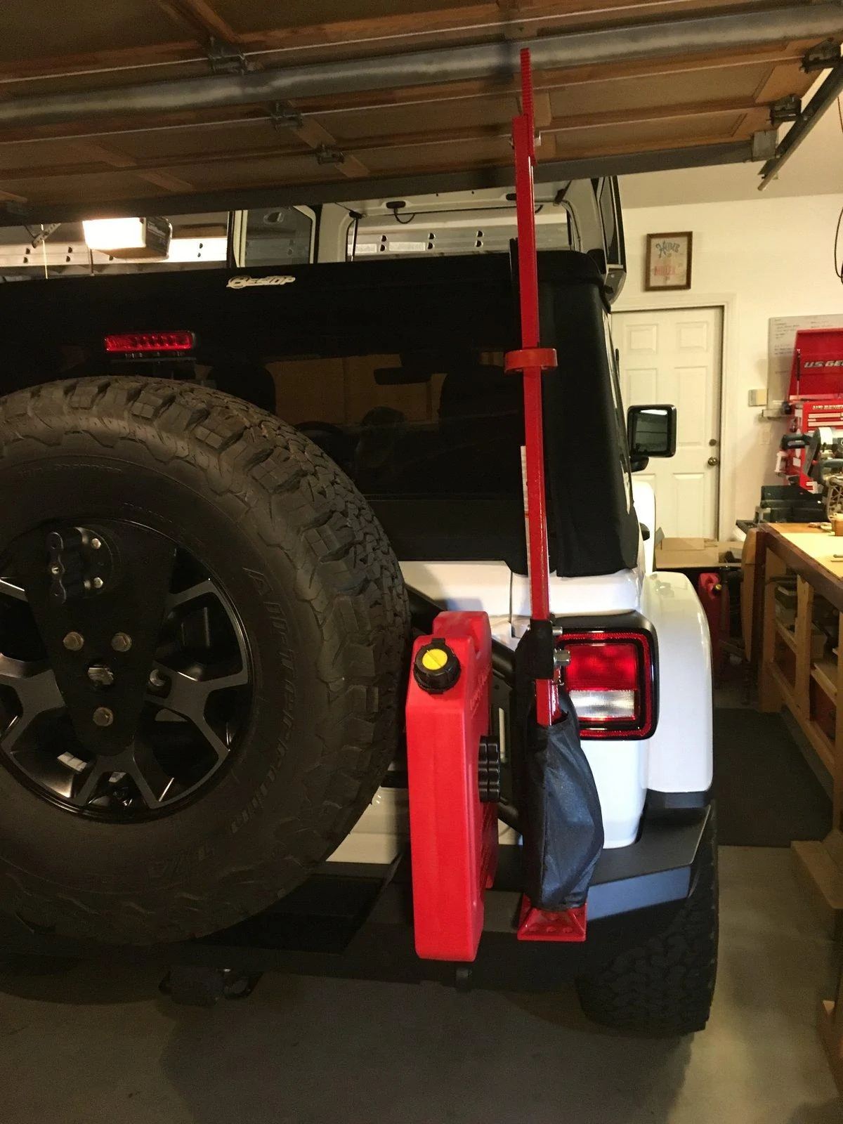

Never could get comfortable with gasoline on the bumper.
Call me crazy.
I agree that it is somewhat vulnerable in the current location, but I don’t plan on running with it on the highway any more than necessary (from gas station to trailhead).

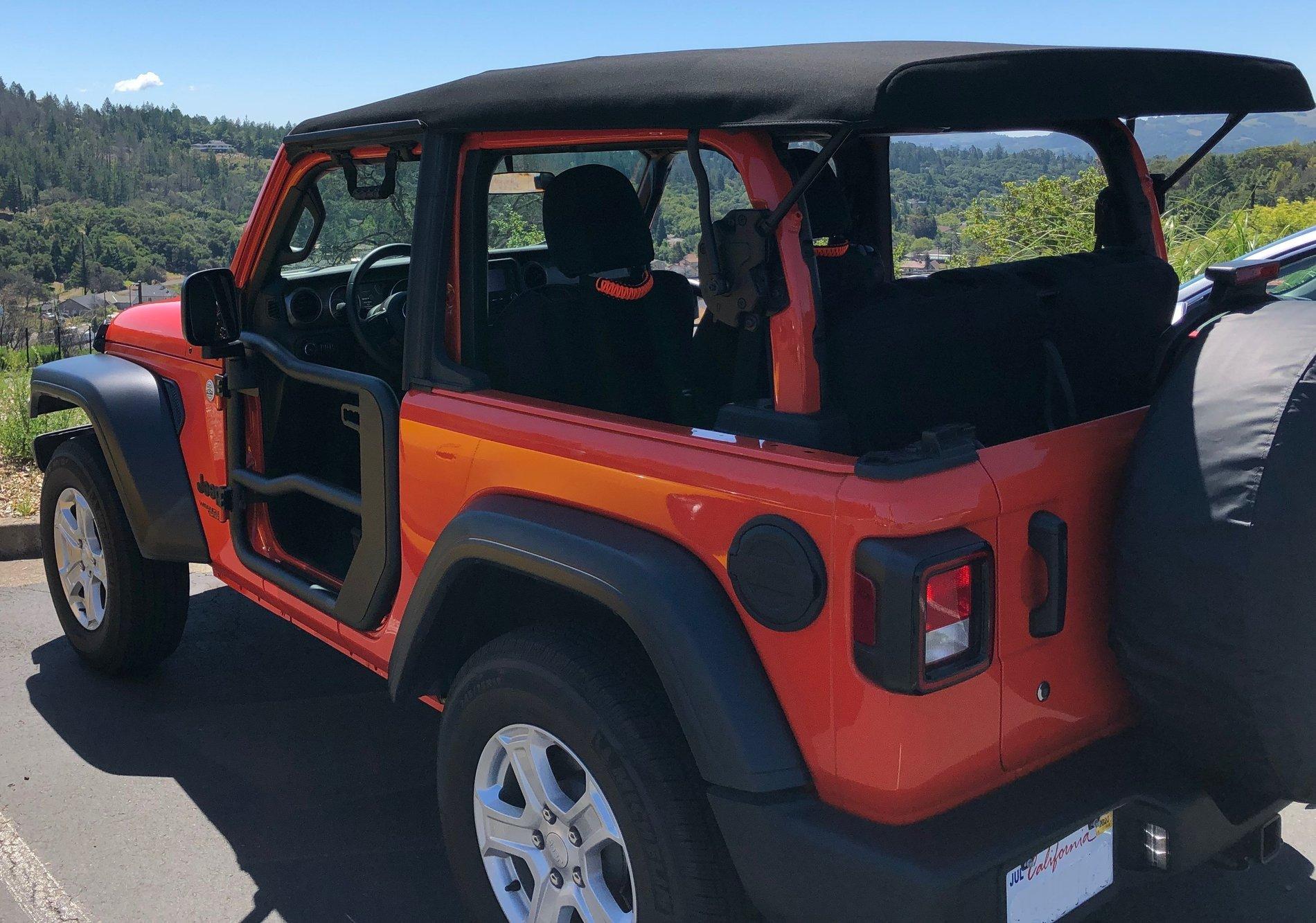

2 more bolts and the window trim comes off. Your Jeep looks great
I agree, but sometimes I like to put the soft top back up if the sun is too much or if rain. Is that still possible with the trim on? If so, maybe I’ll do that
