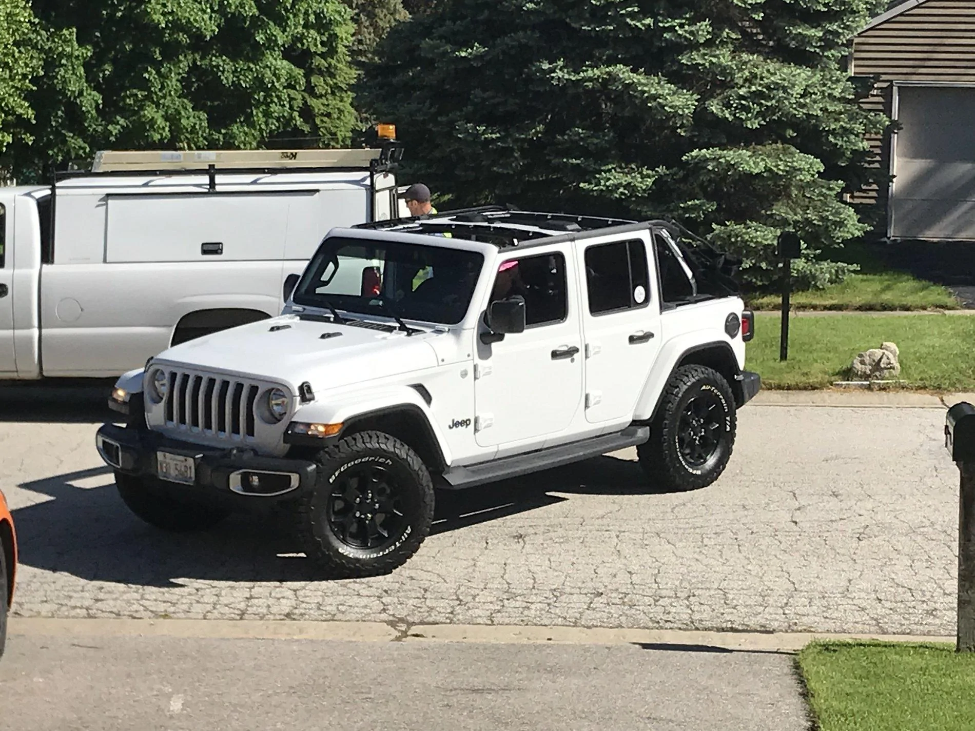

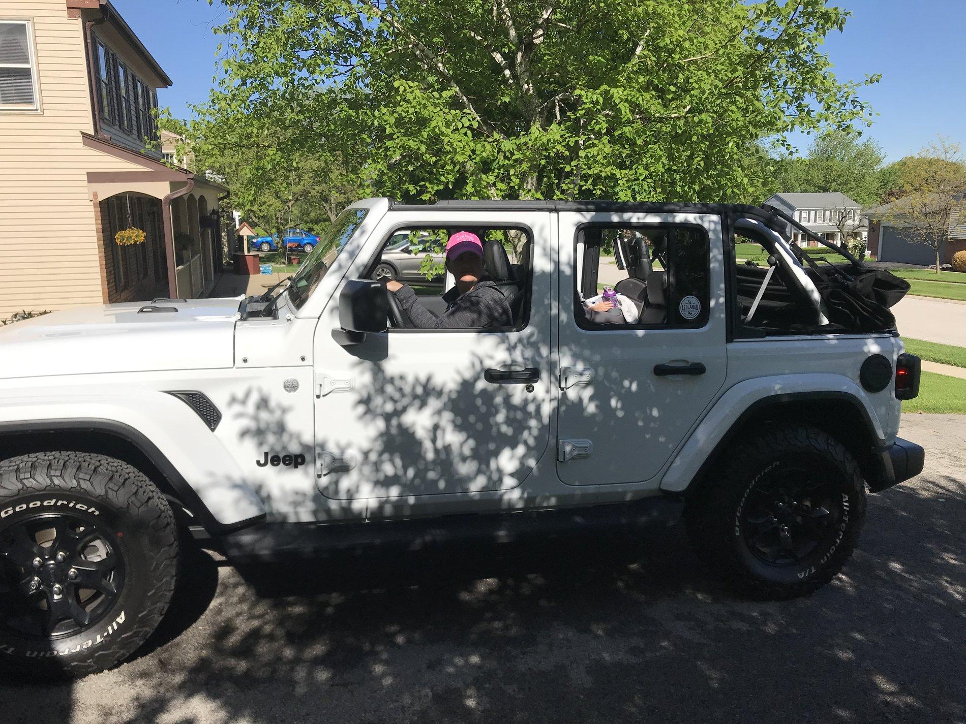

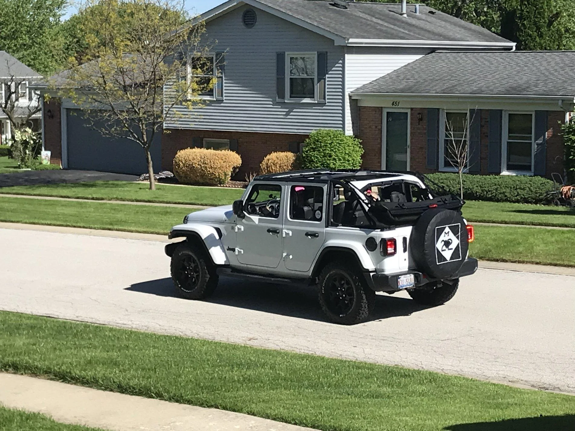

Rolled up the top on my new Suntop tonight. Couldn’t be happier with this top.
Which top is that? Will it protect from "some rain"?

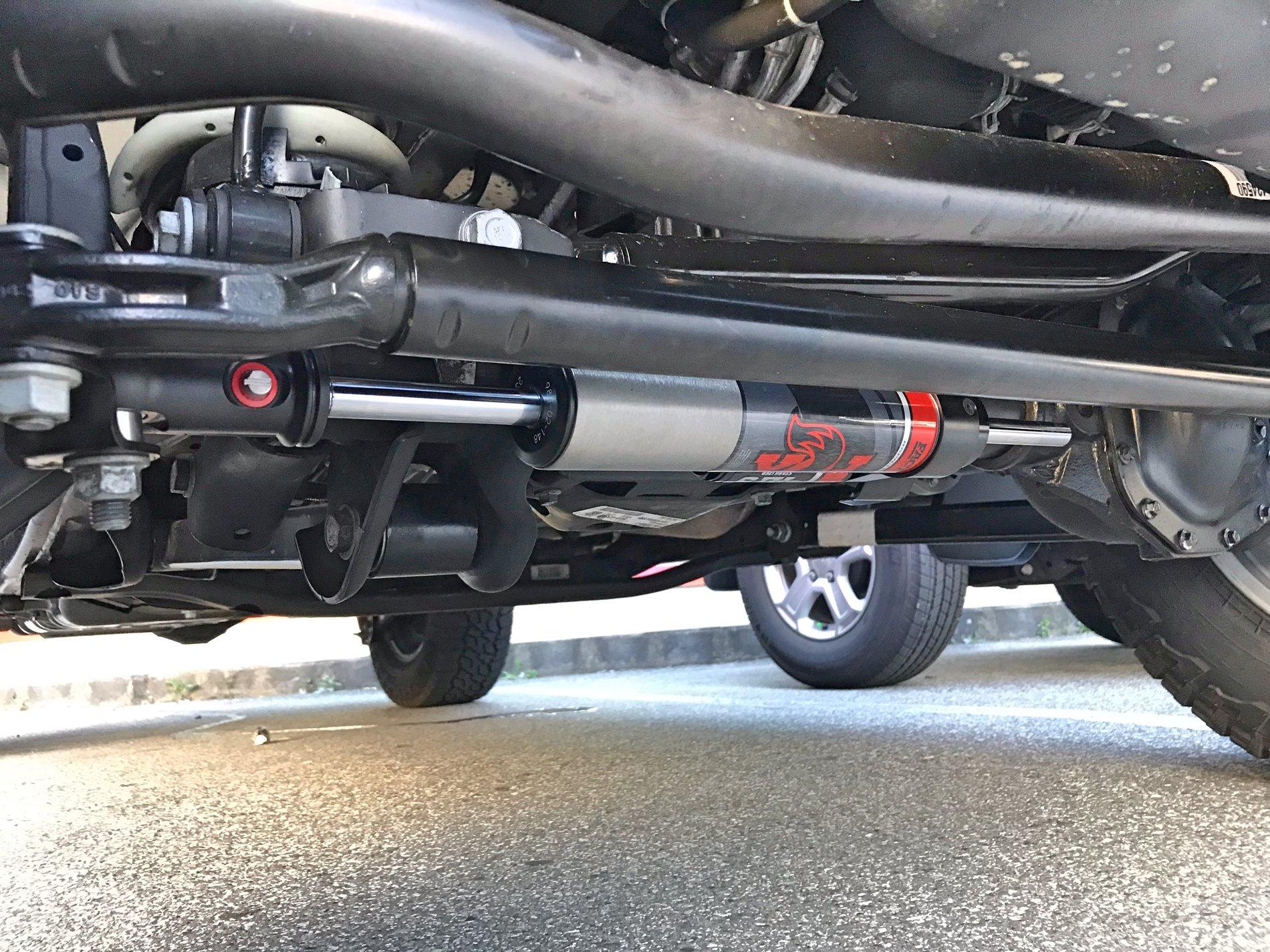

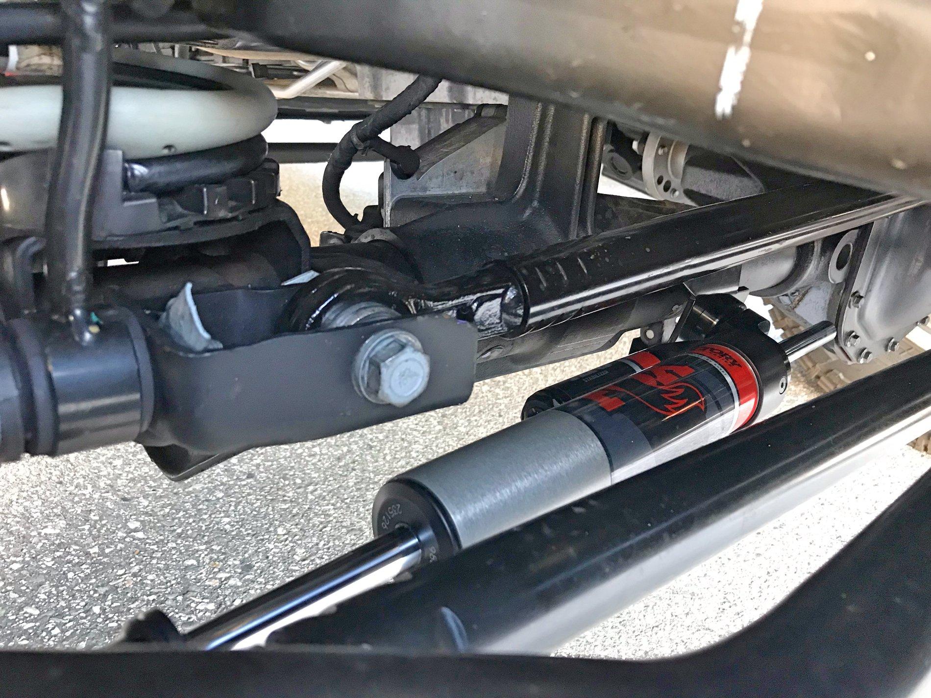

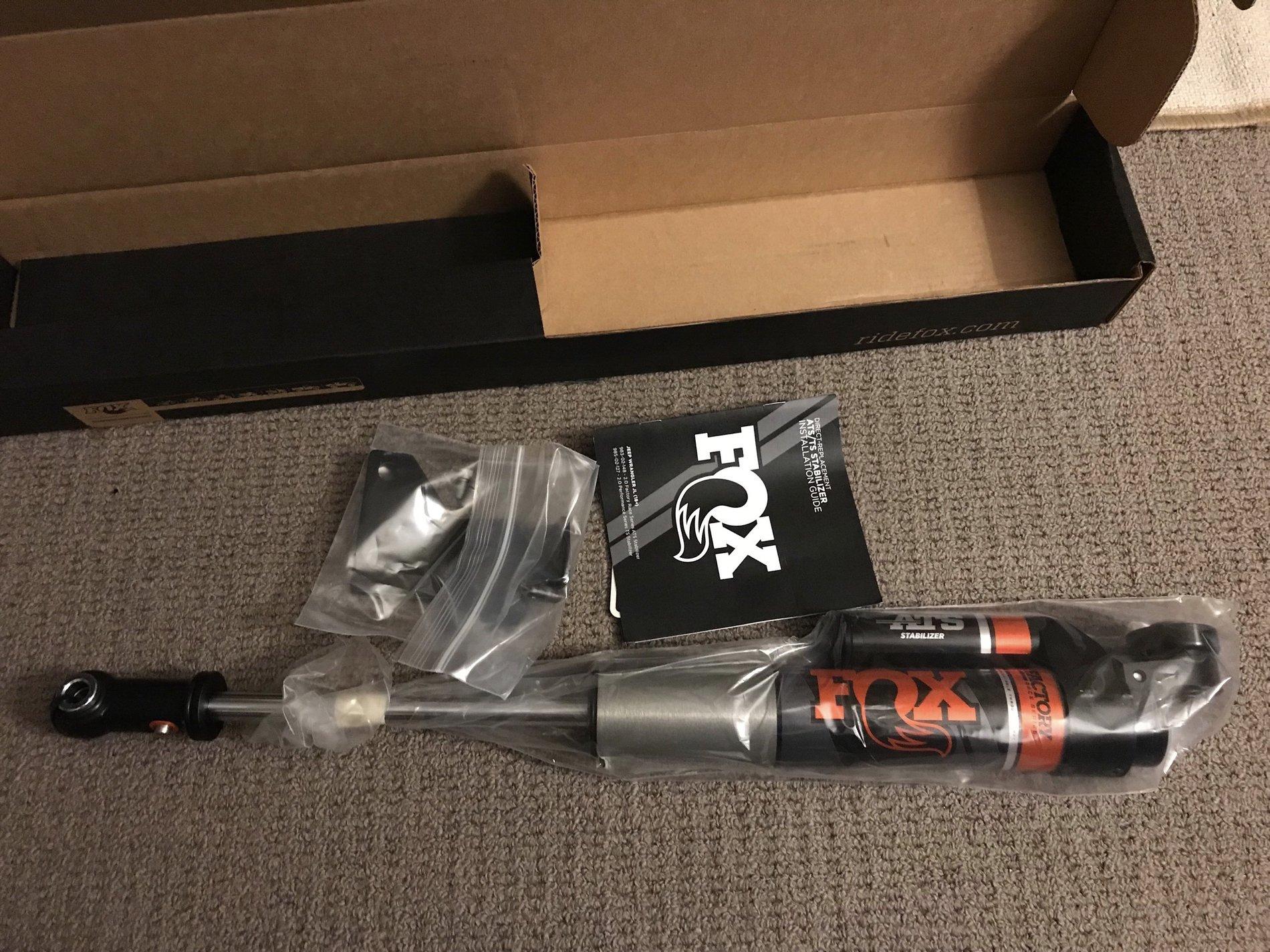

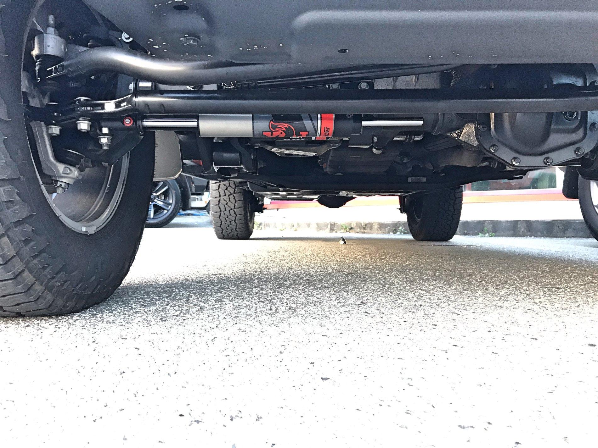

Replaced stock steering stabilizer with Fox 2.0. Nice improvement over stock especially with the 37x13.5 tires. Also it matches my Fox shocks from my Mopar lift which is a nice plus. Install was super easy. Just (2) 18mm bolts torqued to 59 ft-lbs. Took about 10 minutes. I rate this install at 0.25 beers + the rest upon completion. As always, had the help of my trusty companion for project management.

Do they offer a dust shield for the Fox damper? I never like having exposed components in areas where I tend to have thick layers of mud build up.
Good question. I should look into that. I agree. But didn't come with one....

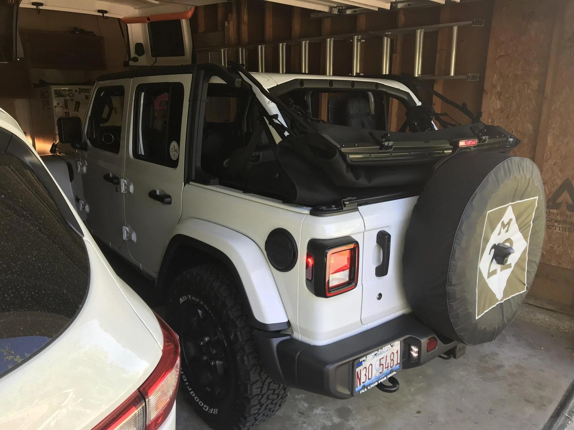

It looks great. I'm interested but can you still fit the freedom panels and the bag under the slipstream cover? I remove my panels often and put them in the back. It's a tight fit so I'm curious if they will still fit.
The freedom panels in the bag will definitely not fit. Without the bag they just barely fit. I’m planning to get some sort of blanket to use for protection instead. I think that will work just fine.
