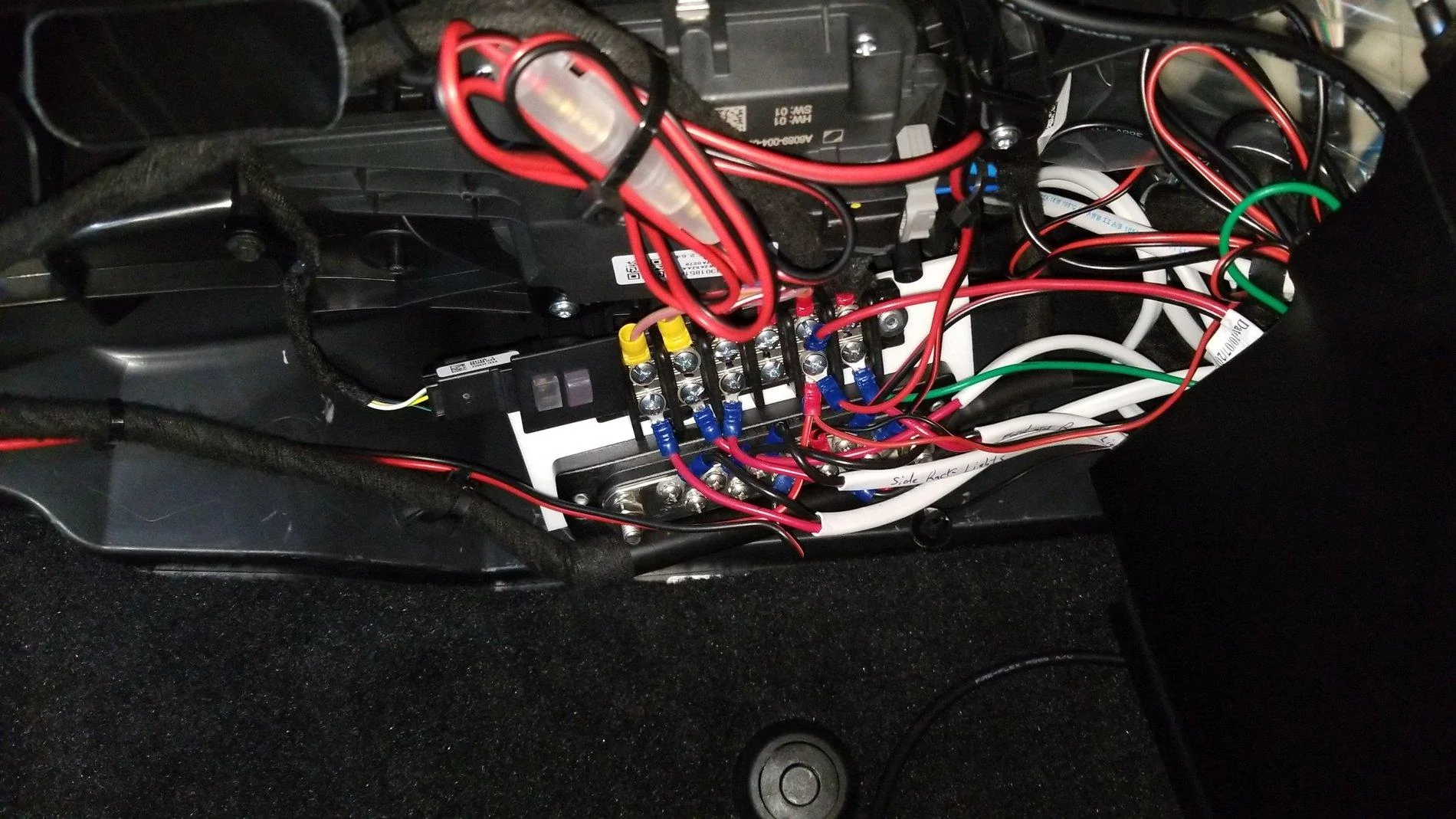

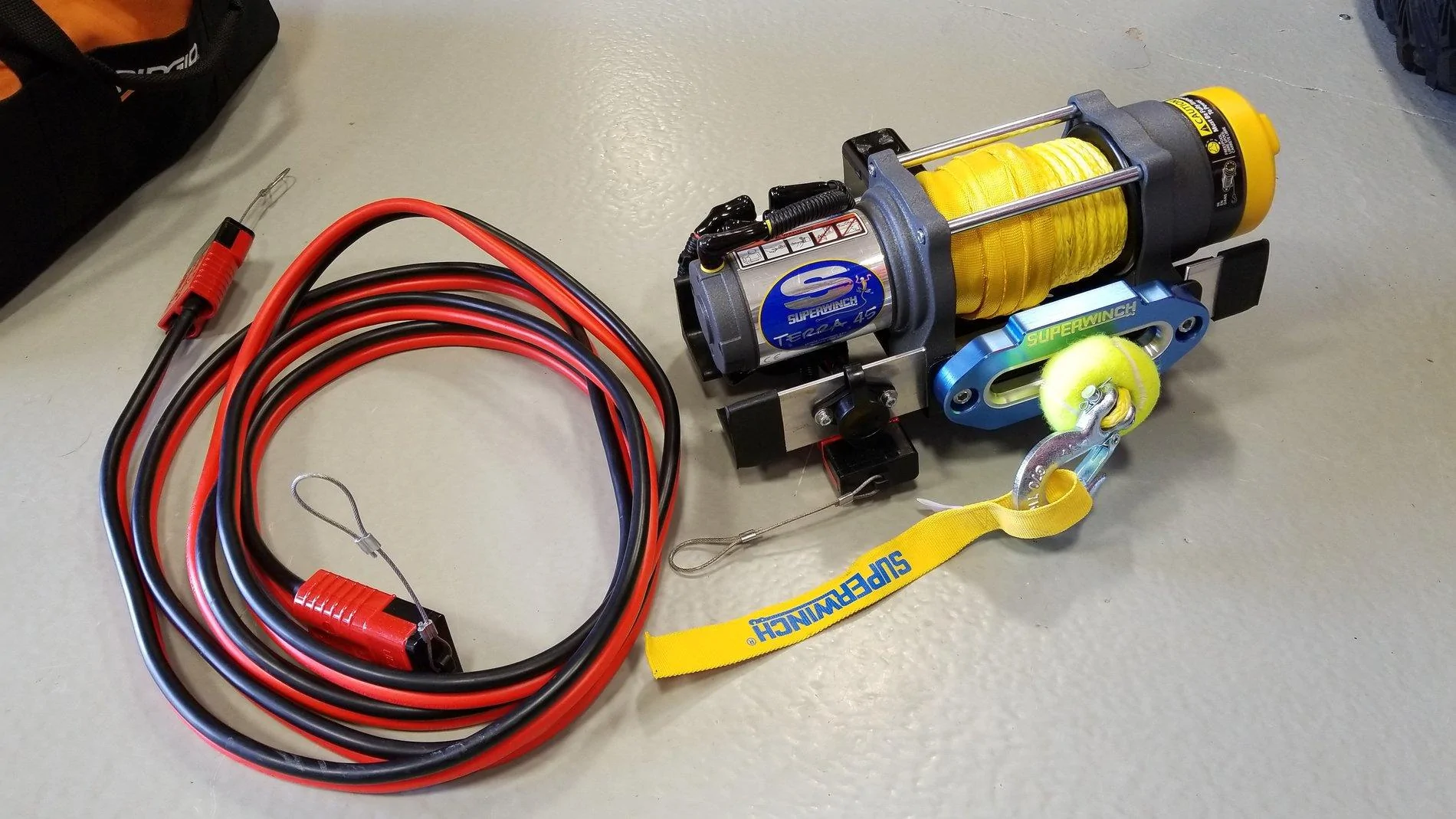

Installed high amp quick connect onto batteries for using spare 4500 lb winch. This is what I used in my RZR days so I figured I might as well make use of it. I can use it to pill me out backwards or if main one breaks down.
The battery accessory terminals started galling after cycling the nuts ~10 times. This is common with stainless on stainless. Bought new ones with 3/8" posts that are taller. Now I spray a little lithium lubricant on them before cycling nut.

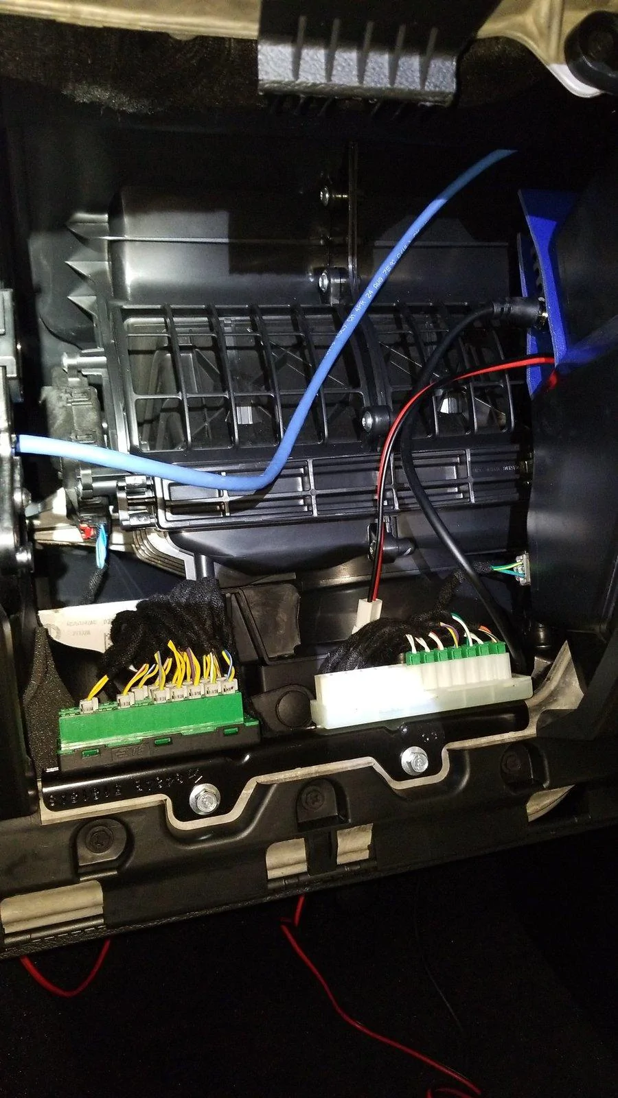

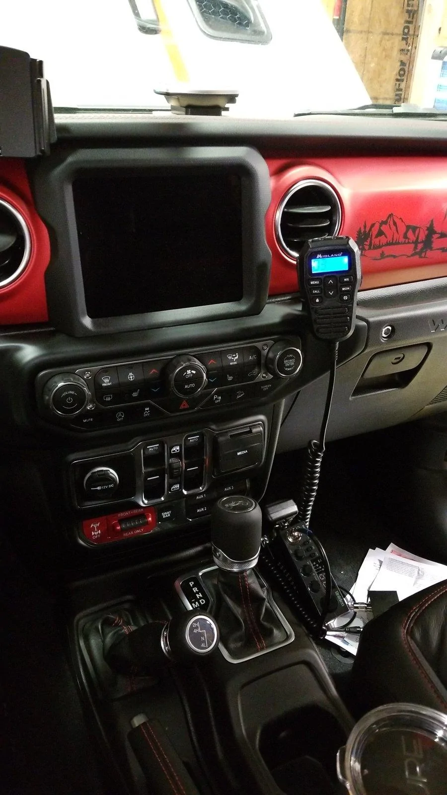

Installed Midland MXT275 GMRS radio. Being OCD I really wanted to screw the mount into a solid surface under dash or behind glove box. There really isn't anything. I finally found a good spot behind passenger speaker. I put a piece of foam around it to keep it from vibrating. It fit perfect! Read through manual. Pretty straight forward. I moved CB mic down to the holder on CB base unit and I'll leave GMRS mic up high. Also I used an ethernet coupler and short extension so I didn't eat up my coiled cord on mic.
Finished electrical!! The Gods have shown me mercy. Aux switch bar is busy..... Also not fun reaching under there and trying to grab 4 ring terminals with a short screw and line it up with screw hole.

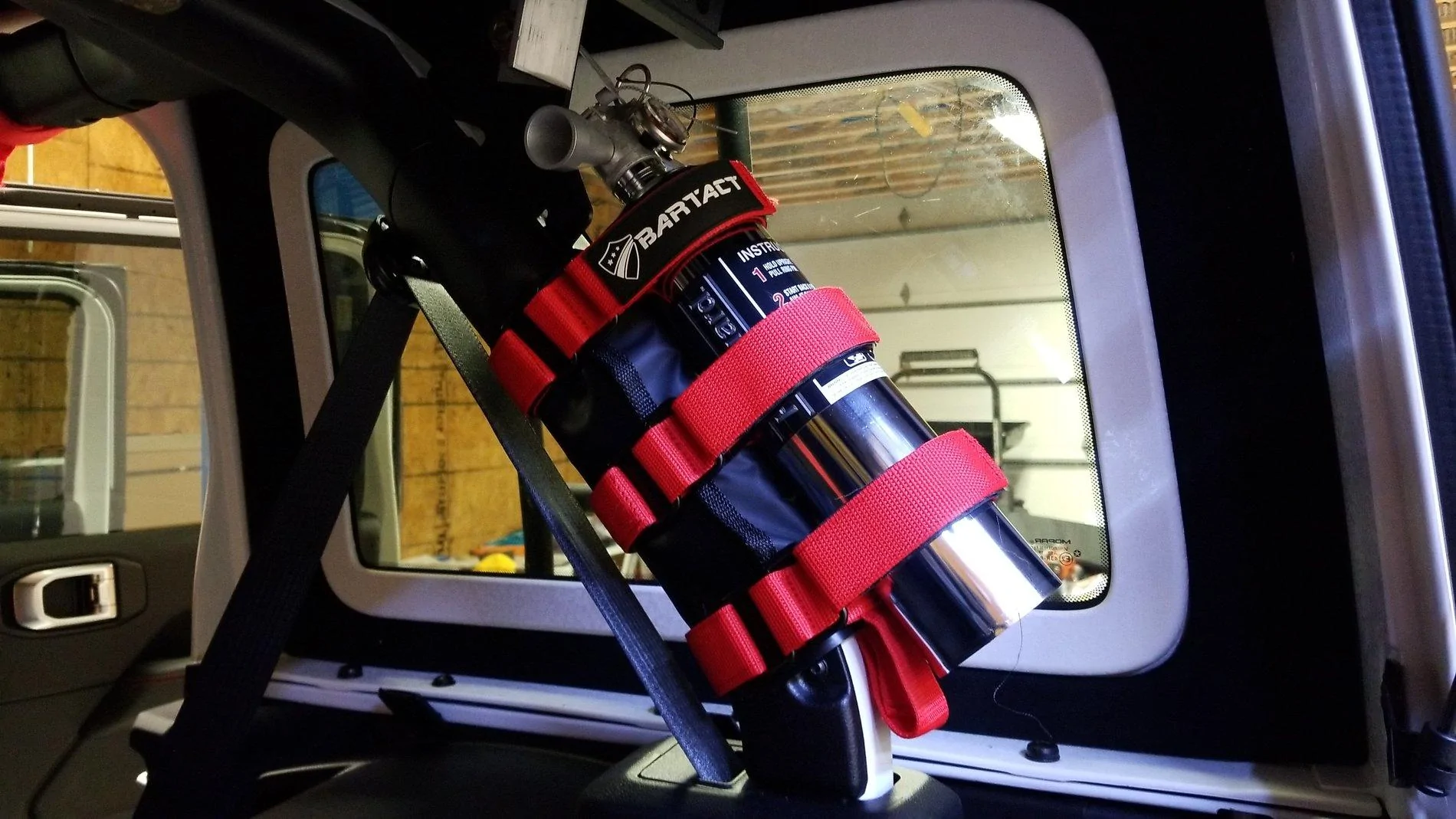

Had to throw away fire extinguisher mount after it tore pulling on one of straps. Purchased Bartact mount.

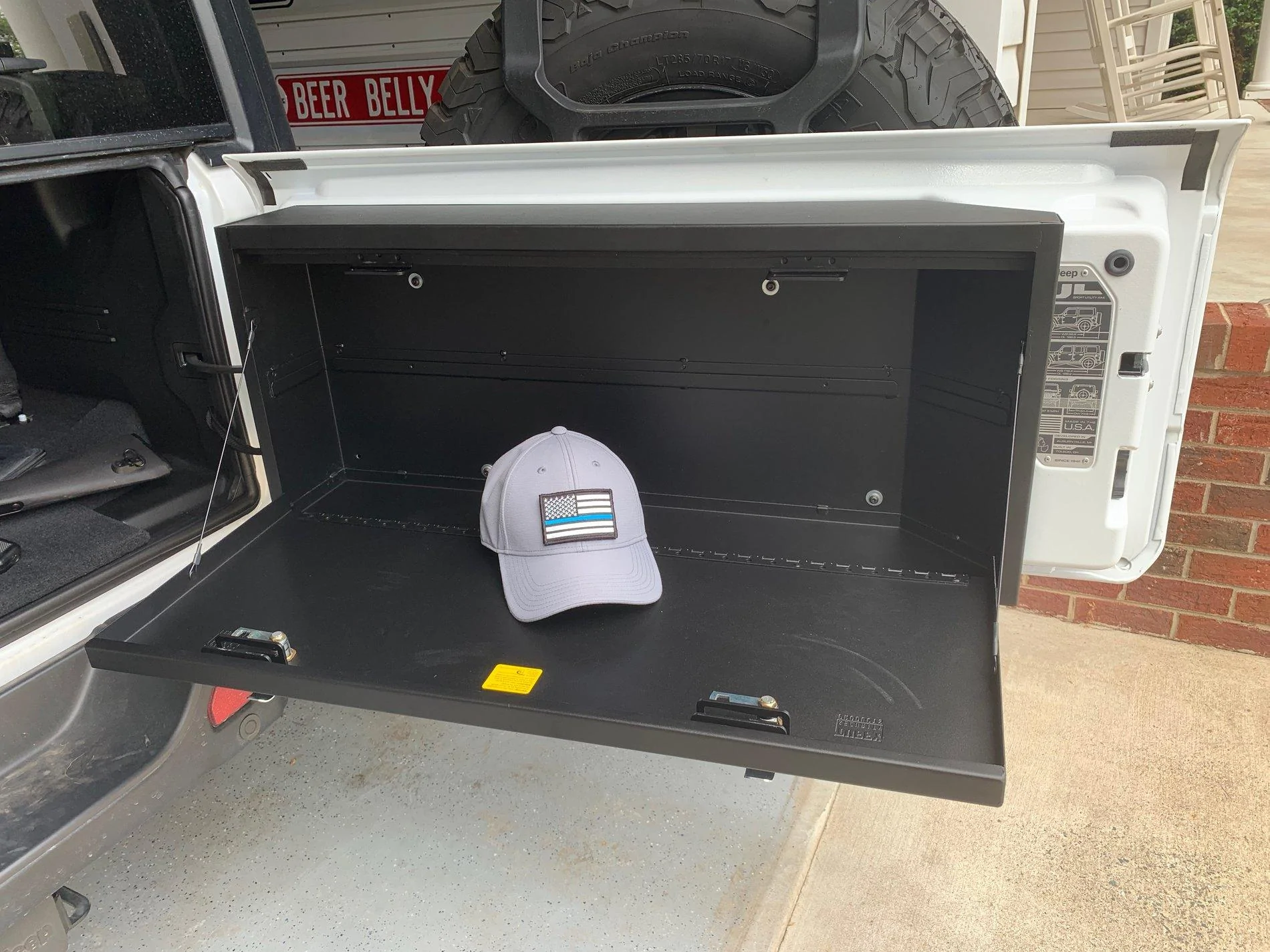

Installed Tuffy Security Tailgate...Installation instructions kinda suck but I was also a dumbass...Took about 45 minutes because I didn't drill pilot holes...I know better!!!!
Easy 10 minute job for 2 people with good instructions (DRILL PILOT HOLES).
Solid Unit but seam gaps could be better and powder coat is jankie in a few spots (But I'm picky).
Overall very happy and would buy again.
Door rattles like F....Spent the day lining everything with sticky back velcro strips.
Still glad I purchased but come on Tuffy, $299 and it still needs major modifications to stop rattles :headbang:
REALLY need to tighten up the build quality and tolerances :facepalm:
